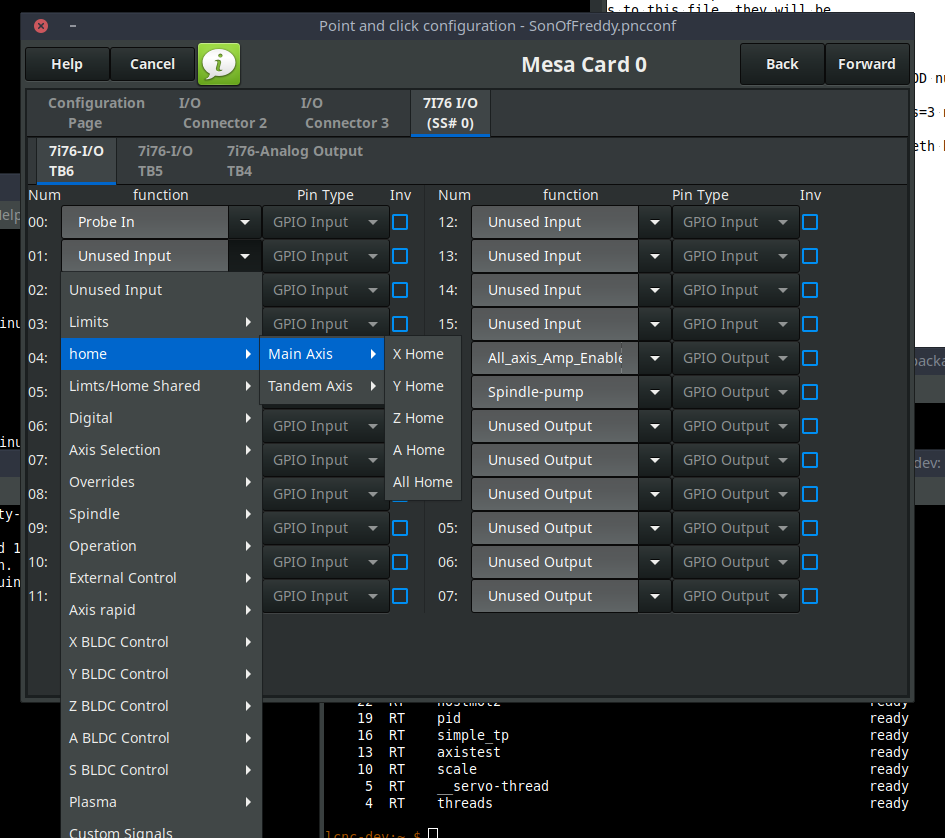

I'm sure I'll hate myself when I learn what I've missed, but...
As part of my update from 2.7 to 2.8 I decided to start from scratch with pncconf. I found an old version of original pncconf files and have been crosschecking the output against the .ini and .hal hand-edited files I've been using these past years. So far the ini and hal make sense, but the home search sequence stuff is missing from the ini. I'm running ClearPath S&D servos with self-homing, so I set a search sequence of 1 with velocity 0 on all axis so I can use "home all".
In pncconf, I can set the search sequence, but I note that the velocity and latch velocity are greyed-out and cannot be changed. They're non-zero so I don't care - I'll edit them in the ini later anyway, but there are no entries in the .ini. Of course I can put them in, but I'm trying to get as far as possible with pnccong before I start the hand edits. Seems like I'm missing something.

You don't seem to have any home switches defined.

Thanks for the reply.
I buy that, but where in pncconf did I miss setting them? In the Mesa iO config?

Replied by phillc54 on topic PNCCONF doesn't set HOME_SEARCH_VEL, etc. in .ini
The following user(s) said Thank You: dokwine

Yup, there it was. Hadn’t done this before as I don’t really have home switches. Must’ve put them in manually before.
Thanks so much!
