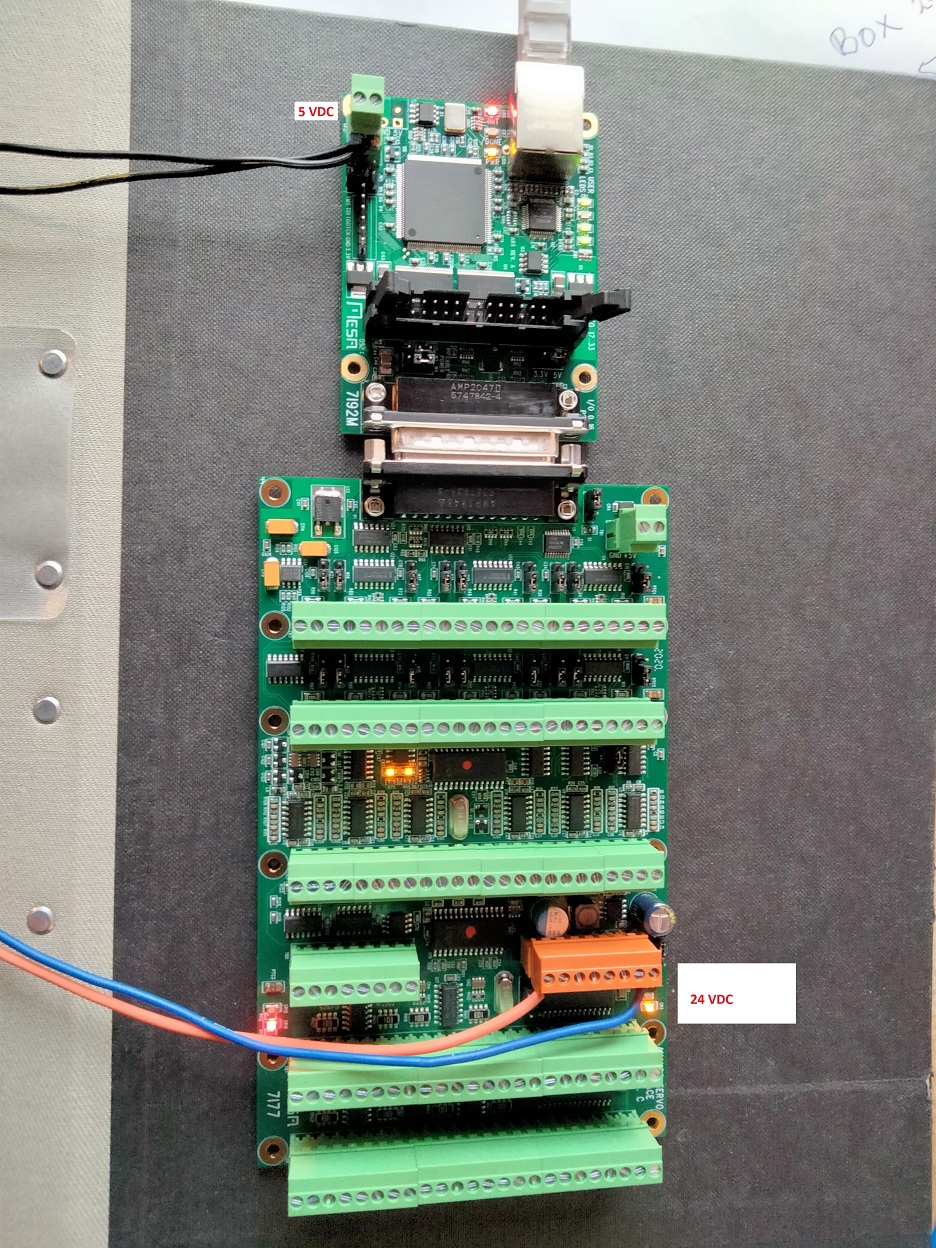

Hi!I give up. I can't get my config with 7i92 and 7i77 to be accepted.Spent the hole day with different hal parameters but no luck..Does anybody have an idea what I'm missing?Attached hal, ini, error report and wiring picture./Pär

Do you have 7I77 firmware in the 7I92M?Hi!I give up. I can't get my config with 7i92 and 7i77 to be accepted.Spent the hole day with different hal parameters but no luck..Does anybody have an idea what I'm missing?Attached hal, ini, error report and wiring picture./Pär

Completely missed that..will try and update that and hopefully that will get me closer to a working setup.
