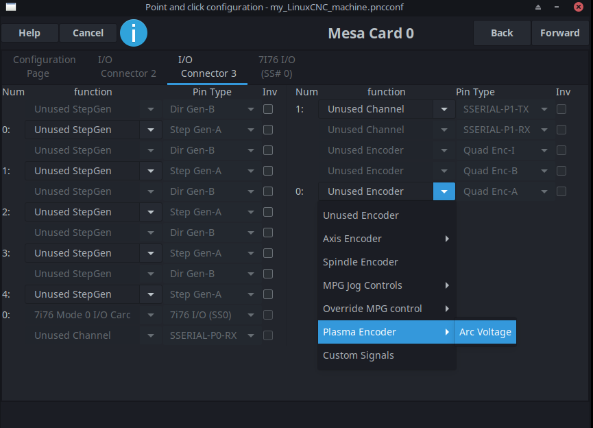

Hi everyone.
I have debian 10 and linuxcnc 2.9 I want to run pncconf in the Qt version to configure Qtplasmac but when I run the pncconf command in the terminal the old wizard opens and not the qtplasmac one, someone could help me

19 Nov 2021 15:48 #226992
by paulsao
Replied by paulsao on topic Pncconf qtplasmac
Where do the thcad configuration windows appear as the frequency? , because I finished the configuration

19 Nov 2021 16:57 #227000
by paulsao
I made a new configuration with pncconf to correct the problem I have about the ohmic test that when I press it, the z axis does not move but everything remains the same. Maybe I am missing something if you were so kind to help me please.
