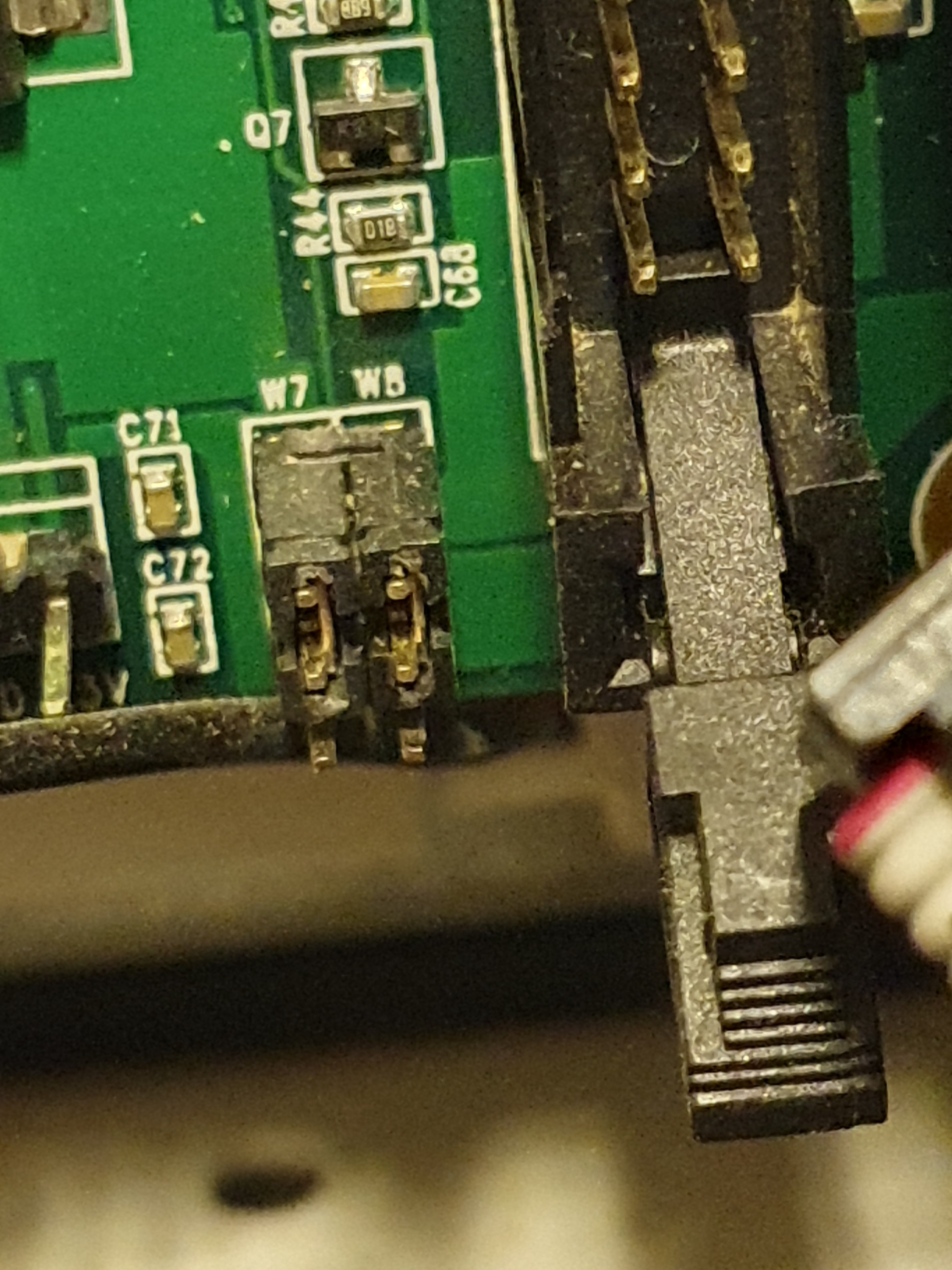

Something really strange is going on.i have a PS for 5 V that powers the raspberry pi and the mesa card and I have a PS for 12V that I have connected to the BOB to. when I connect the cable between the mesa and the BOB there is something that starts beeping and the 5V PS only gives out 1V and the Pi dont start of cause. What can cause this?

It sounds like you have the 7I96 set to supply 5V power via P1 (W8 UP)
This will short out the 5V supply if you do this with normal parallel port
breakouts

Ok. I have not applyed your fw patch yet. Do i need to do that first ? Or is it a physical pin?

This?

Yes (page 3 in 7I96 manual)

Great that worked.
