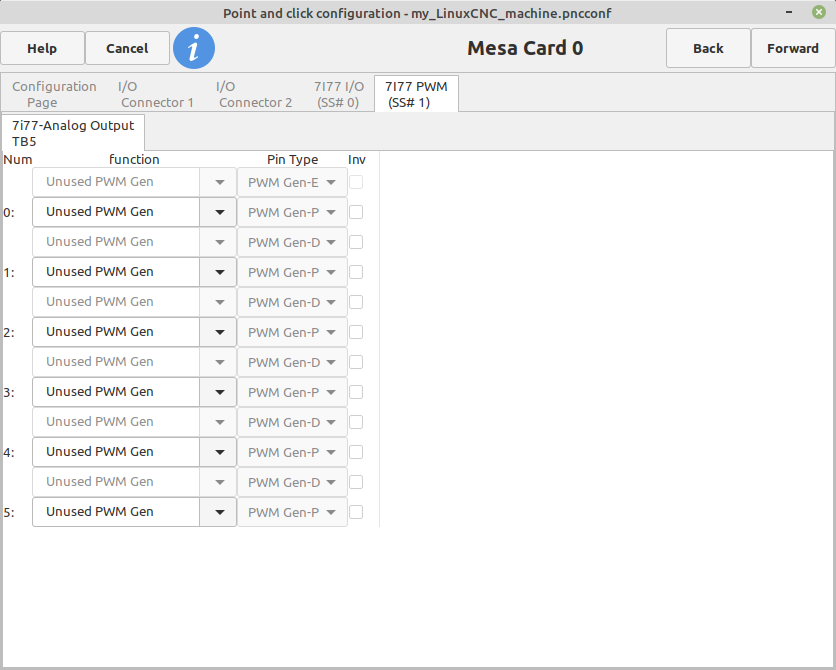

Hello everyone, let me tell you that I am a beginner in linuxcnc.
I am working on a machining center retrofiting.
it has a whole setup of analog servodriver ..
I have two MESA 7i92m and 7i77 ..

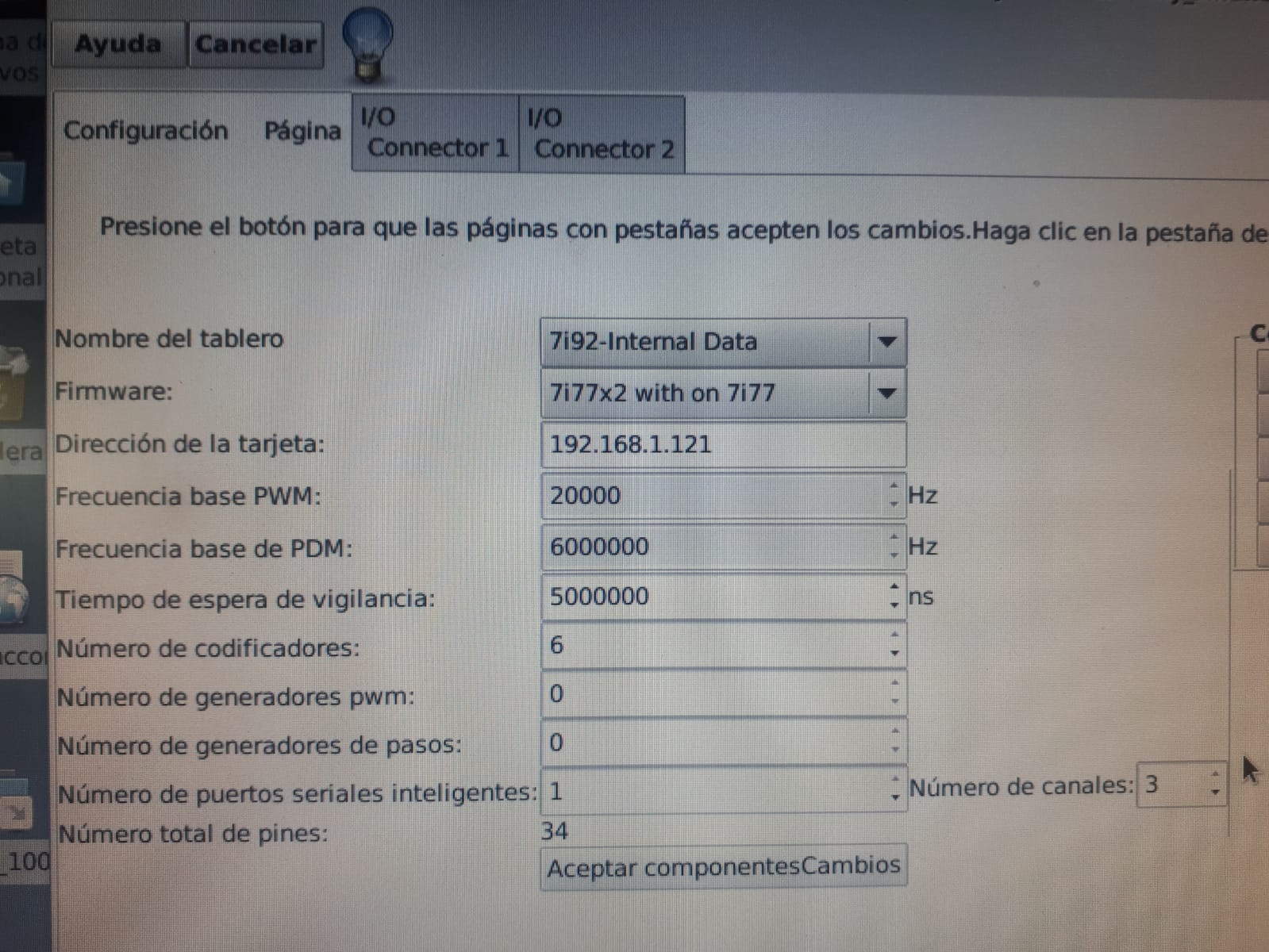

The problem is the following, I start the configuration of pnc conf, load data and advance to table card 0.
board name ... 7i92-internal date
firmware ... 7i77_7i76
Now I do not see options to enable the signals + -10volt in any connector.
I have no idea how to enable these signals
I really appreciate the help!!

I think those are named PWM in PncConf.

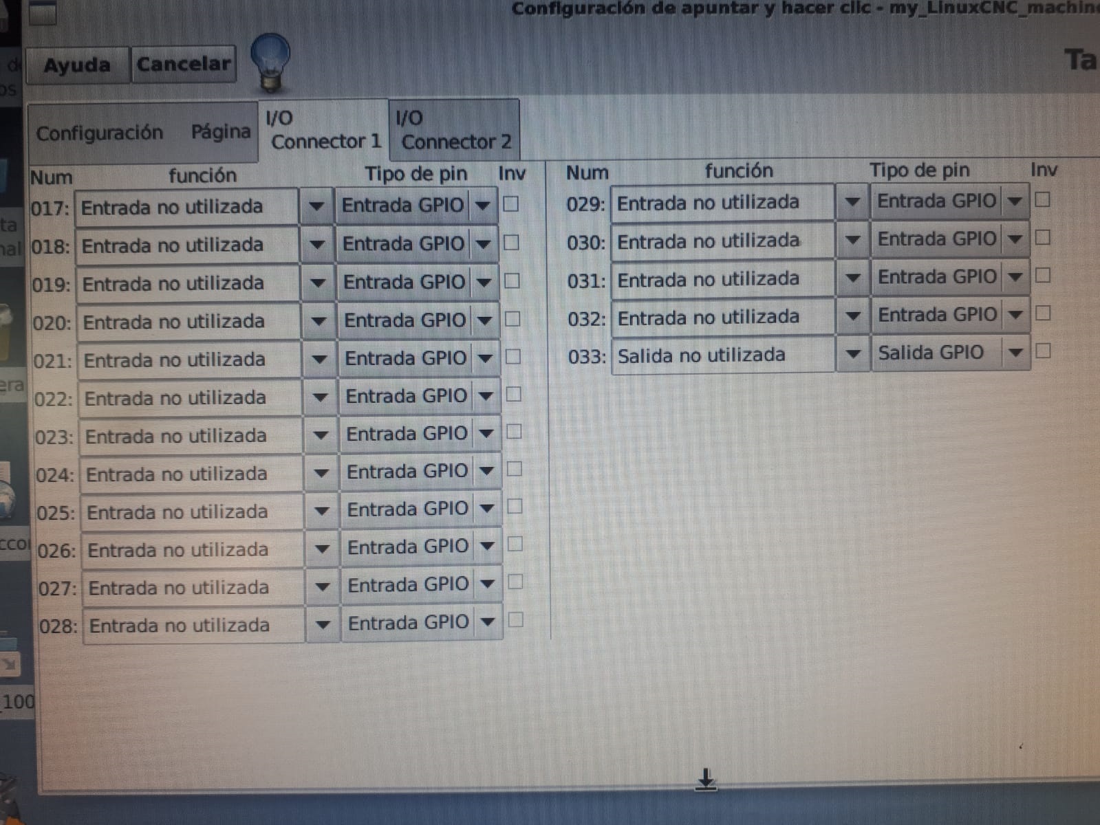

hi tommylight..
pulse width modulation (pwm) does not appear that option either.
or something_ analog signal
Maybe it is something from the 7i92 / 7i77 set, they are not correct?

I think I have seen this error before and its language related.
You may have to temporarily set the locale to English to get pncconf
to display all tabs

You can set it from the command line
google "set locale linux"
