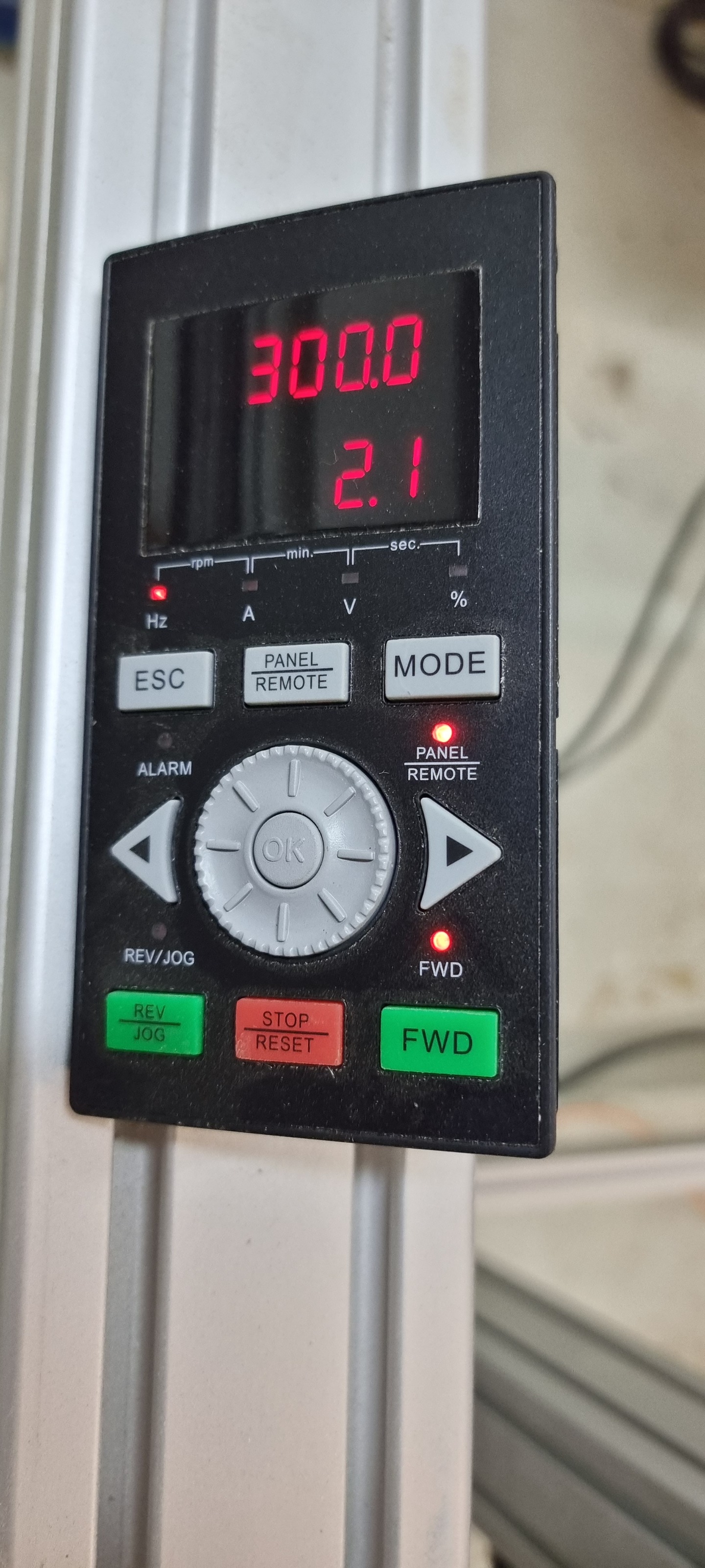

Does the VFD have a screen with a keypad?
Most of those will require setting them to "remote" control from that panel.

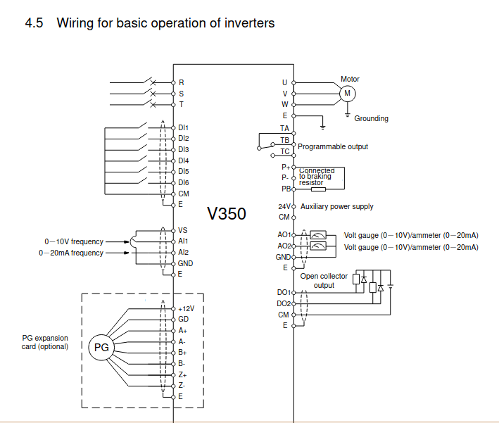

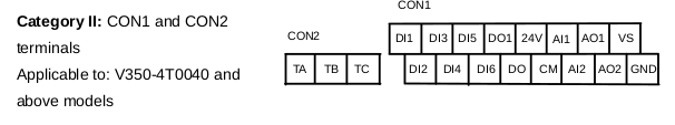

I haven't plowed through the whole manual so I'm not sure if the Digital Inputs can be set to either sourcing or sinking but to me it looks like you need to connect the digital inputs to 'CM' not +24V.
Replied by Aciera on topic 7i76e analog spindle doesn't start
5 SPINDLE ENA- ==> DI1 / setting no 7: - Forward (FWD) running command terminal
6 SPINDLE ENA+ ==> +24V from vfd
7 SPINDLE DIR- ==> DI2 / setting no 8: - Reverse (REV)running command terminal
8 SPINDLE DIR+ ==> +24V from vfd

Connected from 24+ to CM in VFD and spindle now runs. Hurray!
