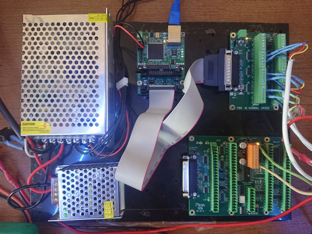

A Novice at Mesa & LinuxCNC my basic goal is to Add a Mesa Card 7i92 / 7i76 / 7i88 that is not in the PNCConf / Configuration Tool Menu systems. How to Administrate these Firmware indexes in order to declare Mesa Card Configurations that are not available in the PNCConf & Configuration Tools.
Firmware Indexes Required:
1. Syntax of Indexes in FPGA Firmware
Mesa Provided Bit & Pin Files.
Mesaflash & 7i92 Configuration Tool
2. Syntax of Indexes in LinuxCNC:
HAL & INI / PNCConf / Configuration Tool
3. Syntax of Indexes in Xillinix ISE:
Compiling custom Bit & Pin Files
How do we declare the card configuration that is not provided with the Firmware?
7i92 / 7i76 / 7i88
is not in PNCConf or Configuration Tool Selection.
is not in the list of Mesa Bit or Pin Files
Syntax Convention: hm2_7i92.0.stepgen.05.enable
LinuxCNC is "Sending" that command to the FPGA 7i92 Onboard BIT File.
7i92 receives a command with NO DECLARATION of the Daughter Card (7i76 or 7i88) in the Command.
How does 7i92 know to send that command to 7i76 or 7i88?
Is the 7i76 / 7i88 declared as a StepGen embedded in the Bit File?
Review of seveni92.xise doesn't immediatley reveal declarations of the 7i76 or 7i88 in Pin####.VHD or IDROMConst.vhd
Review of HAL & INI doesn't reveal declarations of 7i76 / 7i88. How do we "Hand Edit" the Hal or Ini File to address the 7i88?
Syntax Convention: hm2_7i92.0.7i76.0.0.input-00
Well here the 7i76 is declared in the command.
Did LinuxCNC / HAL / INI / PNCConf declare that command?
Or did the BIT File on the FPGA declare that command?
Theory:
Declare 7i92 / 7i76 / 7i88 in LinuxCNC Index somehow somewhere
Compile a Bit File 7i92 7i76 7i88 in seveni92.xise
Flash, Send & Turn Motors.
My question in any of these Firmware Index Syntaxes, Where & how do we Declare the Daughter Card? 7i88? I am trying to "Get" the "Basic Swing of Things" with the Logical Syntax Index and someday hope to attain the "Anything Syntax" level of education where it will be nice and text editor logical to declare all that stuff....

The 7i92 needs firmware uploaded to support the 7i76/7i88 hardware (it may come with it if you ordered it all together)
Pncconf needs to support the 7i92, 7i76 and 7i88 to completely configure it.
Unfortunately Pncconf does not currently support the 7i88
You could use Pncconf to partially configure a system by using a similar firmware such as 7i76x2 or 7i76x2 with one 7i76.
Then you would need to hand edit the HAL files to configure the 7i88.
There is also a 'discovery' option in Pncconf that tries to directly read the cards on the system but in this case I don't think it would help you with the 7i88.

You can call me Eddy & I can call you HAL....
Declare the 7i88 from a 7i76x2 HAL & INI File.
P1 = 7i88
P2 = 7i76
PNCConf Declaration in HAL for 7i76x2:
loadrt [KINS]KINEMATICS
loadrt [EMCMOT]EMCMOT servo_period_nsec=[EMCMOT]SERVO_PERIOD num_joints=[KINS]JOINTS
loadrt hostmot2
loadrt hm2_eth board_ip="192.168.1.121" config=" num_encoders=2 num_pwmgens=0 num_stepgens=10 sserial_port_0=0000xx"
setp hm2_7i92.0.watchdog.timeout_ns 5000000
loadrt pid names=pid.x,pid.y,pid.z,pid.z2,pid.s
addf hm2_7i92.0.read servo-thread
addf pid.y.do-pid-calcs servo-thread
addf pid.z2.do-pid-calcs servo-thread
addf pid.s.do-pid-calcs servo-thread
addf hm2_7i92.0.write servo-thread
setp hm2_7i92.0.dpll.01.timer-us -50
setp hm2_7i92.0.stepgen.timer-number 1
# external output signals
# external input signals
# Step Gen signals/setup
setp hm2_7i92.0.stepgen.00.dirsetup
The PNCConf 7i76x2 Syntax does not format 7i76, it does format 0 or 1 which declares P1 or P2.
setp hm2_7i92.0.
setp hm2_7i92.1.
Although P1 is lesser than P2, P2 appears to be referenced by 0 which is lesser than 1.
P1 = 1
P2 = 0
LinuxCNC is "Sending" only that
without any reference to a Daughter Board
with reference to the P1 or P2 Address as 0 or 1.
The Daughter Boards are declared elsewhere? I am missing that declaration, I cannot find it...
The Presumed Logical Declaration would be something like this...
setp hm2_7i92.0.7i76.0.0.stepgen.00.dirsetup
setp hm2_7i92.1.7i88.0.0.stepgen.01.dirsetup
Are there 2x Indexes for declaring a Daughter Board?
1. Declare in PNCConf
"There is no declaration in HAL for the daughter board,it's abstracted into a object oriented reference elsewhere".
2. Declare in BIT File:
Declare same in Hostmot2 BIT with Xillinix ISE.
Or is the 7i88 referenced only as a 0 or 1 Address? Is the 0 or 1 the only required syntax for declaring a 7i88 in HAL ? The BIT File then routes the commands to 0 or 1 & knows it's a 7i88 with PIN? That is the 7i88 declaration for HAL? A 0 or 1 only? without any 7i88 string?
If 7i88 = P1 then
setp hm2_7i92.1.
If 7i88 = P2 then
setp hm2_7i92.0.
Would you please reference the Syntax that I could add to HAL & INI in order to configure the 7i88?

Contains a bit file for a 7I92+7I76+7I88:
P2 --> 7I76 (stepgens 0..4 + other 7I76 I/O)
P1 --> 7I88 (stepgens 5..9 + 1 PWM)
Replied by PCW on topic 7i92 7i76 7i88 Hostmot2 Basic Orientation, Syntax & Assignment

Replied by garrettmin on topic 7i92 7i76 7i88 Hostmot2 Basic Orientation, Syntax & Assignment
OK it's flashed & I opened the VHD in Xillinix ISE.
How do I configure PNCConf & hand edit for 7i92 / 7i76 / 7i88 ?
While Editing HAL & INI, there is no reference in the syntax to a daughter board 7i76 or 7i88.
Is the 7i88 only declared by the Numbered Address of the StepGen Declaration?
In this example, "05" or "06" is reffering to the 7i88?
hm2_7i92.0.stepgen.05.dirsetup
hm2_7i92.0.stepgen.06.step_type
Last edit: 03 Apr 2022 00:47 by garrettmin.
- Posts: 17919
- Thank you received: 5247
03 Apr 2022 00:43 #239119
Note: if you only damaged the field I/O section of the 7I76,
stepgen 0..4 should still work on the 7I76
Yes, as I said, stepgens 5 through 9 are on the 7I88In this example, "05" or "06" is reffering to the 7i88?

New to Mesa, I didn't know to use LED for testing & diagnostic! Wow what a difference! Now I can see what is going on!
7i92 was in fact turning the motors or lighting LED with OEM HAL.
Evidently the Drivers or wiring are the reason the motors are not turning.
The Boards are responding Verified with LED...After shorting polarity on 24V TB1
Inputs / Outputs are now failed?
./7i76-7i88.hal:428: parameter or pin 'hm2_7i92.0.7i76.0.0.spinout-minlim' not found
./7i76-7i88.hal:32: Pin 'hm2_7i92.0.7i76.0.0.input-00' does not exist
./7i76-7i88.hal:32: Pin 'hm2_7i92.0.7i76.0.0.input-15' does not exist
./7i76-7i88.hal:32: Pin 'hm2_7i92.0.7i76.0.0.output-07' does not exist
21777
I installed a LED between TB1 & TB6 #1 with no result to test I/O.
21777
