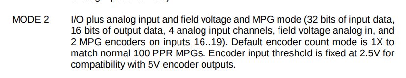

What Andy said + Do you have 5i25_7i77_7i76.bit firmware installed?
Also you might consider using the MPG encoders on the 7I76 as these
support the 1x mode used with standard 100 PPR MPGs to get 1 count
per detent.
per detent.

AS Peter said, use the MPG encoders on the 7i76 instead of a 7i77 encoder input

Either use an MPG encoder or try this in the HAL file:Use Chinese MPG with 100 PPR. In halshow one tick of MPG = 4!?!? It mast be 1 .....
setp hm2_5i25.0.encoder.06.counter-mode 1
