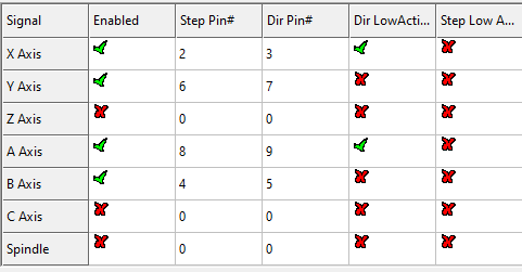

This is what I need to replicate. I cannot see a way to force the stepgen to connect to the correct pins. Stepgen 4 is on port one and stepgen 8 is on port 2. That seems incorrect to start with.

Wrong firmware, use the G540 firmware as it is has the pinout you need.

12 Apr 2022 10:46 #240058
Replied by PCW on topic 7i92 config seems scrabled
5ABOB is correct G540 will work also but is specifically pinned for the
G540s charge so not so flexible.

12 Apr 2022 10:59 #240060
Mapping to match your chart should be:
Stepgen Axis
0 X
1 B
2 Y
3 A
num_stepgens should be <7 to disable stepgen 8 if you want pins
16,17 free for use as general purpose outputs
Stepgen Axis
0 X
1 B
2 Y
3 A

Replied by mariusl on topic 7i92 config seems scrabled
Peter
I tried to map it like that but one has to include the Z axis in the config or PnCConf will not continue. So I am trying to map the Z axis to the last available stepgen. PnCConf gives me this config. Notice that stepgen 4 is now on the other port instead of on pins 16 and 17 on port 2 and it mapped the A axis to that.
I attached the INI and HAL files.
EDIT: The allocation of stepgens to pins as reported below is not correct at all.
stepgen 0 is X
stepgen 1 is nothing
stepgen 2 is A axis - was assigned to Y axis
stepgen 3 is Z axis - was assigned to A axis

hm2/hm2_7i92.0: IO Pin 011 (P2-08): StepGen #3, pin Step (Output)
hm2/hm2_7i92.0: IO Pin 012 (P2-09): StepGen #3, pin Direction (Output)
hm2/hm2_7i92.0: IO Pin 013 (P2-10): IOPort
hm2/hm2_7i92.0: IO Pin 014 (P2-11): IOPort
hm2/hm2_7i92.0: IO Pin 015 (P2-12): IOPort
hm2/hm2_7i92.0: IO Pin 016 (P2-13): IOPort
hm2/hm2_7i92.0: IO Pin 017 (P1-01): IOPort
hm2/hm2_7i92.0: IO Pin 018 (P1-14): IOPort
hm2/hm2_7i92.0: IO Pin 019 (P1-02): StepGen #4, pin Step (Output)
hm2/hm2_7i92.0: IO Pin 020 (P1-15): IOPort
hm2/hm2_7i92.0: IO Pin 021 (P1-03): StepGen #4, pin Direction (Output)
hm2/hm2_7i92.0: IO Pin 022 (P1-16): IOPort
hm2/hm2_7i92.0: IO Pin 023 (P1-04): IOPort
hm2/hm2_7i92.0: IO Pin 024 (P1-17): IOPort
hm2/hm2_7i92.0: IO Pin 025 (P1-05): IOPort
hm2/hm2_7i92.0: IO Pin 026 (P1-06): IOPort
hm2/hm2_7i92.0: IO Pin 027 (P1-07): IOPort
hm2/hm2_7i92.0: IO Pin 028 (P1-08): IOPort
hm2/hm2_7i92.0: IO Pin 029 (P1-09): IOPort
hm2/hm2_7i92.0: IO Pin 030 (P1-10): IOPort
hm2/hm2_7i92.0: IO Pin 031 (P1-11): IOPort
hm2/hm2_7i92.0: IO Pin 032 (P1-12): IOPort
hm2/hm2_7i92.0: IO Pin 033 (P1-13): IOPort
Since pncconf does not support your somewhat odd (XYAB)machine layout
You will have to edit the hal/ini files yourself to get the desired joint/axis mapping
pncconf will map XYZA (and tandem axis) to the proper stepgens but does not support XYAB

I think there is a misunderstanding. The B axis is the slave to X axis. The kinematics are normal three axis plus one rotary and a slave to X axis.
I need to assign the axis to specific pins on the parport. This seems to be problematic or I am just not up to the task.
