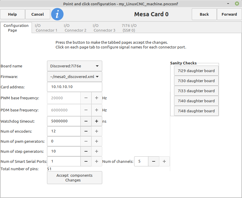

INI file did the trick. At least just 1 spot to change.
I think when I did the discover I entered "7i76e-16", let me try it again.

Ah,
Is this a result of flashing 7i76e_7i76x1pD.bit?[/code][/code]
[code]greg@cutty:~/linuxcnc/configs/shapeoko$ mesaflash --device 7I76E-16 --addr 10.10.10.10 --readhmid
[code]ETH device 7I76E-16 at ip=10.10.10.10
7I76E-16
Configuration Name: HOSTMOT2
BoardName : MESA7I76
pncconf probably picked the board name up from there?
Last edit: 11 May 2022 01:37 by koopa.

11 May 2022 02:29 #242555
Replied by PCW on topic 7i76e with PWM, 4 step gen AND TB5 and TB6
No, on Ethernet cards the name is not the FPGA/HM2 name (MESA7I76)
Did you try "7I76E" with the discovery option? it works for me

Replied by koopa on topic 7i76e with PWM, 4 step gen AND TB5 and TB6
Running 2.8.2 iso
If I enter "7i76e" when asked, it will say "Boardname: discovered:7i76". I then have to enter the number of connectors, number of pins and interface type.
If it's working in 2.9, any point in opening an issue for 2.8.2 on GitHub?
- Posts: 18111
- Thank you received: 5330
11 May 2022 15:41 #242652
Yes, because updating to 2.9 is a major step because of all the Python2-3 changes
