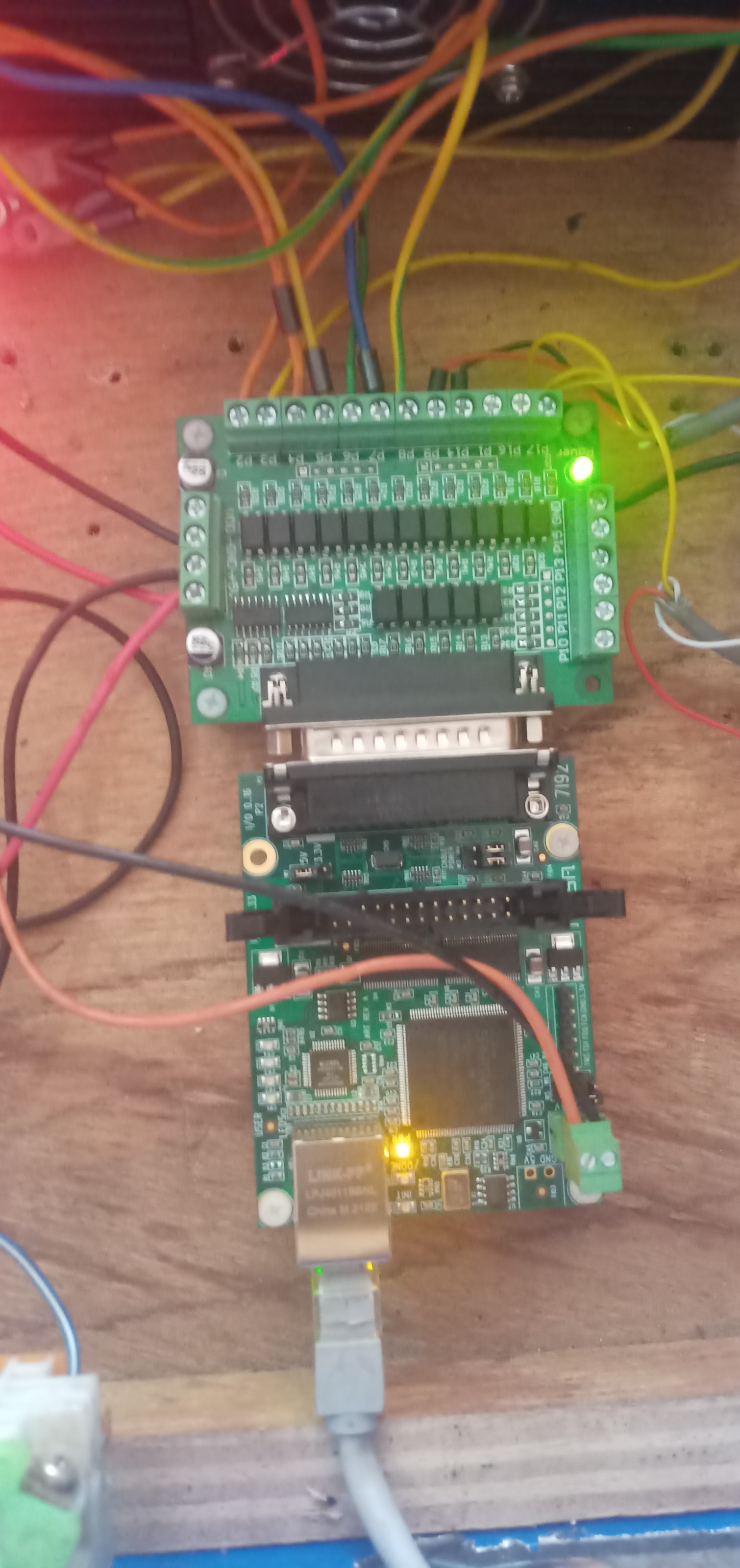

28 Apr 2022 03:58 #241446
Replied by tommylight on topic Mesa 7i92 board config with BOB
That BOB needs 2 power supplies, and the optos are slow.

Replied by aabtech on topic Mesa 7i92 board config with BOB
- phillc54
- Posts: 5711
- Thank you received: 2100
28 Apr 2022 05:08 #241452
by phillc54
Replied by phillc54 on topic Mesa 7i92 board config with BOB
Like Tommy said you need 2 supplies, I think you need a field supply between GND and VDD.

28 Apr 2022 09:19 #241488
Again, this also requires 2 power supplies.

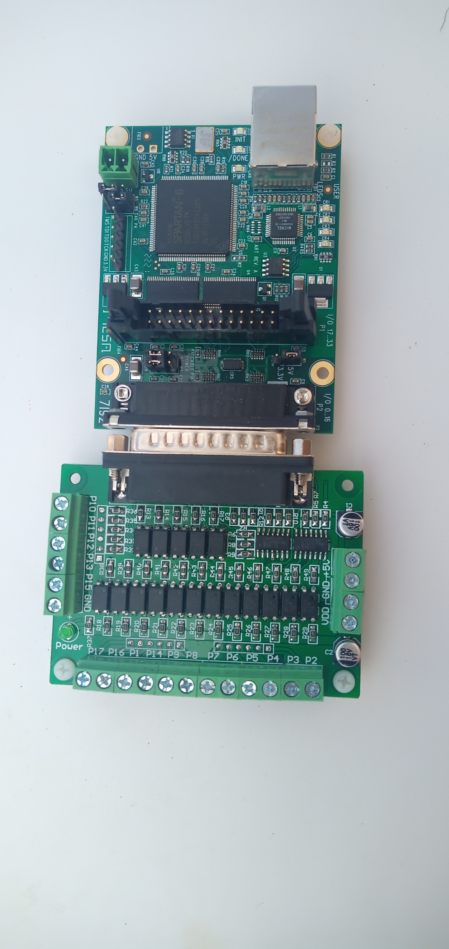

I have powered the board with two power
the Green LED is 12v and the Red LED is 5v and the 7i92 also have been powered with 5v.

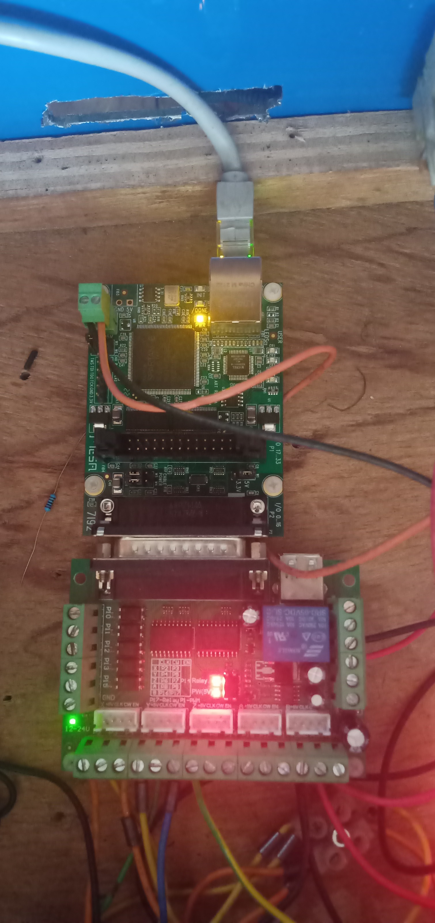

- Posts: 18120
- Thank you received: 5337
28 Apr 2022 11:26 #241513
Replied by PCW on topic Mesa 7i92 board config with BOB
How did you check the inputs?
I think the second bob inputs are activated by grounding them

28 Apr 2022 12:41 #241523
Both BOB seem to require short to ground.
Make a simple config using StepConf, just so you can start Axis GUI with it, then on the "machine" menu click on "show hal configuration", there on the left side click on "pins" then "parport",
On the right side click on the "show" tab,
On the left side click on the 10 in, 11 in, 12 in, 13 in, 15 in,
Now on the right side you can see the LED change color when you short an input to GND on the BOB.
