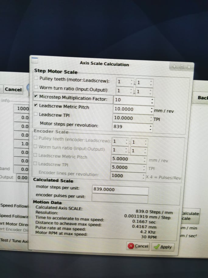

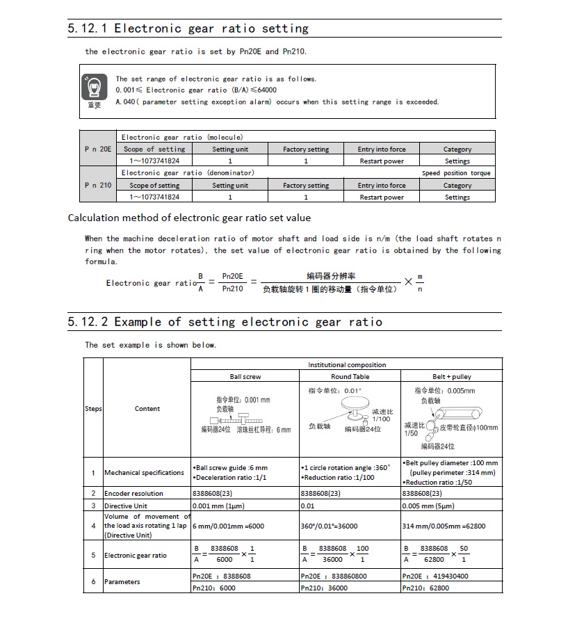

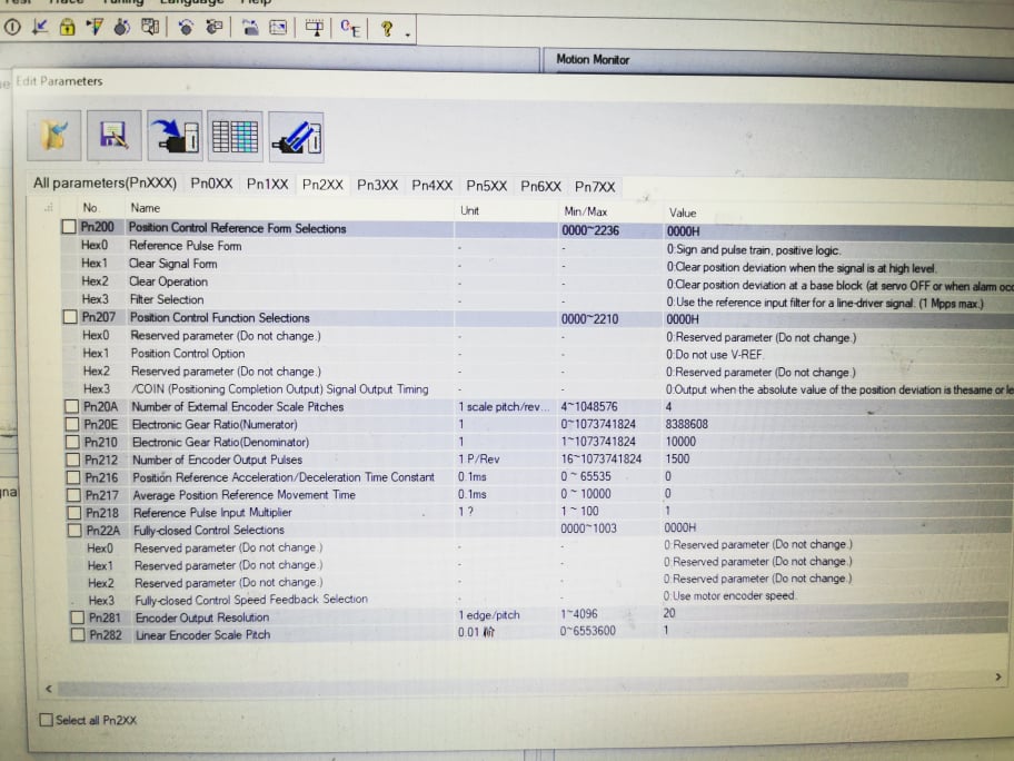

Hi
I am having trouble setting up the step scale in my mesa. I have a mesa set 5i25 + 7i76.
I have a 1.3kw servo motor with 23bit absolute encoder, but it is not connected to the mesa.
I set the gear in the servo according to the instructions, i.e. the parameter Pn20E: 8388608 (encoder resolution) and Pn210: 10000 (screw pitch 10 mm)
I do not know exactly what to enter in Linux for Motor steps per revolutions.
If I enter 8390 stepper then when I set 300 rpm speed, it actually gets 255 but one motor revolution is about 1mm, not 10mm. If I type 839 stepper scale, one turn is almost 10mm but the speed instead of 300 is 25. What am I doing wrong or how can I calculate it?
Will you be able to help me?

How are you measuring the motor speed?
Maybe the drive needs a scale of 1000 not 10000?

- Posts: 19908
- Thank you received: 4659
18 May 2022 04:38 #243258
Replied by andypugh on topic Steps per revolutions Servo HSD7
Does the screw definitely rotate at the same speed as the motor? No intermediate gearing or belts?
