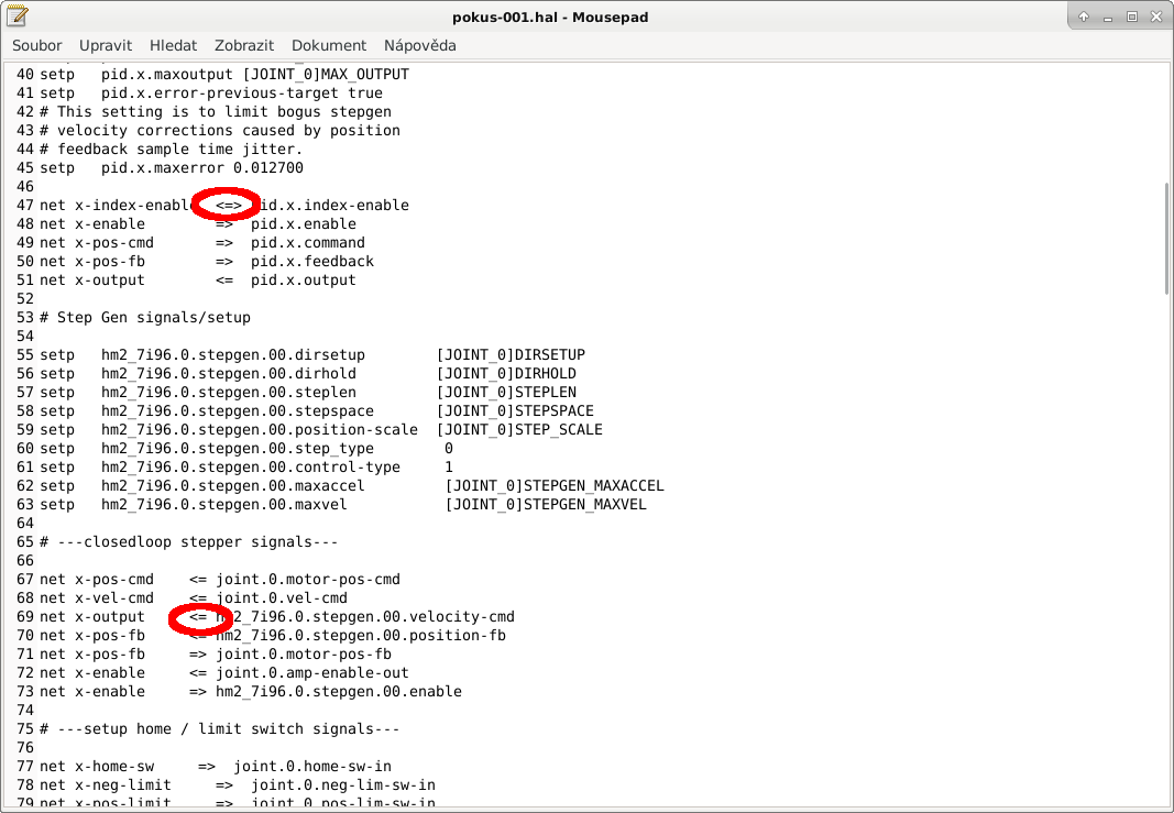

LinuxCNC 2.8 - PNCconf bug - bad arrow

Replied by PCW on topic LinuxCNC 2.8 - PNCconf bug - bad arrow
The first arrow is correct (index enable uses a bi-directional pins),
the second one is backwards.
Edit: No You are right PID index enable is an input pin
(motion and encoder index enable are bi-directional)
Note that the arrows don't actually do anything, they are just
there for readability

I made pull:
