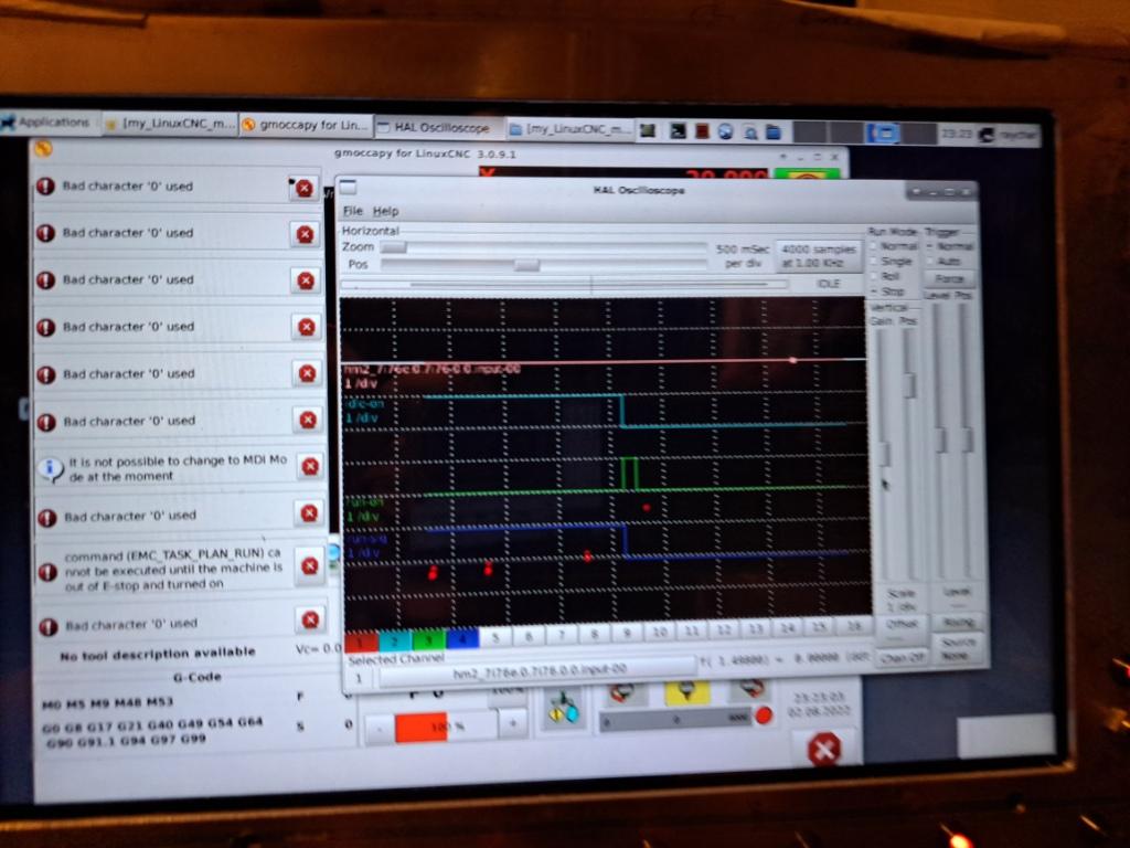

That is I haven't touch anything on the machine, the cycle start button will turn on (and its lamp lids) by itself, sometimes some axis will travel a short distance as well, so it is dangerous, even in some cases, the tool collide with workpiece and broke.

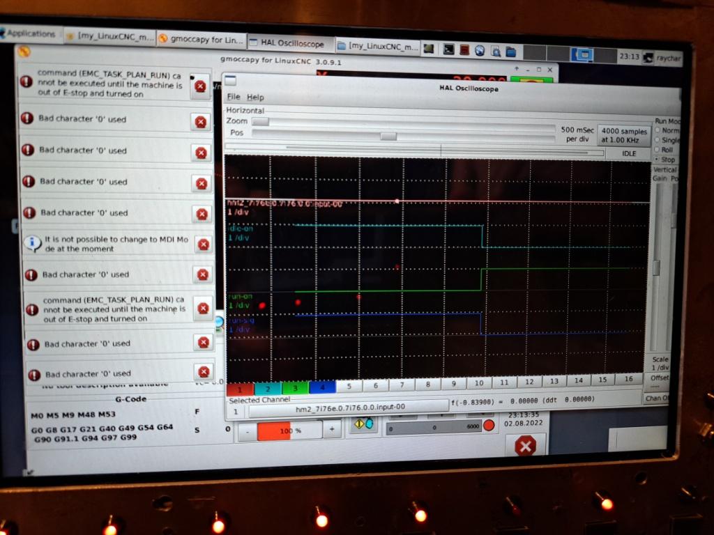

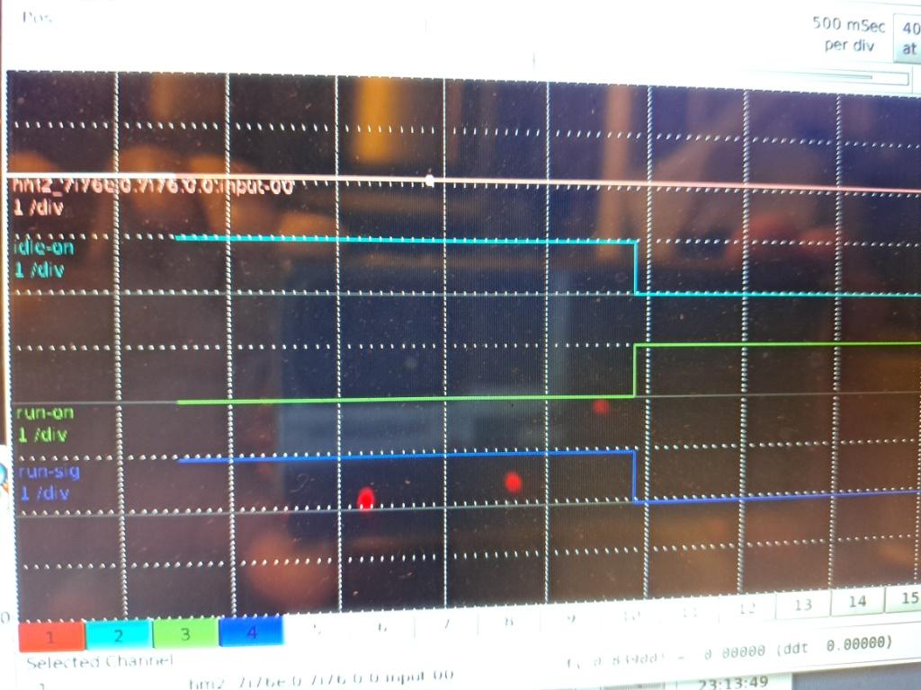

Here are three attachments for the hallscope captured 4 signals (start button input pin..input-00, idle-on, run-on and run-sig) when the machine starts itself:

So at a quick glance it looks like that this is unrelated to the 7I76E signals and just
an issue with the logic.
(you might check at a lower time per division to make sure you are not missing a
~1 servo cycle glitch)

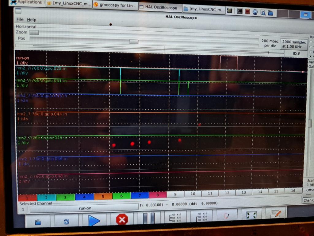

Here is an attachment for the photo of the probed 8 signal for :
run-on
hm2_7i76e.0.gpio.028.in
hm2_7i76e.0.gpio.031.in
hm2_7i76e.0.gpio.043.in
hm2_7i76e.0.gpio.044.in
hm2_7i76e.0.gpio.045.in
hm2_7i76e.0.gpio.046.in

It does look like the GPIO is detecting some noise.
I think that you need better electrical installation, but you can probably mask this with a debounce function in HAL.
It isn't 100% clear, but is something happening that should happen if a button is pressed, but without a button being pressed?
As PCW says, wiring direct to FPGA pins is rarely a good idea.
