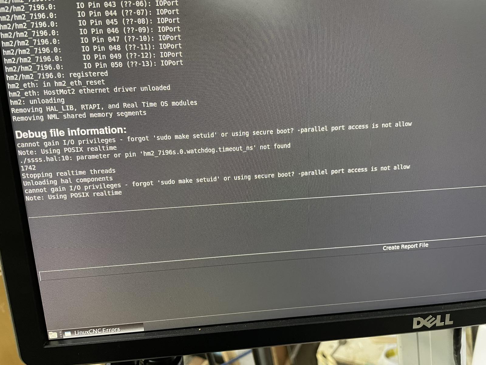

16 Sep 2022 18:45 #252098 by Masiwood123
7i96s why this, what next? was created by Masiwood123
16 Sep 2022 19:28 #252103 by PCW
Replied by PCW on topic 7i96s why this, what next?
The 7I96S requires LinuxCNC 2.9 (or the upcoming LinuxCNC2.8.4)
  • Masiwood123
  • Masiwood123's Avatar Topic Author
  • Offline
  • Platinum Member
  • Platinum Member

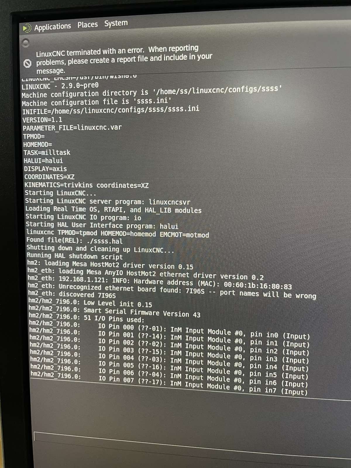

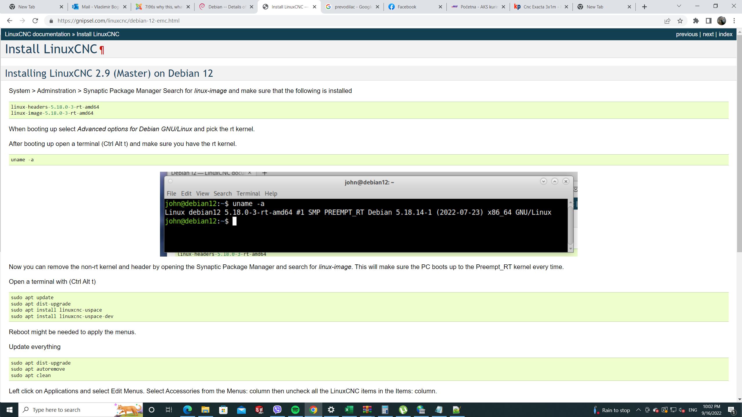

16 Sep 2022 19:34 #252105 by Masiwood123
Replied by Masiwood123 on topic 7i96s why this, what next?
I i have installed 2.9. according to the instructions of JT debian 11.4 and followed all the instructions, I also changed the name in the ini file to 7i96s.0 and made a couple of configurations in each of them there is this error..
16 Sep 2022 19:47 #252108 by PCW
You must have an old version of LinuxCNC 2.9 (April 2022 or earlier),
that is, before the 7I96S was added.
  • Masiwood123
  • Offline
  • Platinum Member
  • Platinum Member
16 Sep 2022 20:03 #252111 by Masiwood123
ok i will try to reinstall but i don't know from which source? i fin  d it ``build'' with so many sources available so confusing, i used this source from JT
16 Sep 2022 21:16 #252125 by PCW
If you are using a deb you can get the latest here:
packages.debian.org/source/unstable/linuxcnc
(This is from Sept 9)
If you are building from source, just use the lastest master

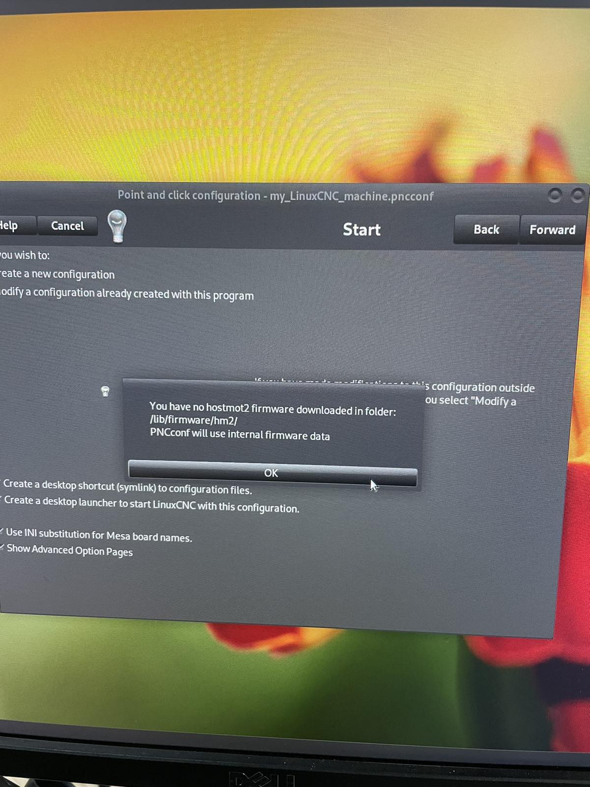

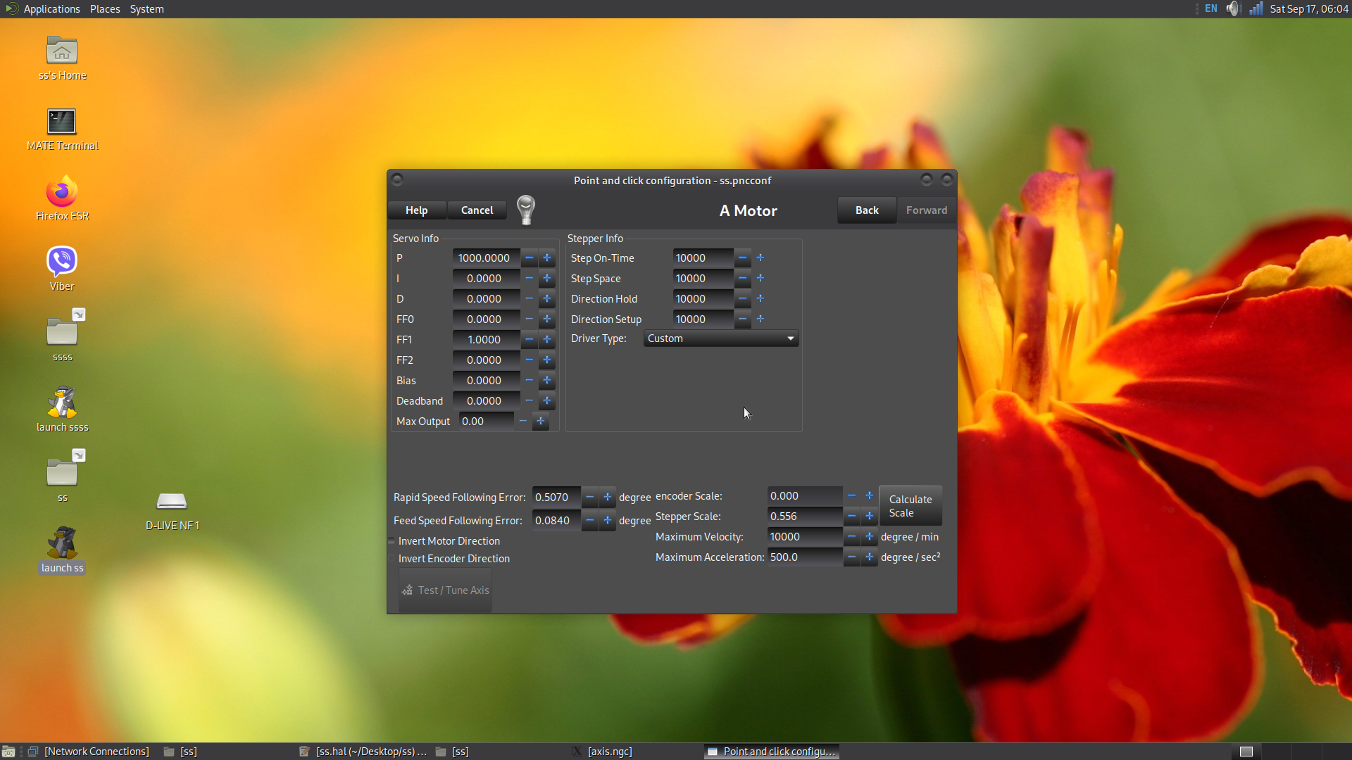

17 Sep 2022 09:09 #252149 by Masiwood123
this solved the problem, now it recognizes 7i96s, and loads the configuration without error, however until item A in the configuration it won't accept forward..only xyz?
File Attachment:
File Name: ss.ini
File Size:4 KB
File Attachment:
File Name: ss.hal
File Size:11 KB
  • Masiwood123
  • Offline
  • Platinum Member
  • Platinum Member
17 Sep 2022 09:21 #252151 by Masiwood123
SOlved stepper scale was the problem
