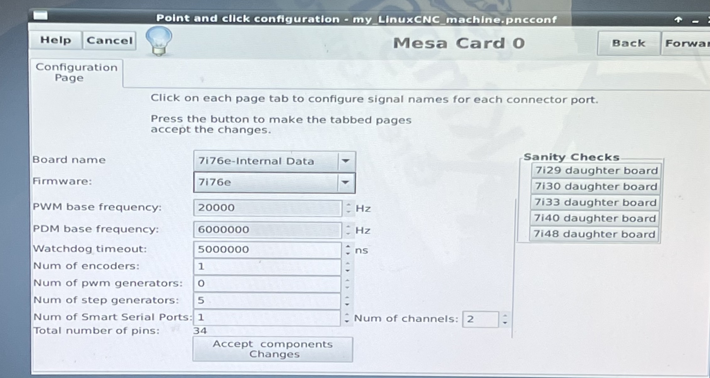

I’m trying to set up my Mesa 7i76e in pncconf and the box to enter the Mesa ip is missing. If I continue I can’t get any output from the Mesa board when trying to configure the motors and when I try to run the configuration it crashes. This is on a fresh install of 2.8.0 and i’m able to ping the Mesa board no problem.

Click on "accept component changes".

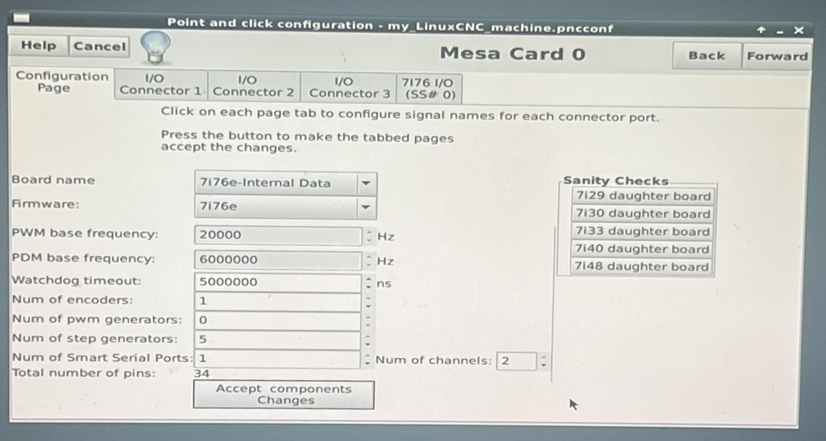

If it's truly linuxcnc 2.8.0 - I would upgrade to 2.8.3

Scroll down, you have a very small screen.

I can’t I tried with a trackpad and a mouse. Also I’m not able to resize the window by dragging or by using the menu in the top left.

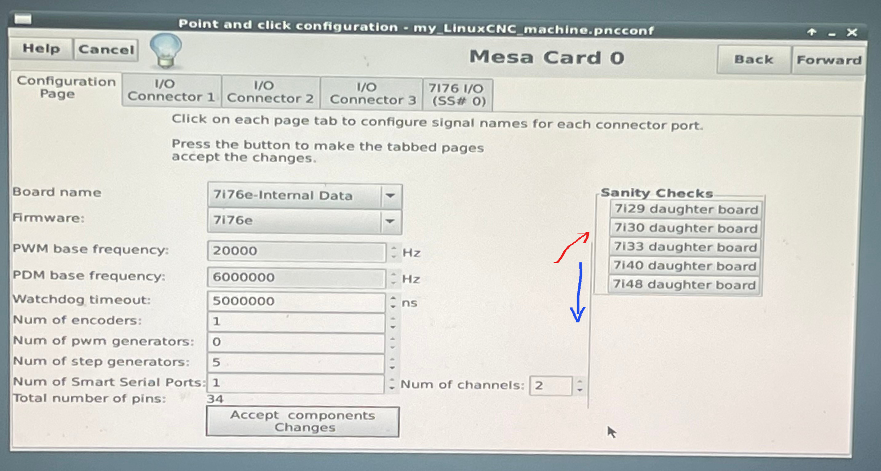

Replied by tommylight on topic Can’t configure board ip in pncconf

Just tried it nothing happens.
