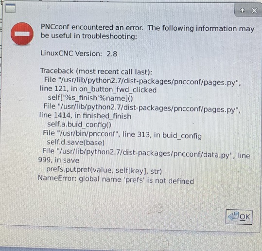

NameError: global name 'prefs' is not defined. was created by Karri

Replied by cmorley on topic NameError: global name 'prefs' is not defined.
This is not you this is a bug in pncconf.
You may need to choose one of the other screens and hand edit to get TOUCHY at the moment untill a fix is made.
