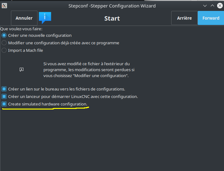

How to create sim configuration with Pncconf ? (LCNC 2.9 for sim, Kubuntu 20.04) was created by macsddau@linuxcnc

There is no hardware simulation component for Mesa cards and it would be a pretty big job to make one.
