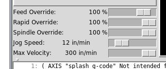

In your Axis display, do you have two jog sliders shown? i.e. one for linear jog speed, and another for angular/rotary?
From the Axis manual page, section 3.9
Or just one?
On machines with a rotary axis, a second jog speed slider is shown. This slider sets the jog rate for the rotary axes (A, B and C).Or just one?

- mloser
- Posts: 39
27 Jan 2023 13:02 #263018
by mloser
Replied by mloser on topic Rotary Axis ("A") driven by Stepper Motor with no encoder
I do have 2 jog sliders.
