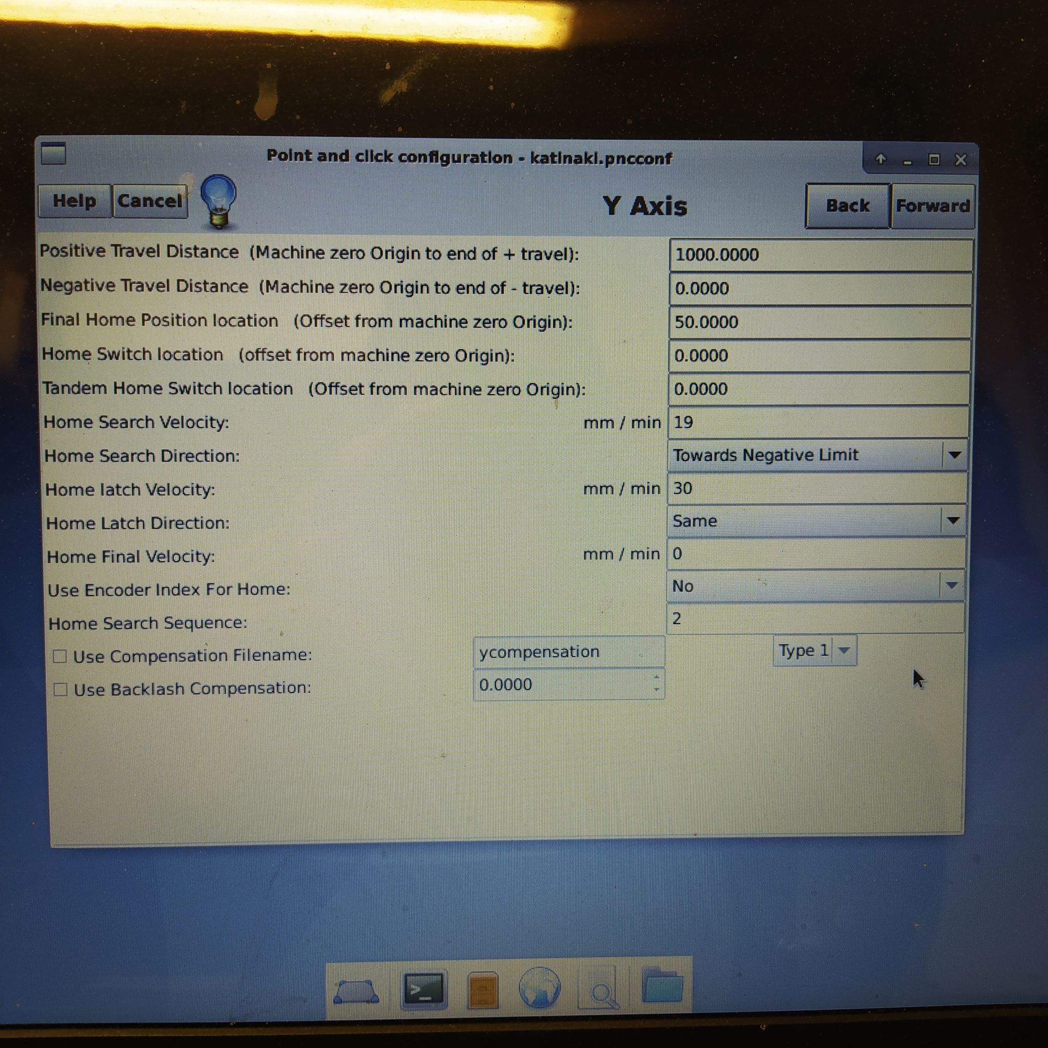

Hallo everybody.
This is my first project with Linux CNC and I am not really Linux experienced.
Its about a 3 axis CNC router controlled by a 7i96s Mesa card.

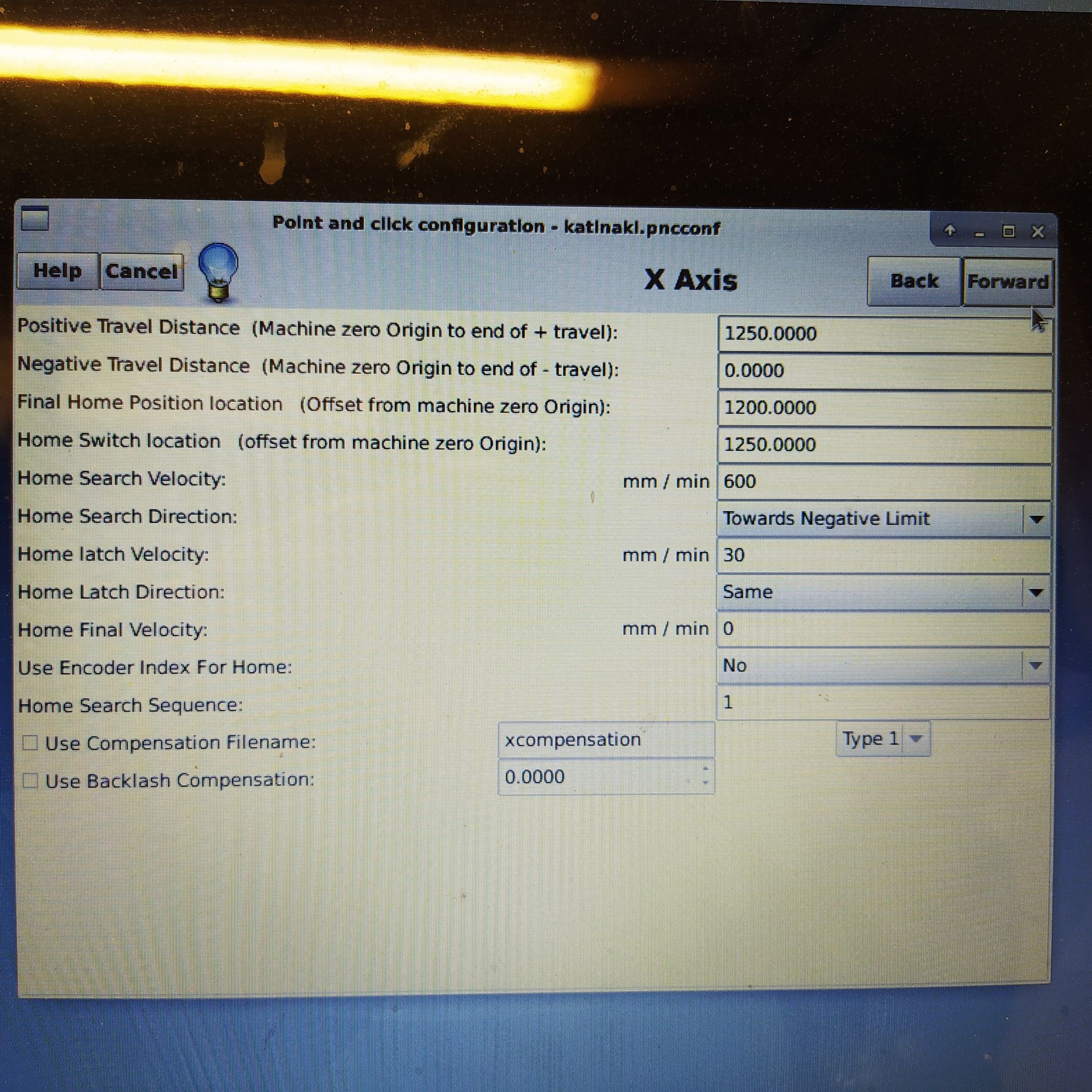

I did succeed configurate homing for X and Z axis which have one motor/joint.
But when I am tryin homing Y axis which has tandem motors with one sensor as Y main, the joints are moving in opposite directions. brrrrrrrrr.
When I skip homing and I am jogging the Y axis everything works perfect.
Can you help please with that issue.
I have a spare sensor to install as Y2 but I feel that that process is even more difficult.
I adjust some screen photos of the pncconf wizard.

If you want to be able to square the gantry every time the machine homes, you need home switches on both Y.
With one, only use if both motor drives are wired to the same output on the Mesa board, and the machine is set up as a single Y axis.

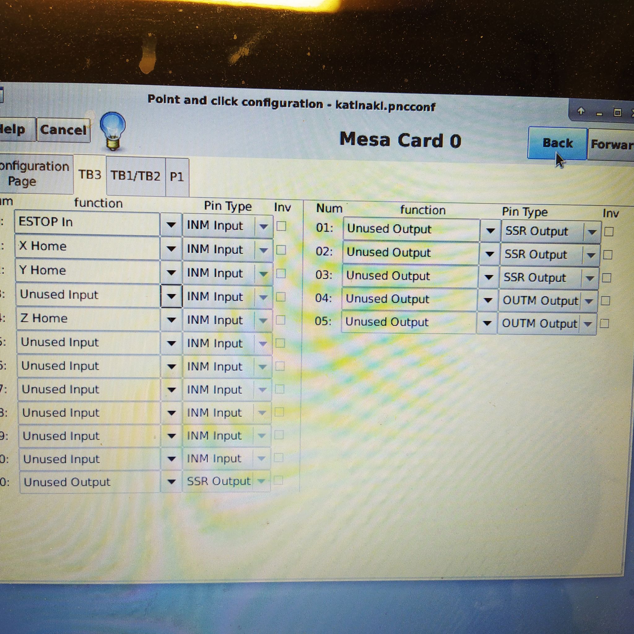

So If I understand what you said me or I have two steppers plugged in the same port with one home sensor or every stepper could be plugged on different port only if it has its own sensor.
I add the hal and ini files in case that helps

I just put the same sensor as Y and Y2 and works

Or you can do that!I just put the same sensor as Y and Y2 and works

What should happen is the first side to hit the limit switch and stops to wait for the other side to catch up before completing the homing sequence. Squaring can be adjusted in software by altering the home_offset in your ini file (eg a 2mm difference side to side can be corrected by having a 2mm difference in home_offset values.
So now linuxcnc will see both sides get to the home switch at the same time and squaring will not ocurr.
I don't know about your machine but on my plasma gantry it wass possible to push the gantry out of square by 150mm (6 inches) and it would sort itself out when homed.
I guess it depands how accurate you want your machining to be.
Replied by rodw on topic Tandem motors homing with one home switch Mesa 7i96s
It might work but there is no guarantee your gantry is square.I just put the same sensor as Y and Y2 and works
