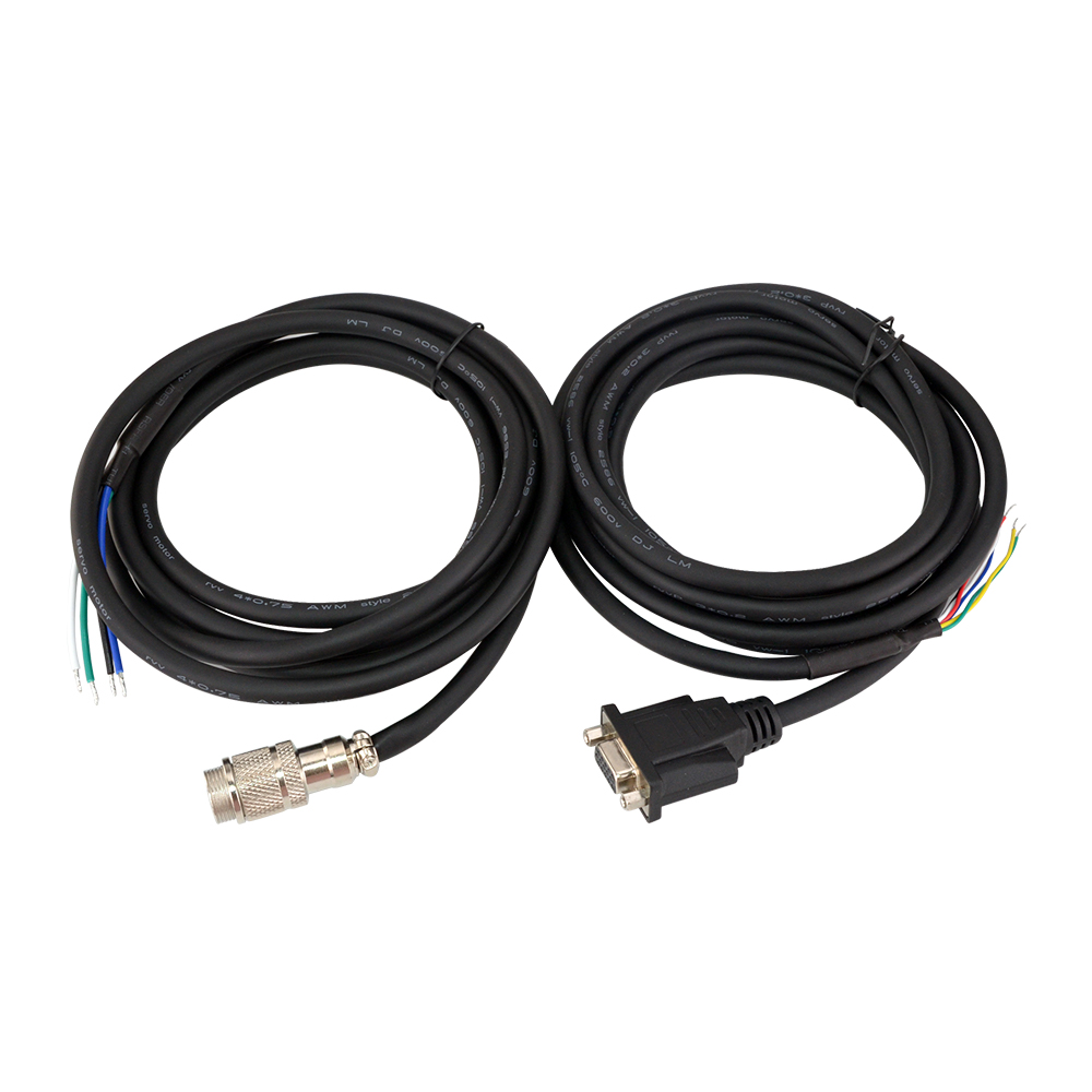

Tommy - the motors have a DB connector on a short cable for the encoder out. You also get an intermediate cable with a mating DB on one end and flying leads on the other.
Imerely mentioned the color change because I wanted waterproof connectors inside my mill and chopped the DB's off & replaced with some IP68's... and discovered the color change the hard way. Similar buzzing noise and angry drives @echristly reported.
@echristly - congrats. Didn't realize they'd removed the tuning port on V4.0, because V3 and V4.1 both have ports. Hope you can get the issue resolved with Stepperonline.

Now that I've got the motors running, and by doubling the servo loop time I've gotten rid of the joint errors, I'm wondering if there is a way to verify the encoder wiring. I've done a very good job of probing the ends of the cables, so I know they're right all the way up to going into the driver.
But, are they coming out of the motor connector correctly?
You can verify the power connections to a stepper by ohming out to find the connected pins. Is there a similar procedure for encoders?

Ok, I'm thinking first step is to confirm the ground pin on both the motor connector and the flying lead.
The product page indicates white is ground. Check continuity between white flying lead and the DB15 backshell.
Next check pin 3 on the DB15 motor side has continuity with the backshell.
If it's all good we can move on.
- spumco
- Posts: 2169
- Thank you received: 896
20 Jun 2023 02:06 #273891
by spumco
Replied by spumco on topic Fresh start with 7i96s and CL86T
Assuming you've confirmed which is the 0v wire... if it matches the pinout on the product page (pin 3, white lead), then you've got a couple of options.
Option 1 is to supply 5v to pin 2 (VCC, red) and 0v to pin 3 (white) and connect your oscope to the A/B outputs. See if you can pick up a signal while you rotate the motor.
Option 2 - my hacky way - is if you don't have an oscope. I'd connect the leads to a Mesa spindle encoder input, power the board, start LCNC, and try to catch the signals in halscope.
If it doesn't match, I'd do a continuity test on the extension cable(s) to seeif the colors on the product page (cable, not motor) match reality.
