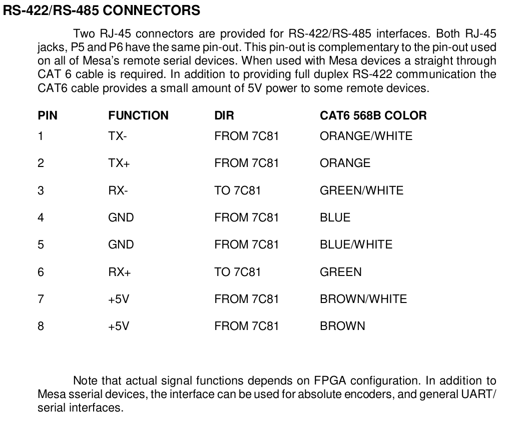

Attached is the private_data.py file from the 2.9 pre-release which has been updated to include the 7C81 card. It has all of the firmware choices associated with the Mesa pin files except the two that are 7i77 related. They have MuxedQCount, and it looks like the pncconf software does some special things to deal with that. So I opted to avoid it.
I'm willing to update the github repository if a moderator, or whomever blesses such things, give that a thumbs up. Or someone who maintains pncconf could push this file.
However, I would really like one or more people to try this before pushing it to the repository. It appears to work, but...

The way to have this reviewed for inclusion would be to fork the Linuxcnc repository,
Create a new branch maybe call it 7C81-pncconf
Make your changes to that branch and commit it to your repo under that branch.
Then you can create a pull request which the devs could review and include.
Normally, changes get pushed to master branch but I think you should work against V 2.9 in this case so it is included in the pending release of 2.9

I did a quick test - seems as if it works in pncconf.
I assume you have tested on a real card?
the tab names p1/p5/p6 p2/p5/p6 etc is that right?

Attached are the manual and a pin file.
I named the tabs p1/p5/p6, etc because some of the pin files include the sserial channels which are listed in the document as P5 and P6. This naming seems like it's arbitrary, and I almost just made the tabs P1, P2, and P7. I can make it whatever people think is the least confusing.
Gene

Should it not be p1,p2,p7 and then p5,p6 - idea being a tab represents a connector?
It might be too much trouble to bend pncconf to do this though.
What about the GPIO connector?
I can push this when you are happy.

All the signals are actually going through P1, P2, and P7. I'm just going to drop the P5 and P6.

I cancelled the pull request because I think what I submitted was incorrect I separated out P5 and P6 in this version, but still think it's not correct.
I don't know how to handle the smart serial interface. The PIN files list TX Data, RX Data and TX Enable, but I don't understand how that aligns to the signal list in the document for P5/P6.
