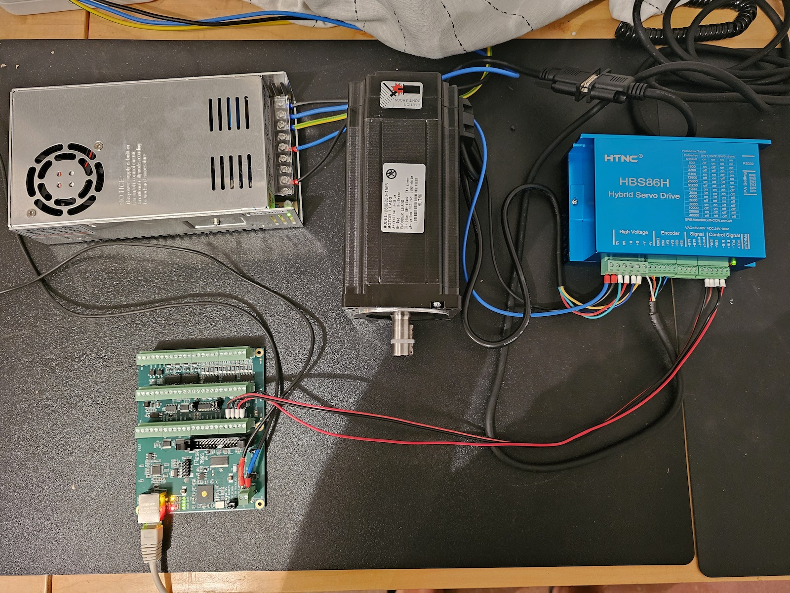

Hi guys,
I'm total noob and would really appreciate if someone could help me with basic configuration so I can start using LinuxCNC.
I have following setup:
- Mesa 7I96s
- HBS86H hybrid servo drive
- Motor 86HB250-156B
- LinuxCNC 2.9Wiring as in the photo

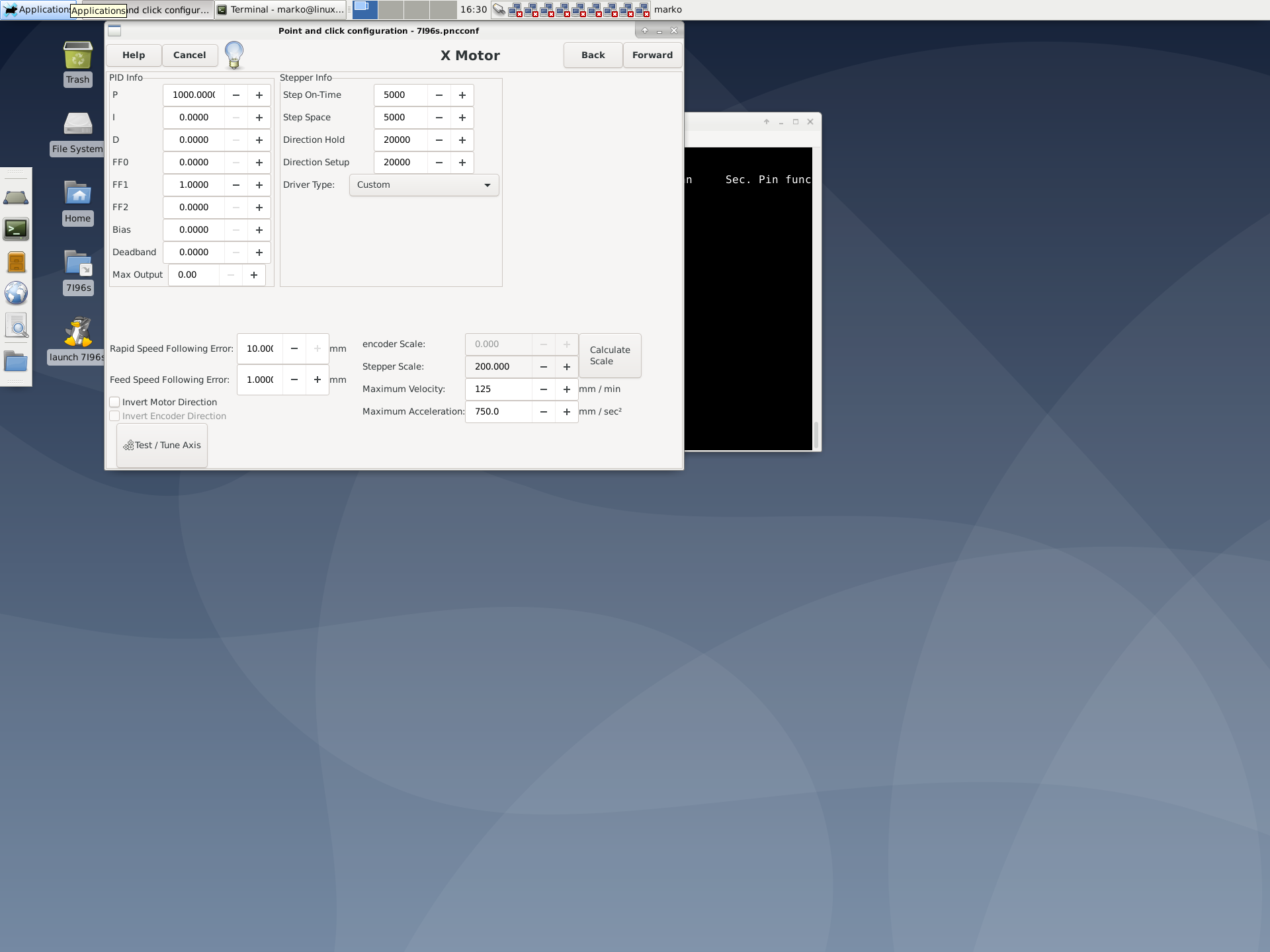

This is my default conf for X axis which is connected to "Step 0" pins on mesa board.
When I click "Test/Tune Axis" button I get strange noise from the motor but without shaft moving. Video with the sound www.dropbox.com/s/zqsdf3h1kgi9frx/2023-0...%2022.32.43.mp4?dl=0
What am I missing?
Thank you.

02 Aug 2023 15:26 #276780
Replied by PCW on topic Basic PnCConf conf. with 7I96S board, HBS86H drive and Close Loop Stepper Motor
I would just create a LinuxCNC configuration and run that
