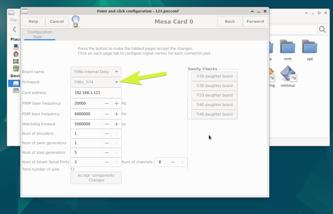

06 Sep 2023 08:26 - 06 Sep 2023 12:52 #280071
by abdulasis12
I have question
When open PNCCONF on page config MESA CARD 0
I choose Board : 7i96s internal Data
but Firmware not have 7i96s_7i77 , it's have 7i96s_7i74, 7i96s_d , 7i96s_dpl only.
How I get Firmware for 7i96s_7i77 ?

- Posts: 18108
- Thank you received: 5328
06 Sep 2023 15:11 #280111
Replied by PCW on topic MESA 7i96s + 7i77 how to get file .bit for flash
I would create a configuration for a 7I92+7I77
and then change the card name in the .ini file from 7i92 to 7i96s
That should create a working 7I96S + 7I77 configuration
The following user(s) said Thank You: abdulasis12

13 Sep 2023 16:31 #280646
by abdulasis12
Replied by abdulasis12 on topic MESA 7i96s + 7i77 how to get file .bit for flash
It's work with your guide , Thank you MR.PCWI would create a configuration for a 7I92+7I77
