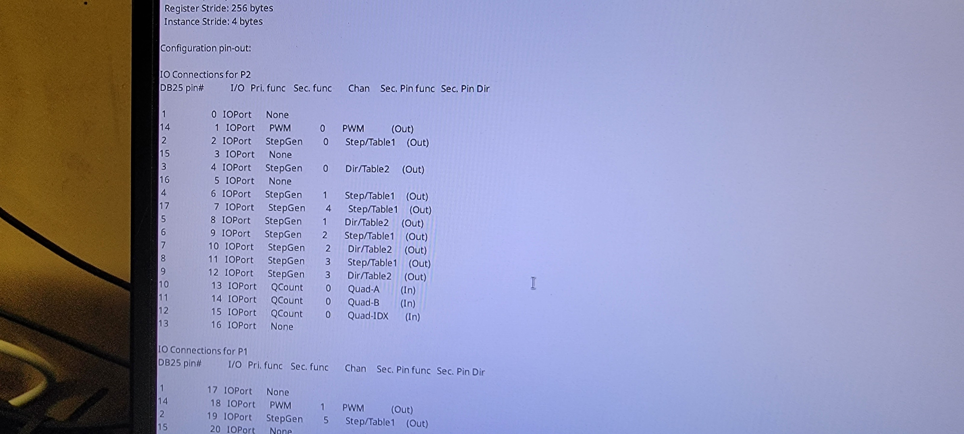

7i92 & C11G BOB issues

05 Sep 2023 13:42 #279969
Replied by PCW on topic 7i92 & C11G BOB issues
It looks OK to me
The pncconf pin list can be a bit confusing since it mixes
channel numbers (stepgens,PWMgens, encoders etc)
with GPIO numbers. GPIO numbers are 3 digits

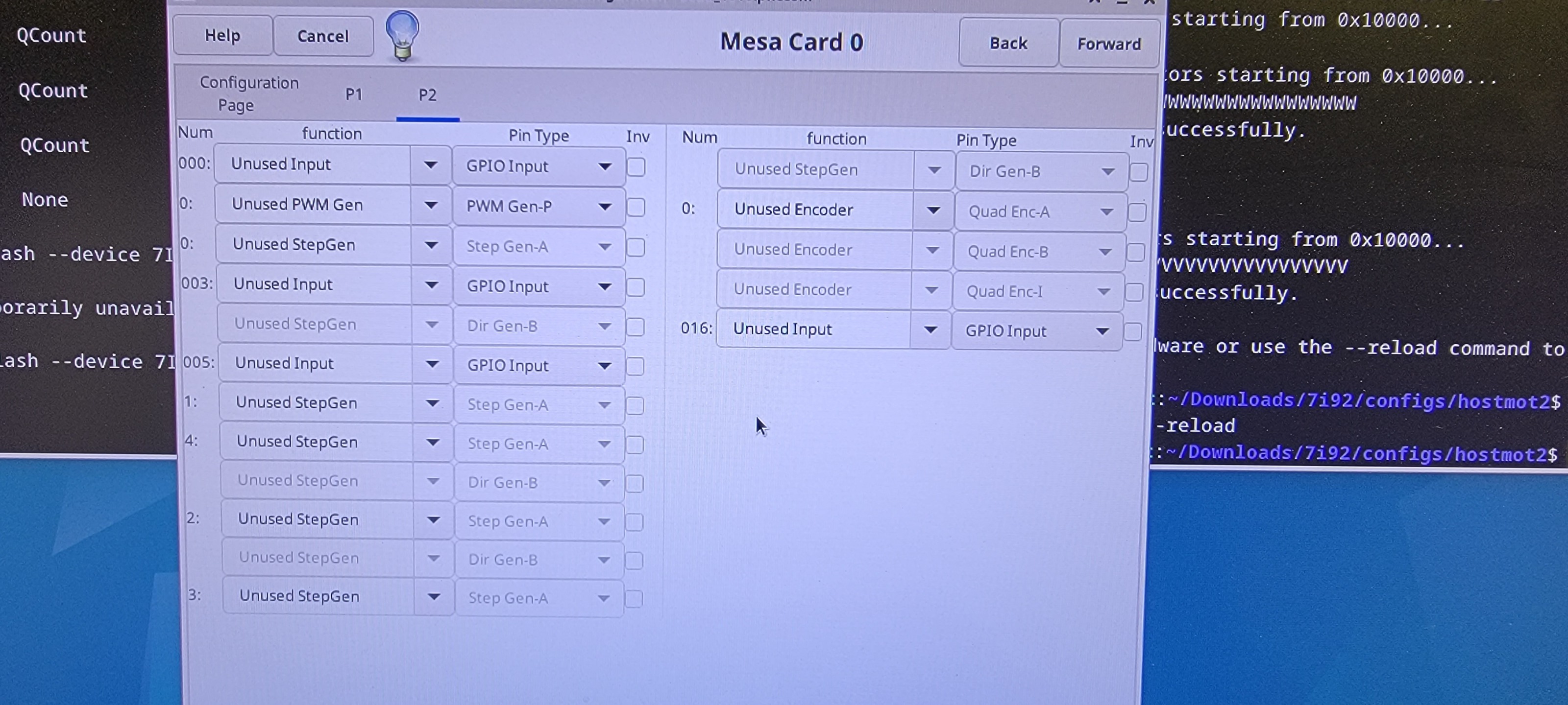

- Techsavvy34
- Posts: 21
05 Sep 2023 14:39 #279980
by Techsavvy34
Replied by Techsavvy34 on topic 7i92 & C11G BOB issues
Shouldn't pwm io port 1 show as 1 on the P2 config page? Or does it follow the secondary function numbers?
- Online
- Posts: 18108
- Thank you received: 5328
05 Sep 2023 17:51 #280009
No, PWM 0 (on P2 DB25 pin 14) just shows up as channel/secondary
function 0 in pncconf. This is also how it's addressed in the hal file,
(by channel not pin)
