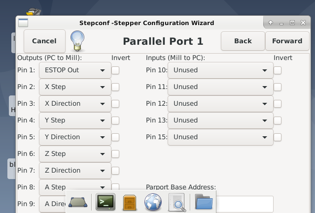

I'm looking at connecting 7i92tm boards to a couple lathes which have been running through parallel ports . I want to simply connect the 7i92 directly to the current cheap breakout boards . I'm looking at this through vmware just to get a feel for it and I am confused as to how a direction pin is selected in the wizard . I'm seeing stepgen but nothing for direction which has me a bit confused .

With Mesa cards, the pin selection for things like step and direction are fixed.
That means you typically need firmware that matches your chosen breakout board.

bummer I didn't realize I'd need a different firmware . I hoped to just connect from the 7i92 to my bob on my current setup . I'd have gone with the 5i25 which I've been running on pathpilot . I have 2 on hand for spares but I had to replace them in the past so I'd rather keep them for the mills since they are no longer available . I was hoping the 7i92 would have been as straight forward but obviously not
I saw the stepgen for each axis which I assumed would be step as I would for a parallel port setup (in attachment) . It was trying to figure out how to input the direction in pnccong wiz I was confused about , but really I'm a bit confused on the whole setup at this point . I'll probably keep running off the pp as I have been

Do you have the pinout for the parallel port or the screenshot from StepConf?

What firmware did you use on the 5I25?
(That must have been flashed to match your breakout as well)
If your stepconf config picture matches your breakout, a mx4660
configuration should work: 7i92t_mx4660d.bin

A MX4660 or MX3660 (3 axis only) pinout looks like an exact match to the stepconf pinout

sometimes it's easier to connect everything and go through the motions rather than looking at other things from a distance . What started the confusion while looking at the hal for pathpilot is that it showed the pinouts . What I didn't notice was that there was a # on each line which means they likely put it there for their own benefit , and thats why the hal I created didn't show that
When looking at the pncconf wiz I hadn't realized that the selected stepgen of x for example gave predetermined pinouts for step and direction for the steppers . I've always been used to deciding on which pins I'd use for an axis , I suppose this is the same just different . It was just a matter of figuring out how to see the pinout for the stepgen and things became clear .
