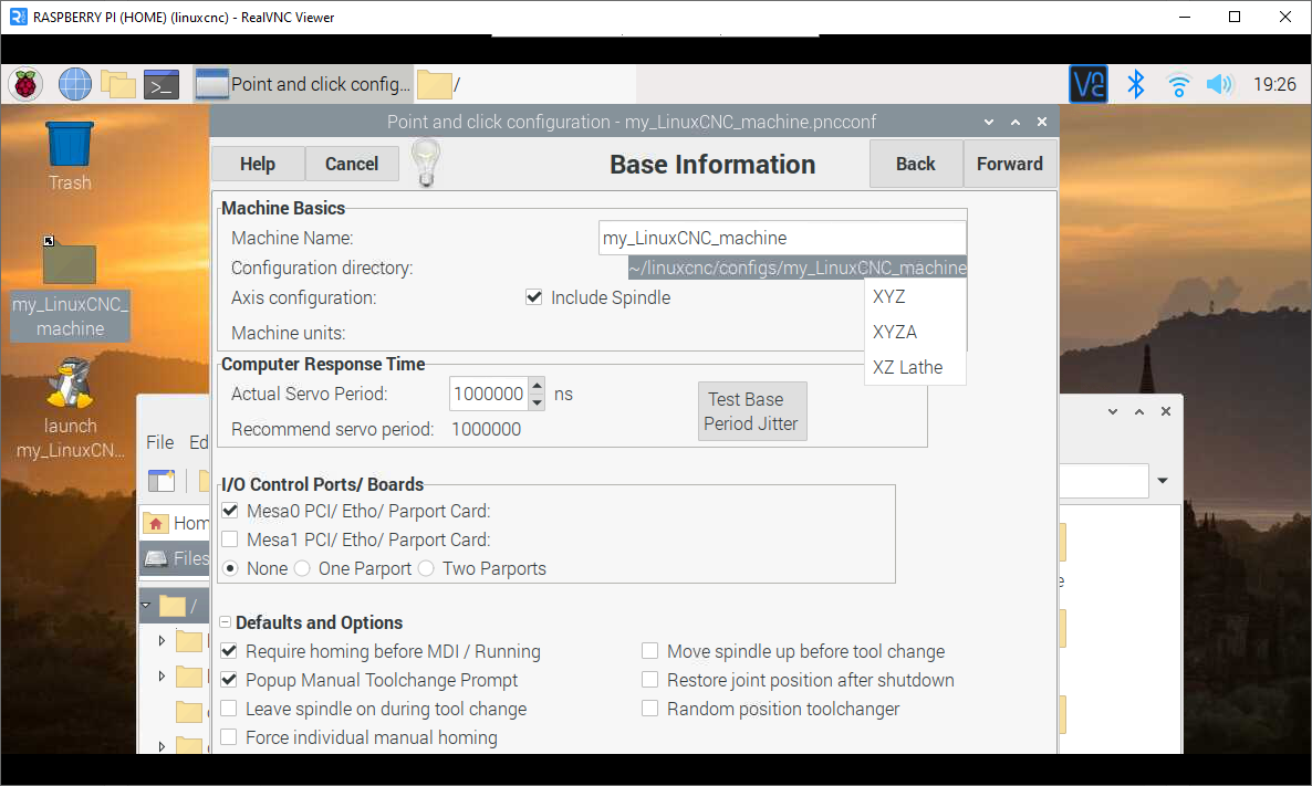

Does PNCconf wizard can be used for configure 5-axis CNC machine?
If YES, So, while trying to configure i find no option for 5-axis (XYZAC) as you see in attached IMAGE there is option for only (XYZ, XYZA, XZ Lathe), SO, how do i configure for 5-axis then.
I am using MESA 7c81 card.
Kindly explain the process of configuration for 5-axis.

pncconf only does 2, 3, or 4 axis machines.
