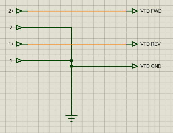

Ontop of this I have a PWM to 0-10V module so step- of the pwmgen goes to the pwm module and then on to the VFD.
In the main hal file(if I remember correctly) I changed to 1 pwm gen and 4 stepgens.
I suspect this is the same result as selecting 7i96S and renaming it afterwards
Things seem to work now except VFD won't go into "gear", speed changes according to 'M3 Sxxx' commands if I manually ground FWD or REV on the vfd.
I can tell on the mesa card that it is switching output2 and 3 as it should, but something about my wiring must be off.
VFD ground is the same as the Mesa cards ground to make sure they're on the same level.
I'm guessing that maybe the lack of voltage difference could cause issues with SSR's or maybe I need a pullup resistor if the levels are possibly floating around a bit?

Managed to sort the REV/FWD issue out. I think Output1 is stuck on, no matter polarity it instantly grounds my signal cable.
Changed over to use Output 4 and 5 instead, works fine now!
