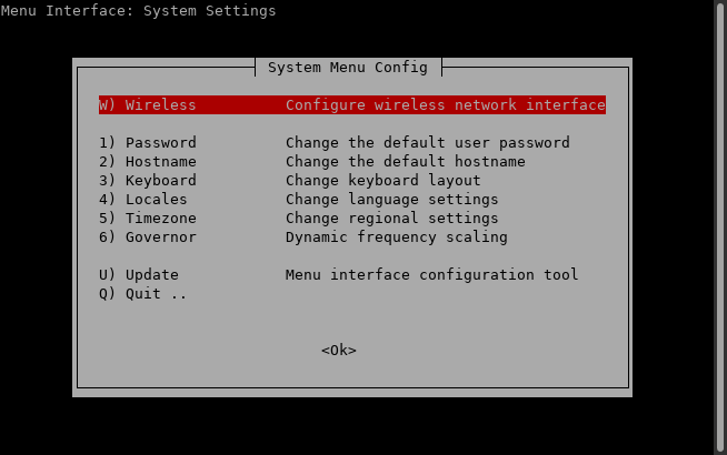

the installed image includes the command menu-config.
Confusing I know.
Replied by rodw on topic Issues with Raspberry Pi4 and Mesa 7i96

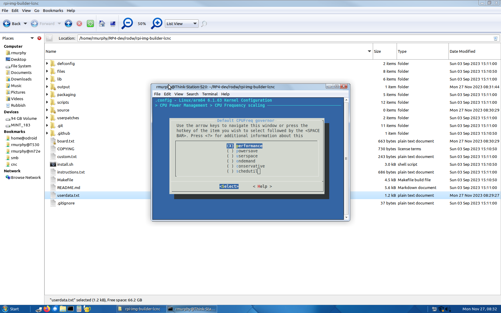

Not the same.I can't remember is there an option to run menuconfig ?
Just found it......
MENUCONFIG="0" set this to 1 in userdata.txt and make the changes in menuconfig.
Confusing I know.

Even from the original githubConfig Menu
Username: # Your username
Password: # Your password
Enable root: # Set root password to `toor`
Linux kernel
Branch: # Supported: 6.1.y and above
Build: # Kernel build version number
Menuconfig: # Kernel menuconfig
Compiler: # GNU Compiler Collection / Clang
Ccache: # Compiler cache
Distribution
Distro: # Supported: debian, devuan and ubuntu
Release: # Debian: bullseye, bookworm, testing, unstable and sid
# Devuan: chimaera, daedalus, excalibur, testing, unstable and ceres
# Ubuntu: focal, jammy, kinetic and lunar
NetworkManager # 1 networkmanager | 0 ifupdown
Customize
Defconfig: # User defconfig
Name: # Name of _defconfig (Must be placed in defconfig dir.)
User options
Verbosity: # Verbose
Devel Rootfs: # Developer rootfs tarball
Compress img: # Auto compress img > img.xz
User scripts: # Review the README in the files/userscripts directory
User service: # Create user during first boot (bypass the user information above)
- Review the userdata.txt file for further options: locales, timezone, nameserver(s) and extra wireless support
- 1 active | 0 inactive
