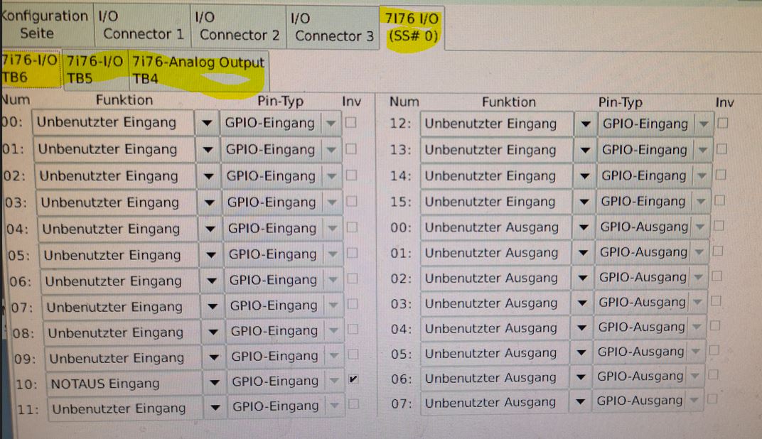

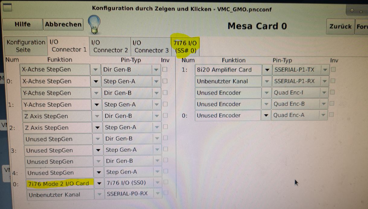

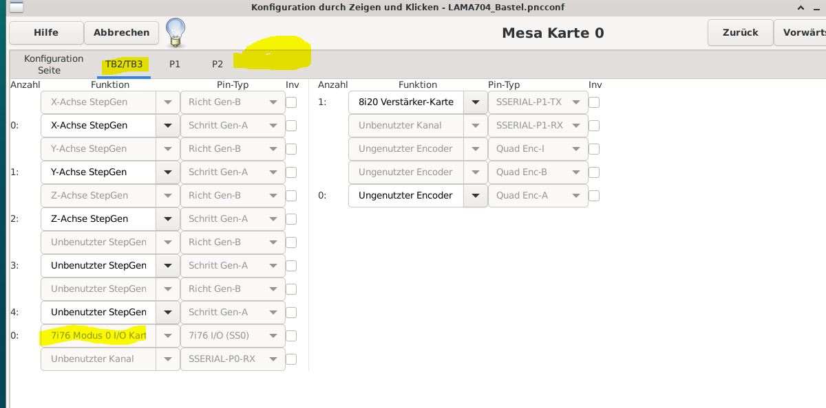

Hello World
In the past I only installed and played a bit with linuxCNC. Not I like to implement it on my new CNC mill. Because of this I installed the latest version 2.9.1 on my pc, startet pncconf and now it looks different to my old linuxcnc installation regarding the Mesa tabs.
Before I was able to get access to Mode 2 and Tab 5 / 6 etc. Now I´m not able anymore?! Or do I miss some information ?
Attached the old world (2.8.X) and the latest (2.9.1)
Thank´s
Jannik

I confirm the problem and will look into it.

If you check the 'advance options' on the first page, you should be able to select 7i76 modes.
The following user(s) said Thank You: tommylight, HenkvE, N3pu

11 Nov 2023 08:50 #285079
by N3pu
Replied by N3pu on topic 7i76e Mode 2 Selection in LinuxCNC 2.9.1 not possible anymore?!
It works. Thank you
I simply missed to check the option...
