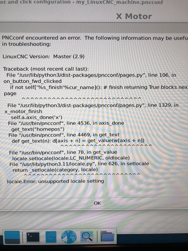

Hello,I am running LinuxCNC (2.72) on a intel pc for some years successful. Now the harddrive on the intel pc is broken and I would like to run LinuxCNC on a RasPi 4.I created the raspi image and I booted the raspi and now I am trying to create the configuration using PNCconf.When I try to finish the X Motor settings I get an error PNCConf encountered an Error ......locale.Error: unsupported locale settingCan anybody help me to fix this problem, so that I can configure my cnc on a raspi 4, please. (I cannot use the config files from the older version, because there are some changes in the config file /s, and I am pretty sure I have to create now config files for version 2.9.2.I am using a Mesa Card 7i76e (which was/is successfully used by my old config)Any help is highly appreciatedBest regards Hartmut

Change the locale settings to UTF-8, search google for how to do that on Debian, any Debian.

Many thanks for the reply - changing locals to en_GB.UTF-8 using the cmd sudo dpkg-reconfigure locales solved this problem. Hope I have now fix all stuff to get linuxcnc running on raspi.

When I run the "sudo dpkg-reconfigure" command it says it needs a package name. Do you recall what package needs to be reconfigured?

found it "pkg-reconfigure locales" and it fixed the issue. Thanks
