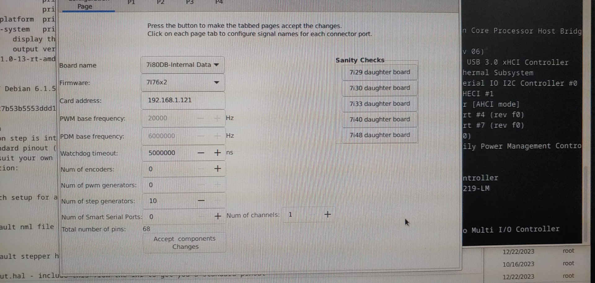

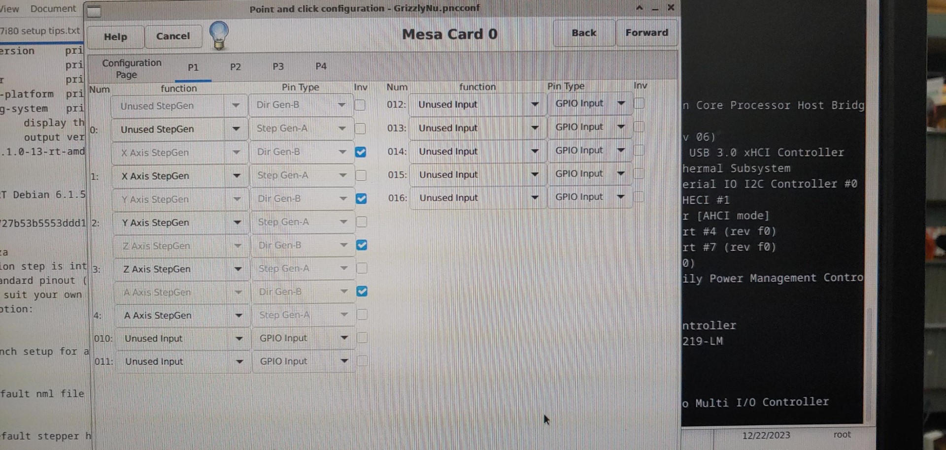

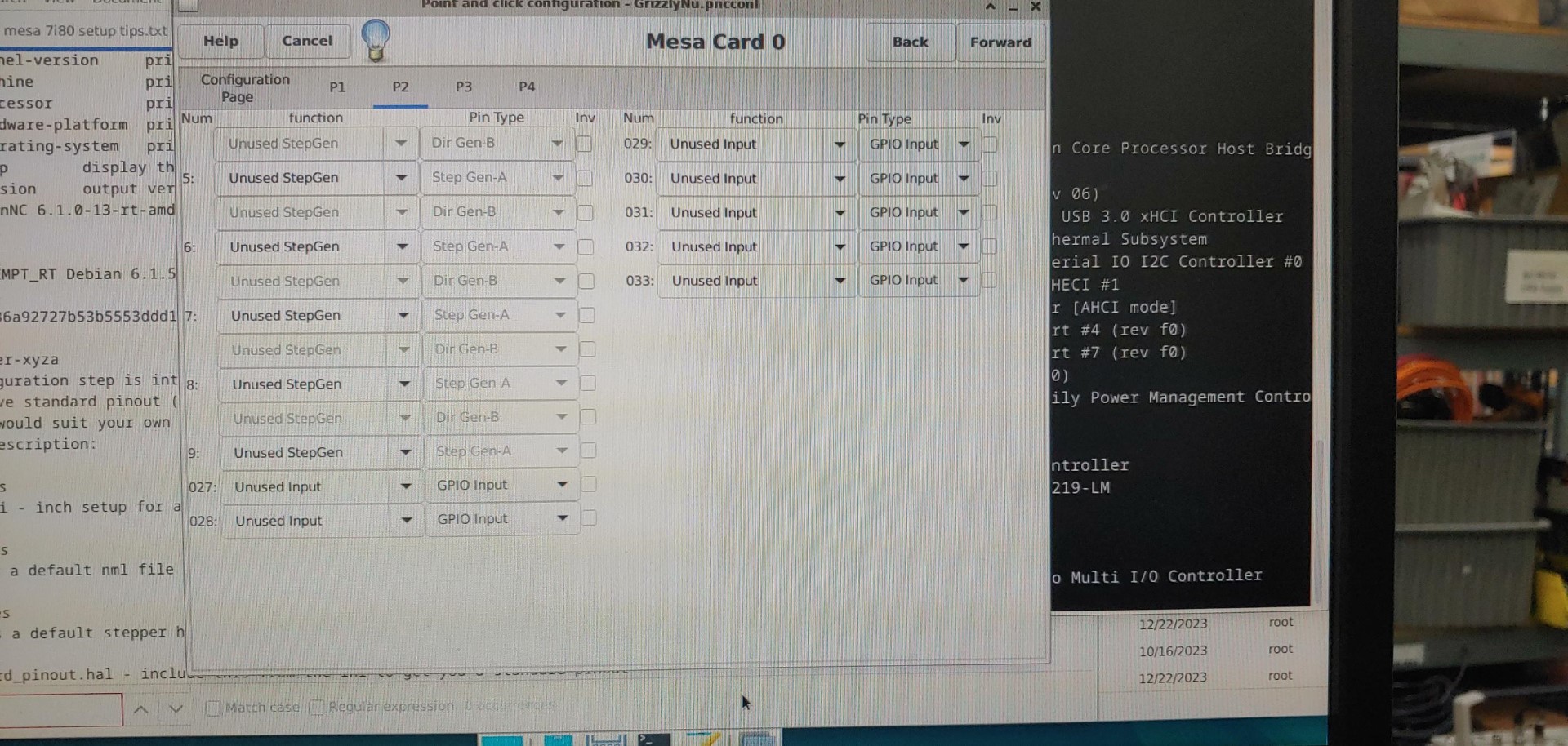

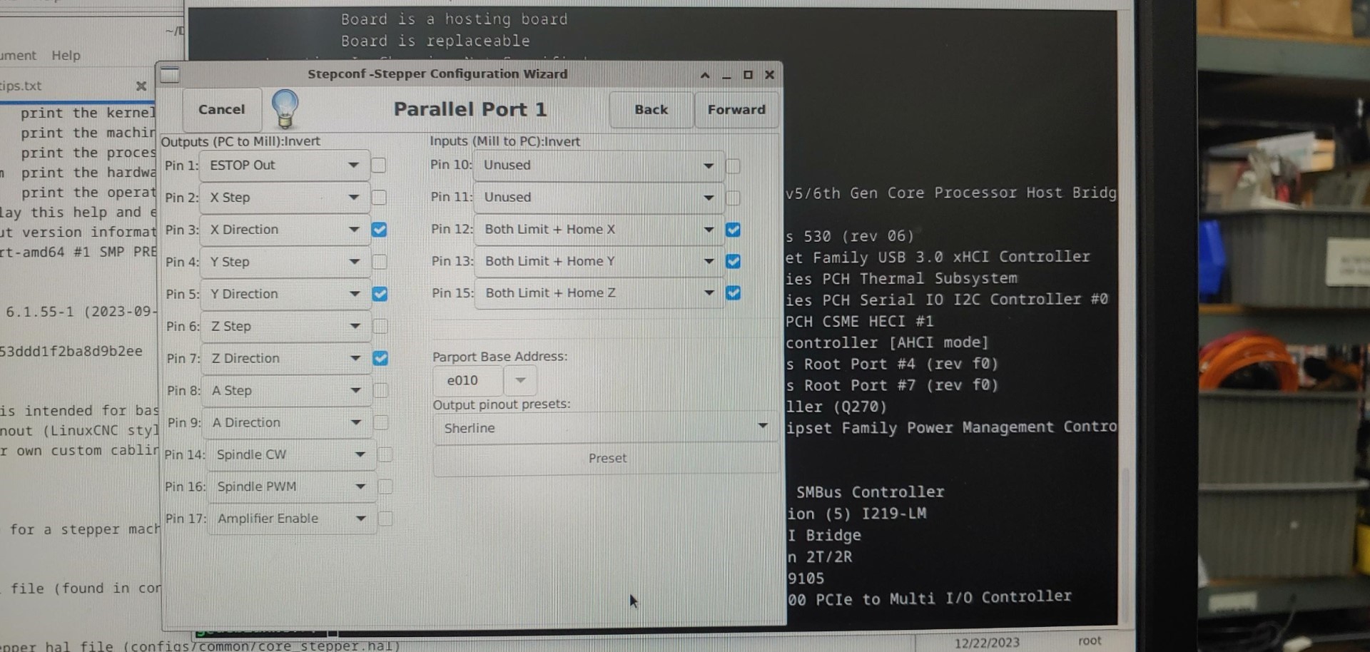

requesting help with 7i80DB-16 and C10 breakout board was created by gbsd86
Trying to duplicate PP setup to avoid re-wiring.
Have configured with Pncconf. Linuxcnc will not open.
Using MB ethernet to 7i80. Can ping board.
PING 192.168.1.121 (192.168.1.121) 56(84) bytes of data.
64 bytes from 192.168.1.121: icmp_seq=47 ttl=64 time=0.695 ms
64 bytes from 192.168.1.121: icmp_seq=48 ttl=64 time=0.404 ms
64 bytes from 192.168.1.121: icmp_seq=49 ttl=64 time=0.409 ms
Have included the problem reports. Report1 and info1 are with WiFi card enabled.
2nd set is with the WiFi card disconnected.

Omit or delete the above mentioned line in the GrizzlyNu.hal
Replied by tommylight on topic requesting help with 7i80DB-16 and C10 breakout board
Note: Using POSIX realtime
./GrizzlyNu.hal:22: parameter or pin 'hm2_7i80.0.dpll.01.timer-us' not found
63925
Stopping realtime threads
Unloading hal components

Took that line out. Now:
/GrizzlyNu.hal:55: parameter or pin 'hm2_7i80.0.stepgen.01.dirsetup' not found
Last edit: 25 Jan 2024 22:33 by gbsd86. Reason: add files
- Posts: 18015
- Thank you received: 5291
26 Jan 2024 00:15 #291633
Replied by PCW on topic requesting help with 7i80DB-16 and C10 breakout board
Yes, that's because the firmware currently installed
in the 7I80DB-16 has no stepgen hardware
(it looks like a configuration for 4x7I77s)
What daughterboard are you using with the 7I80DB?
This determines the appropriate firmware so the
7I80DB pinout matches your daughterboard.

Replied by gbsd86 on topic requesting help with 7i80DB-16 and C10 breakout board
PnCConf lists 7I80DB - internal data
7I76x2 is the only selection
I am trying to duplicate my parallel port pin to avoid rewiring.
I have not loaded a bit file into the board. I assumed the PnCConf software did that.
Under the assumption the 7I80DB could be configured the same as the parallel port,
I am not using a daughter board, using a C10 breakout board: FEATURES:
