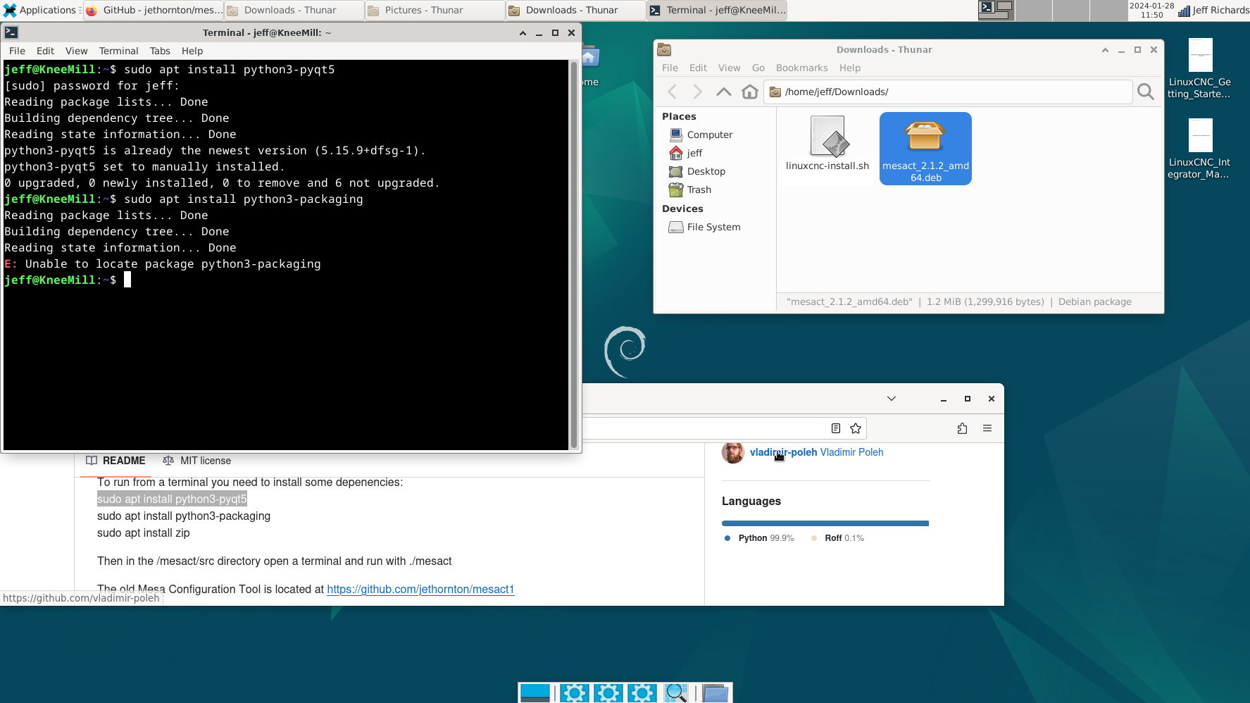

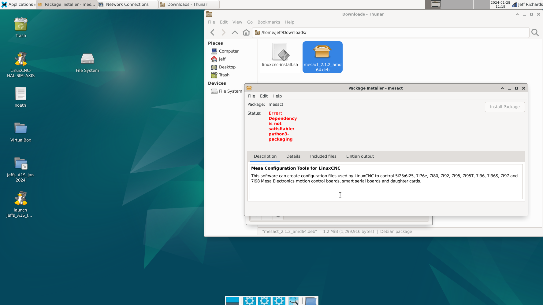

Newbie here, I will be using this for a 4 axis knee mill (X,Y,Zquill, Zknee).
I watched a few videos of how to configure and I think if I can either get the 7i95t to show up in PnCconf or if I can get mesa***.deb to install or run I would be away to the races.
The drop down selection list in PnConf does not include the 7i95t, and when I right click mesact***.deb and select install there is some sort of install requirement not being met (see attached image of error). I'm not sure how to fix the requirement?

28 Jan 2024 20:37 #291828
Replied by tommylight on topic MESA 7i95t setup issues can't install mesact***.deb
In a terminal:
sudo apt install python3-packaging
The following user(s) said Thank You: slowpoke

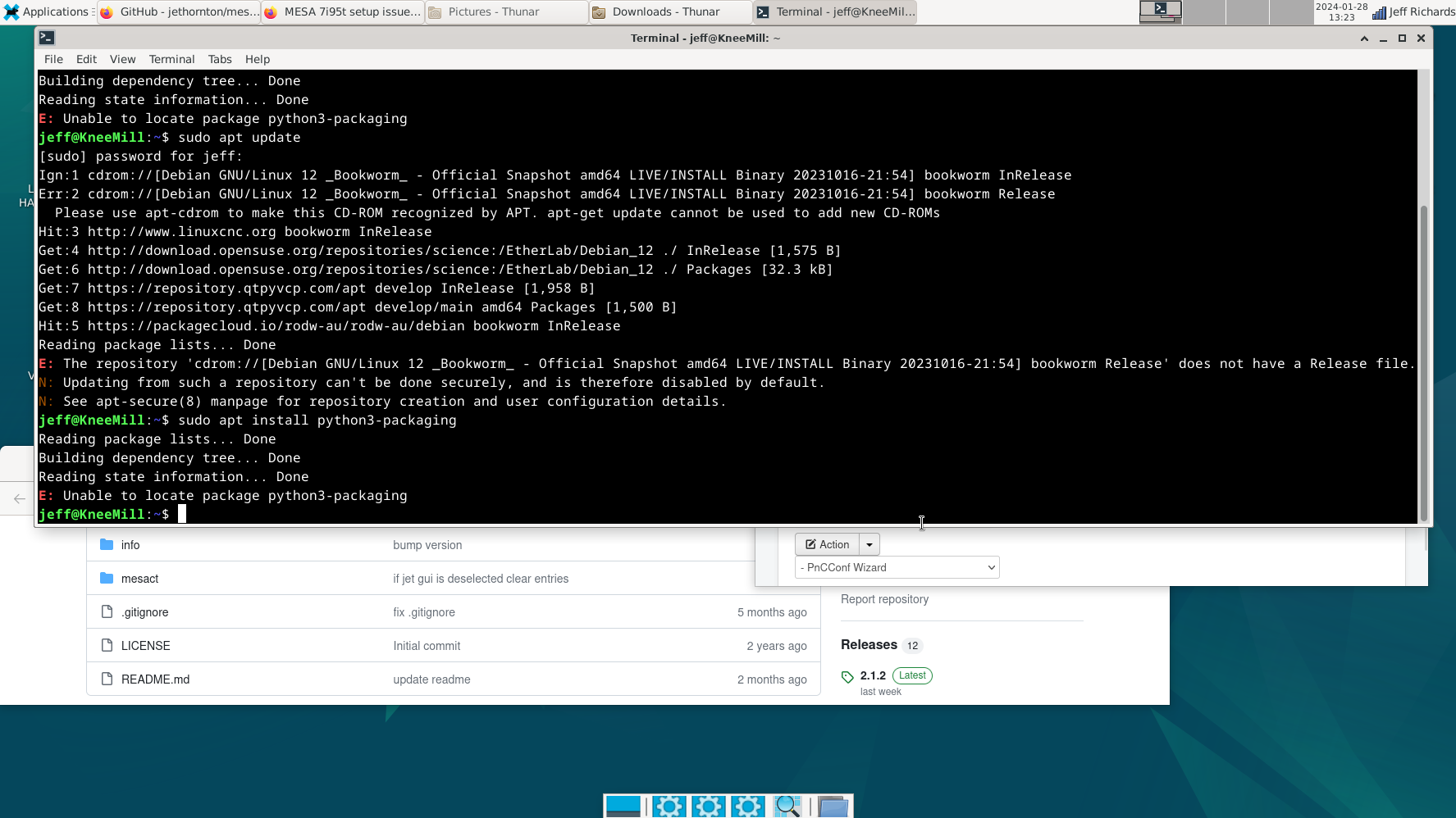

28 Jan 2024 21:17 #291834
by slowpoke
Replied by slowpoke on topic MESA 7i95t setup issues can't install mesact***.deb
tommylight,
I tried that, as per your instructions and I get Unable to locate package python3-packing. So I'm trying to figure out where to get it and where to put it?
The first step seemed to work, or actually was already installed please see attached image. Seems primed for install?
Much appreciated.
Much appreciated.

28 Jan 2024 22:02 #291841
Did you dobefore running that line?
sudo apt update

I think I just need to get past the "Unable to locate package python3-packaging." error So I'm trying to figure out how to do that?
The python3-packaging problem is now resolved - Thank You!
The problem was an incomplete Sources.List file, that was truncated because I did not have an internet connection via the LAN port during the install phase. After updating Sources.List, python3-packaging updated without issue.
With python3-packaging updated I was then able to click on the install for mesact, however I'm still missing the 7i95t option when I run pcconf, so I need to sort that out.
