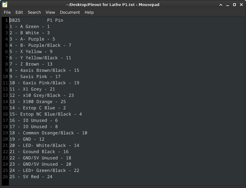

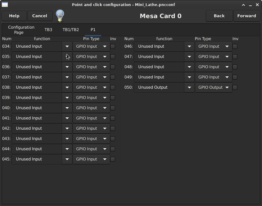

I'm currently setting up a multi axis mpg pendant on my 7i96s but I'm having trouble with the pinout in the pncconf. The pinout just doesn't match at all and I'm wondering if there's a way to see which pin matches up with the P1 pins on the board. I have attached some images. I have 25 pins to connect but only 17 available inputs. Any insight would be great. Does this need to be done manually in hal instead of using the config?
- Posts: 19914
- Thank you received: 4662
02 Mar 2024 04:26 #294891
Replied by andypugh on topic 7i96s MPG setup in configurator
Is that DB25 pinout assuming a parallel port, or do you plan to connect the MPG to the expansion port of the 7i96s?
Even assuming parport the pinout doesn't really make sense, as it has differential A/A B/B channels.
Are you planning to use the built-in encoder interface on the 7i96S for your spindle, or for the MPG?
From skim-reading the manual it doesn't look like the 7i96S offers an MPG mode directly, so you might need to run a software encoder counter in HAL to handle the MPG pulses. Though if you are feeling brave you could consider wiring the MPG to the (unprotected!) expansion header.
The neatest (though not the cheapest) solution might be to put a 7i73 in the MPG box and then run a CAT5 cable to the smart-serial port.

- Posts: 18122
- Thank you received: 5337
02 Mar 2024 14:56 #294945
Replied by PCW on topic 7i96s MPG setup in configurator
Looks like only 14 or 15 pins are needed
The rest are power or ground or unused.
(5V power can come from P1)
The A-,B- differential pair signals would be unused,
and likely the Estop common and NC would be used but
not the NO contact. Don't know if the LED is bipolar (Red/Green)
so you need both LED wires or whether you can just tie one
to 5V or GND.
In any case seems like its doable on P1, probably
with INM firmware that supports the MPG and built in
debouncing.
to 5V or GND.
debouncing.

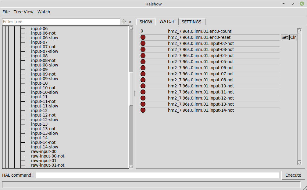

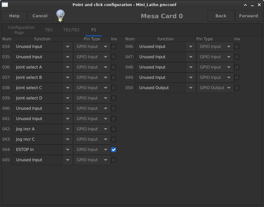

- Trevy3
- Posts: 21
08 Mar 2024 20:22 - 08 Mar 2024 20:23 #295485
by Trevy3
Replied by Trevy3 on topic 7i96s MPG setup in configurator
Ok, I got everything wired up now and I'm trying to test it. Currently, the only thing working is the Estop and the joint select. I'm not sure if this is the correct way to set it up in the pncconfig. I'm also not sure how to connect the encoder, as there isn't a dropdown item for it anywhere. Is that something that needs to be added manually in the hal file? If so, how should I go about doing that? I changed the joint select axes from A,B,C,D to X,Y,Z,A in the hal file.
Also, according to the .pin file, I don't have P1 pin 10 or 12 available for some reason.
Last edit: 08 Mar 2024 20:23 by Trevy3.

- Trevy3
- Posts: 21
09 Mar 2024 20:06 #295549
by Trevy3
Ok, I've got the whole mpg working now on all inputs. The only thing left is assigning the encoder input to actually move the axes. How would I go about doing this? Would I need to do some logic with the joint select and encoder input, or is there a simpler way? I'm just not sure what hal variable I should be assigning the encoder to after this. If anyone could edit the hal to get me in the right direction or something, that would be great.
- Posts: 18122
09 Mar 2024 20:25 - 09 Mar 2024 20:29 #295551
1. You should not use GPIO for the inputs but rather the INM pins listed
above (02..14)
This is because these have built in debouncing which will reject noise
(set the "slow attribute" for all INM pins used as switch inputs)
2. For the all axis jog count something like:
net mpg-enc-count hm2_7i96s.0.inm.01.enc0-count axis.x.jog-counts axis.y.jog-counts axis.z.jog-counts
Should be close. Note the the axis jog pins only work after the machine is homed
above (02..14)
