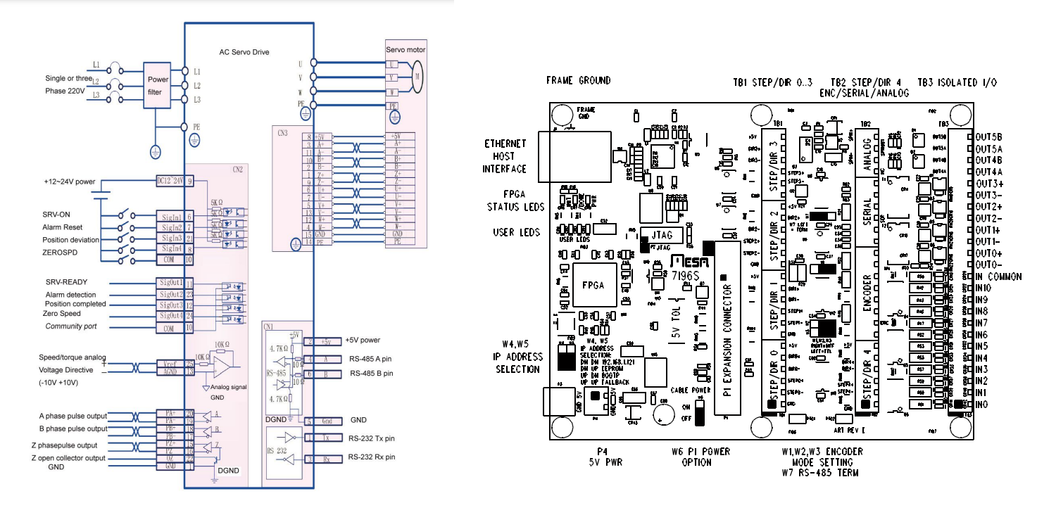

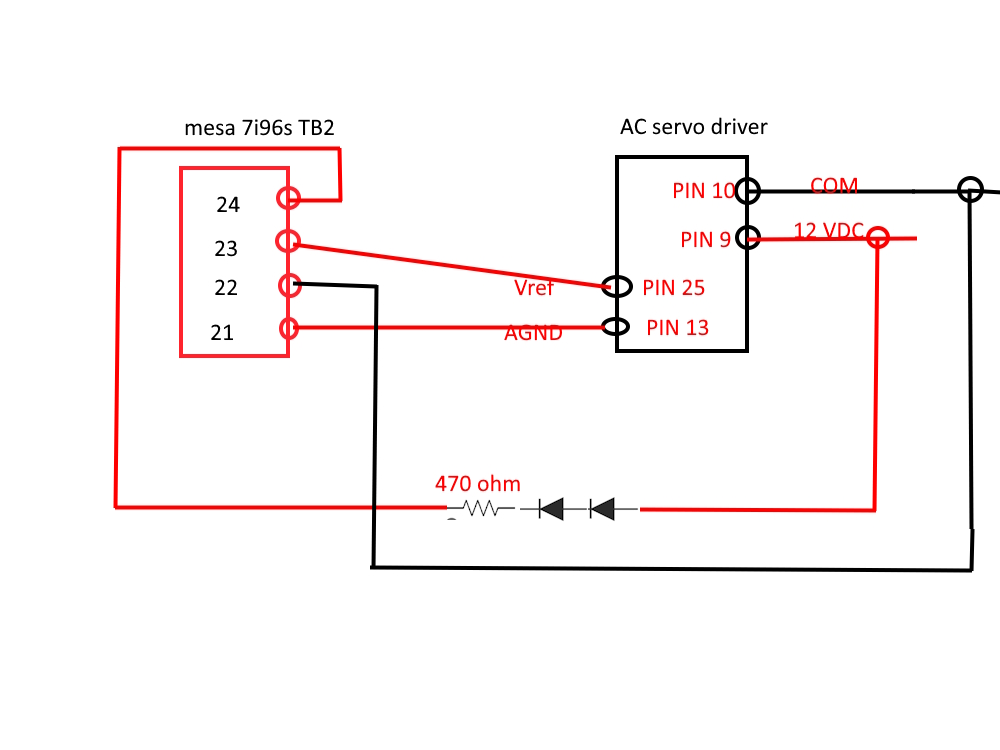

I ran the servo motor in speed mode with potentio-meter. It ran fine.

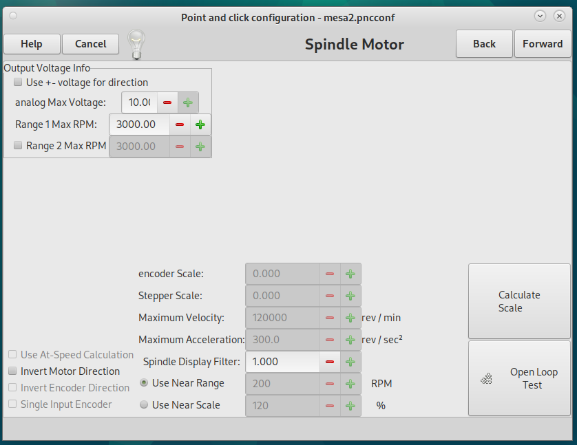

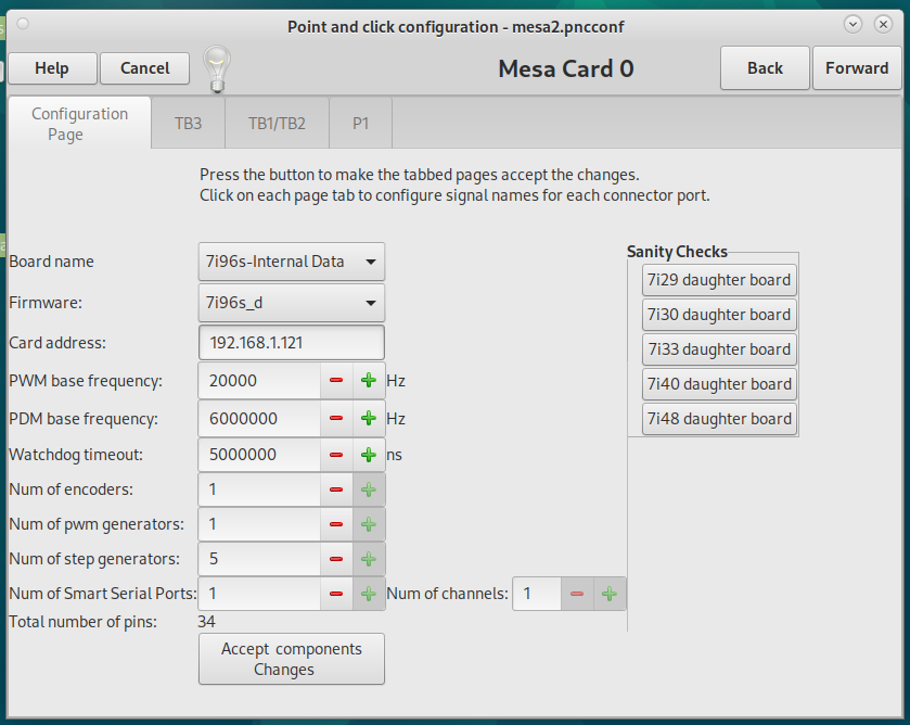

but when I connected the servo driver to the mesa 7i96s, and configured the machine via pcconf wizard, I could not get the servo to run. The servo is running at low rpm but not responding to the axis spindle user interface. No voltage detected across pin 21 and 23 of the mesa TB2
The x,y,z stepper motors running fine via jogging in axis interface.
Not interrested at this time in bi-directional operation.
below find the pcconfig relevant pages, I will also include in a second post the connection diagram and spindle driver manual

I found the mistake
pin 21 on the mesa should be no connection
and the agrnd in the driver should be connected to ground
working like a charm, I just need to replace the resistor with slightly smaller like .3 kohms. I started with slightly larger resistor to avoid getting more than 10vdc to the motor driver
sorry for such non-adding value posts. it is uncharted road for me.
