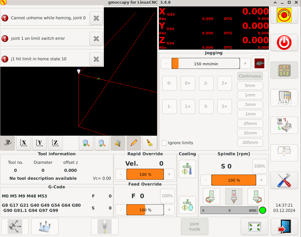

I try to get two tandem motor to work. But the moment one side hits the home/limit switch I get the error Cannot unhome while homing, joint 0. So to me it looks like he tries to unhome joint 1 while he still tries to home joint 0
And another question can I somehow let the motors move away from the limit/home switches once they are in a fail state. Because they are tandem I can't just use ignore limits option

In the ini file, joint 1 section
HOME_IGNORE_LIMITS = NO
should be
HOME_IGNORE_LIMITS = YES
should be

That worked at least now I get
Home switch active before start of latch move
I saw somewhere else this could be because of bouncing homeswitch. Mine are real simple switches. So that might be true

First make sure both motors on the X axis are turning in proper directions.
Make a new config with no tandem and set the X axis to both outputs, then do very small jogs to check.
