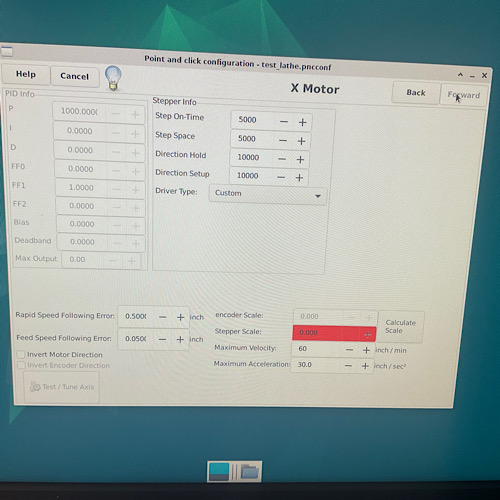

As I wait for my 7I96s to arrive I’m playing with the PcConfing trying to set it up and I keep getting stopped at this point.
im using a Rasberry pi 4
XY lathe
Gmoccapy
7i96s -internal data
Firmware 7i96s_7i74

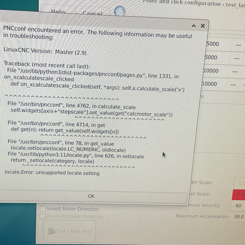

When I go to apply the stepper config I get this error.
what am I entering wrong or missing?
XY lathe
Gmoccapy
Firmware 7i96s_7i74

I think that's a locale bug on pncconf:

Assuming you are using the linuxcnc rpi 4 image, on the command line, try typing menu-config and selecting the correct locale for your part of the world

once I learned how to set the local correctly it worked. lol
