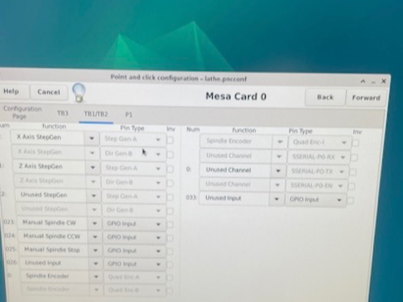

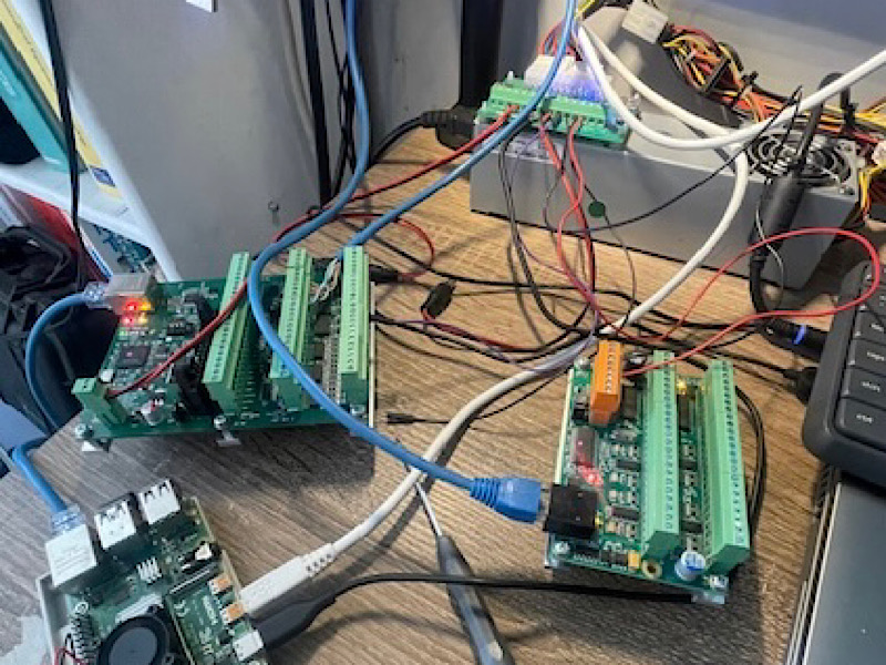

I have my 7i84 working. Green light and in can see it in machine config in Axis. Disregard the red light old picture.
Is it suppose to show up when I setup the boards in PC Config?
How do I name the inputs and outputs?

In pncconf select the desired 7i84 option from the sserial setup menu:

Thanks that worked
