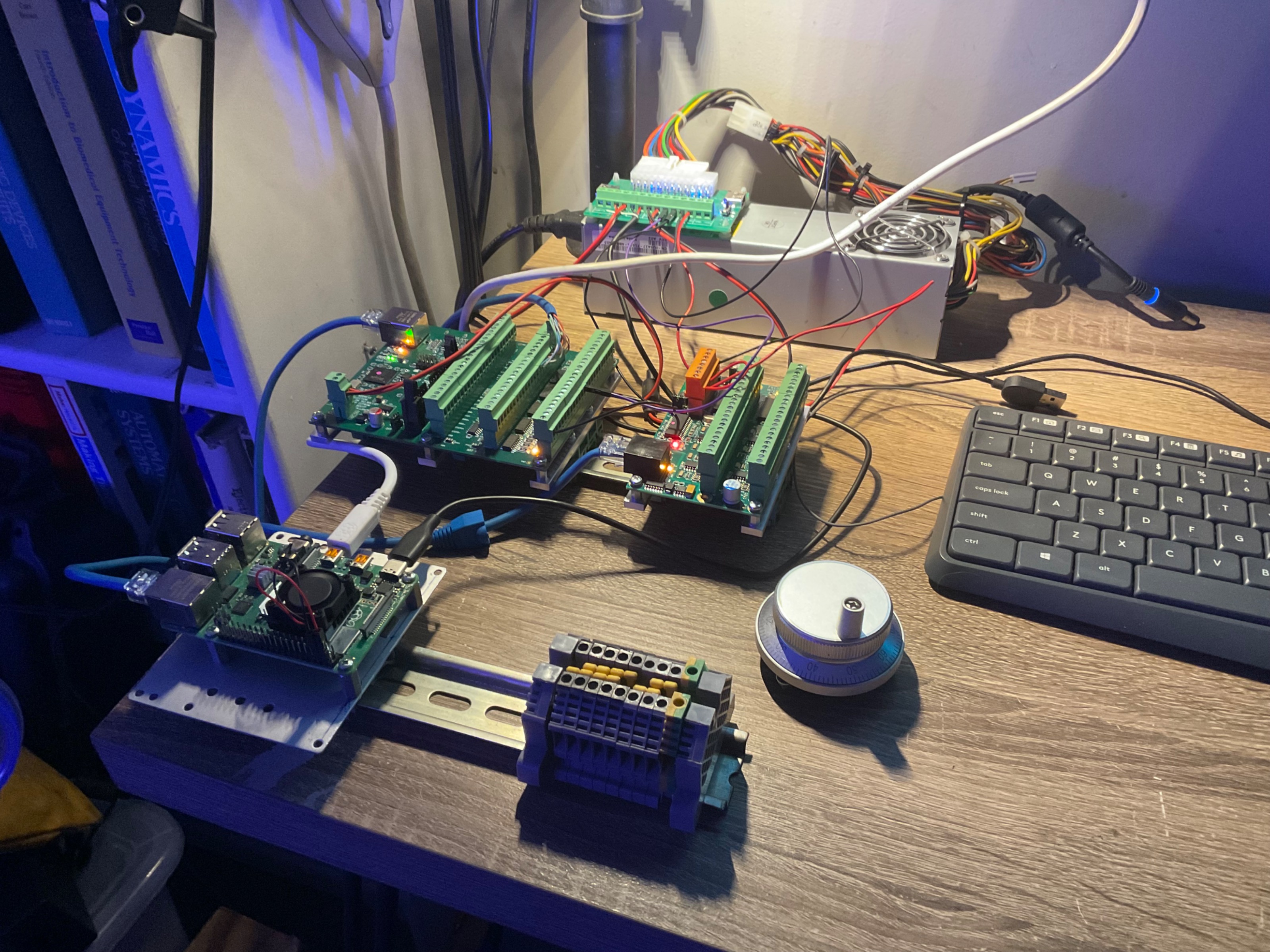

7i84 MPG input settings was created by Jdolecki

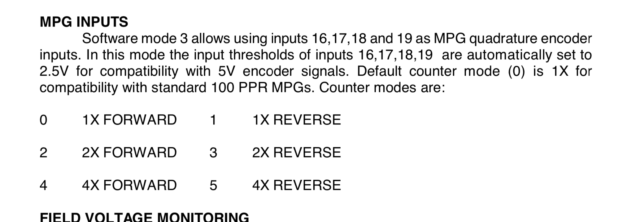

22 Feb 2025 23:55 #322322
Replied by PCW on topic 7i84 MPG input settings
The default is 1X forward which should work for most MPGs

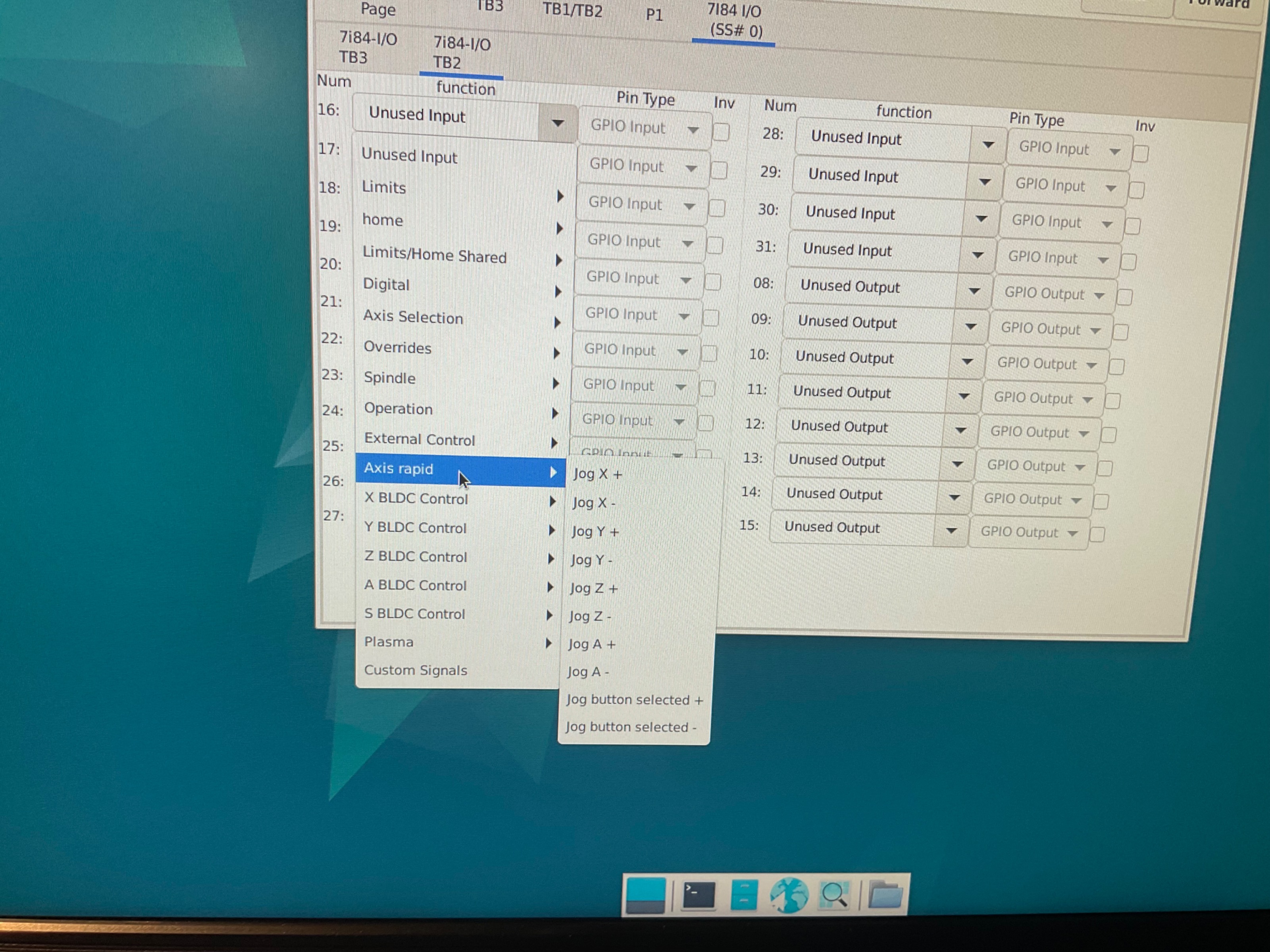

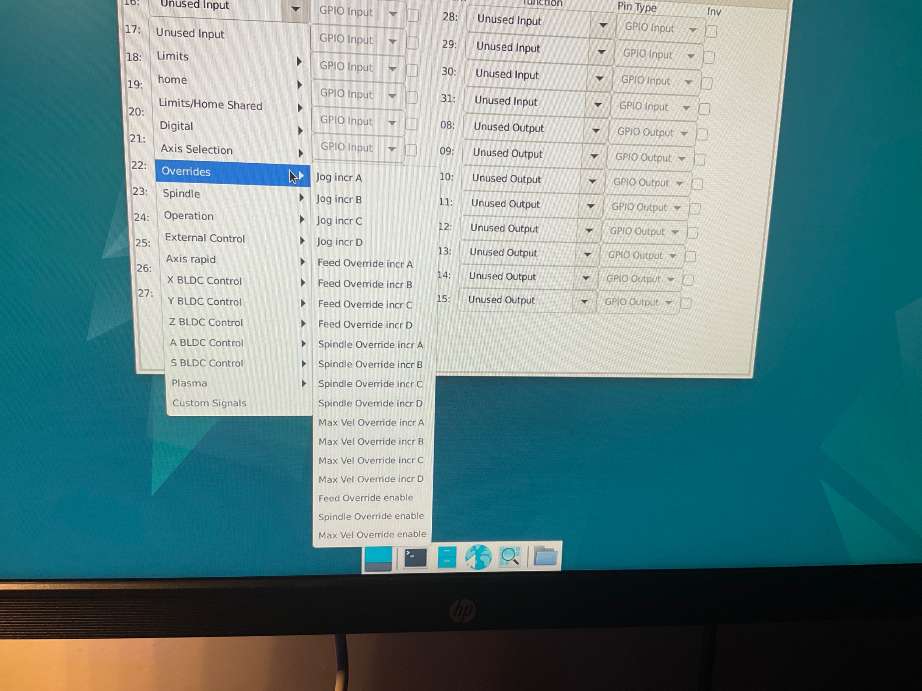

23 Feb 2025 21:28 #322406
by Jdolecki
Replied by Jdolecki on topic 7i84 MPG input settings
What do I set the input to?
I don’t see anything that say mpg input.
The count would be something like:
hm2_7i96s.0.7i84.0.0.enc0.count
