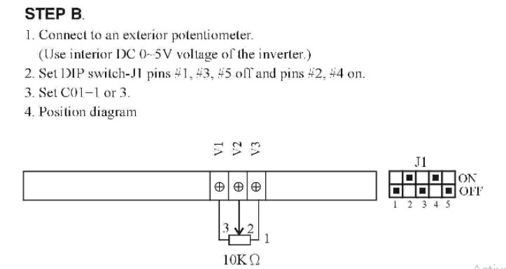

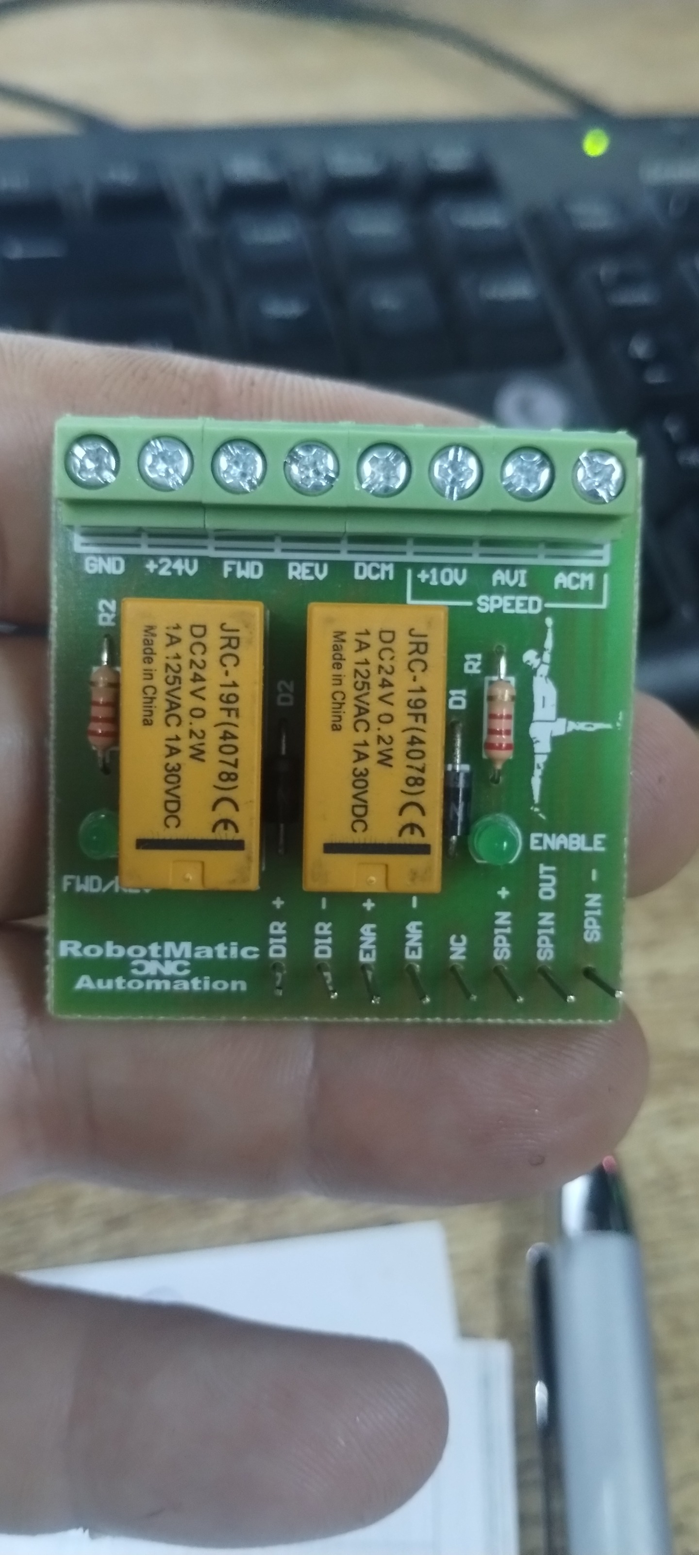

There is no tension on pins (1-2) (1-3) of the TB4
That means no Spindle output is possible.
The 7I76/7I76E/7I76EU do not supply the 10V.
The spindle output on these cards works as a
potentiometer. Typically the 10V is supplied by
the VFD.
the VFD.

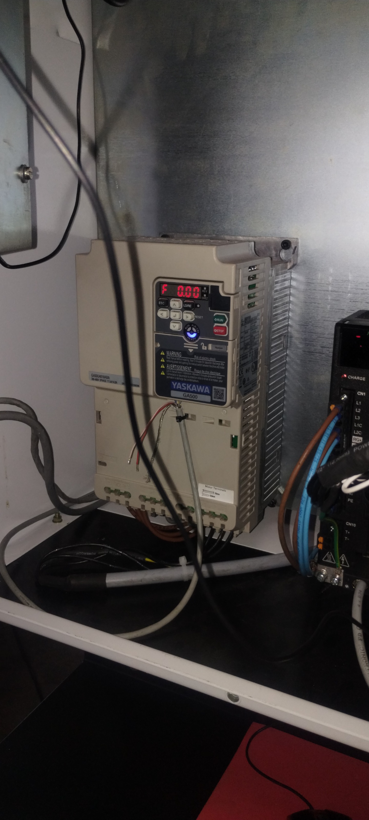

Thank you all for the responses. The VFD GA500 is already installed in the machine and I don’t have it here. I have an LS600 on my work desk which I am using for the tests. I will try to send you the information you are requesting as soon as possible.
PCW !. Thank you for coming back! From the heart!
I advance the board that I am using in the TB4 connector, I believe, as PCW explains, that I am not supplying the 10vcc. I am going to check the LS600.

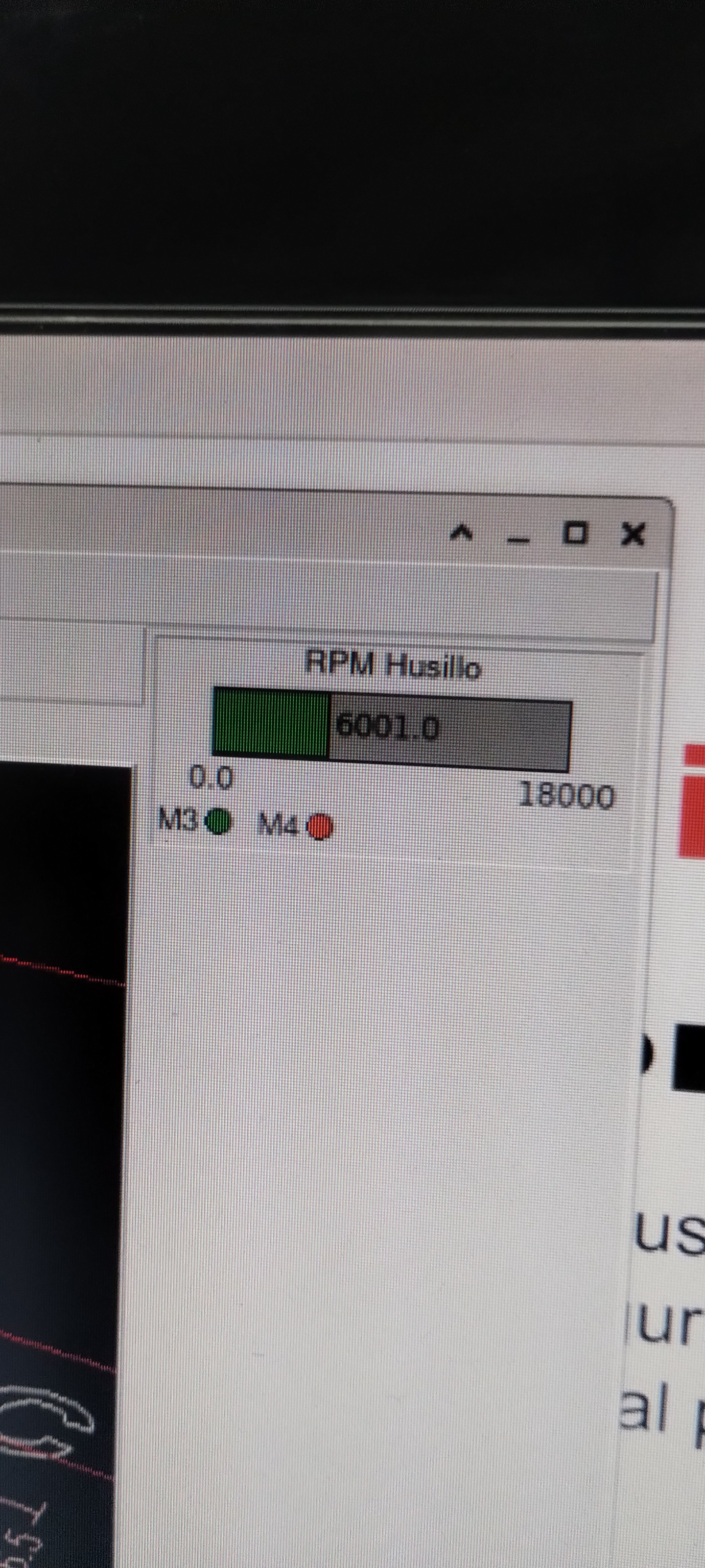

PncConf works in Live!!!!! it was the language !!!!!!!!!! I am very happy!!!! thank you!!!!!!!!

It works!!!! The VFD was not sending the voltage!!!.PCW ,Tommyligth,unknowm !!! thank you very much from the heart!!!He learned a great lesson today!! it works !!

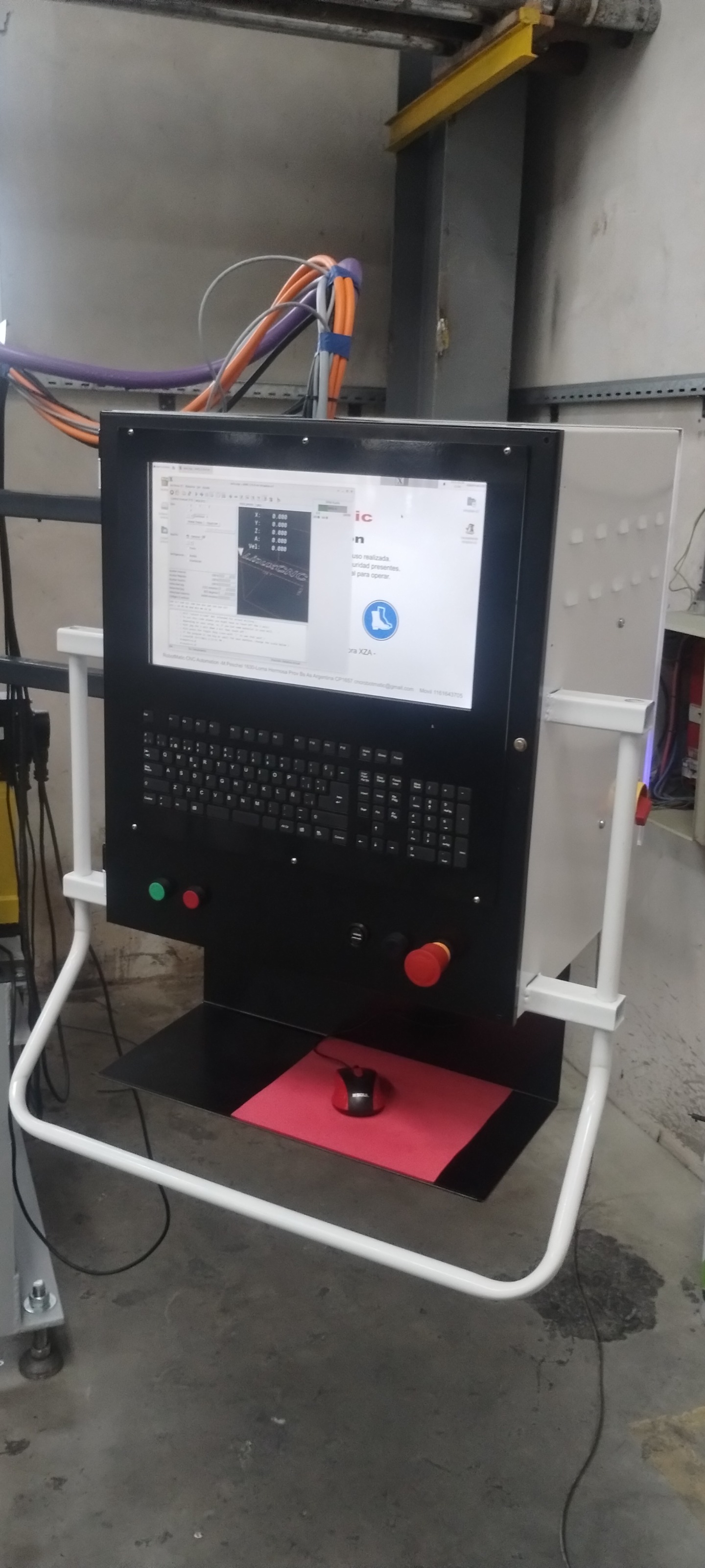

Why is your DVM on the floor ???

19 Sep 2025 12:30 #335187
by RobotMatic
Replied by RobotMatic on topic 7i76E Spindle configuration

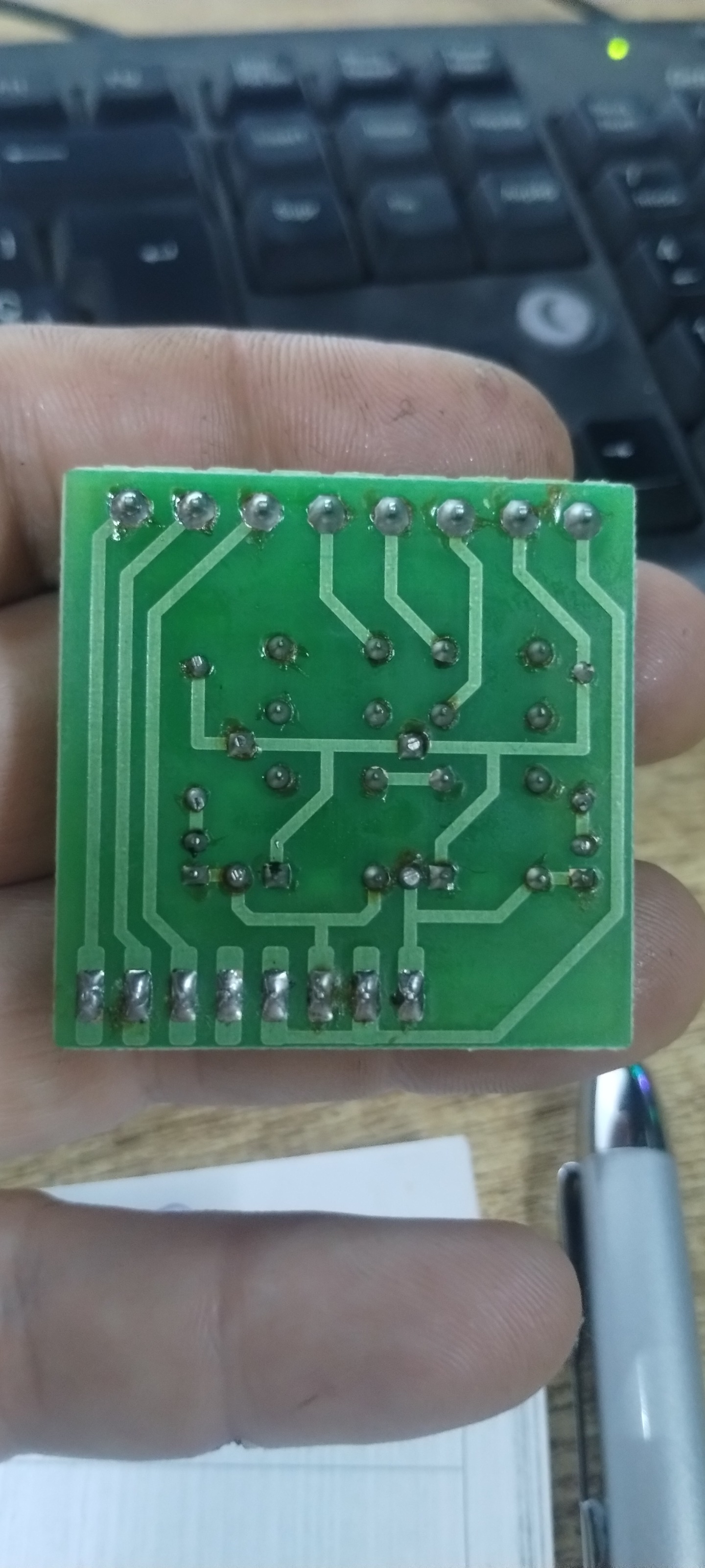

20 Sep 2025 00:18 #335203
by RobotMatic

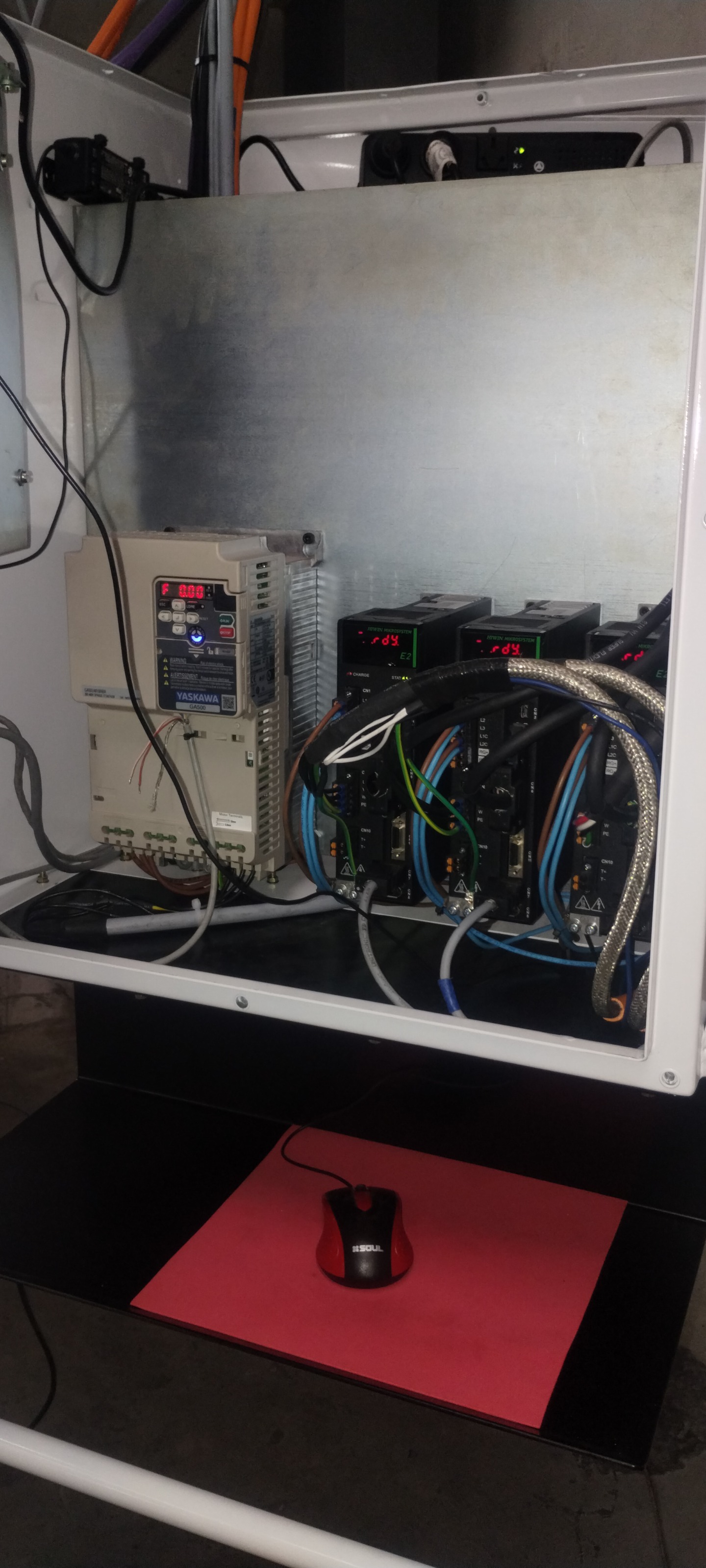

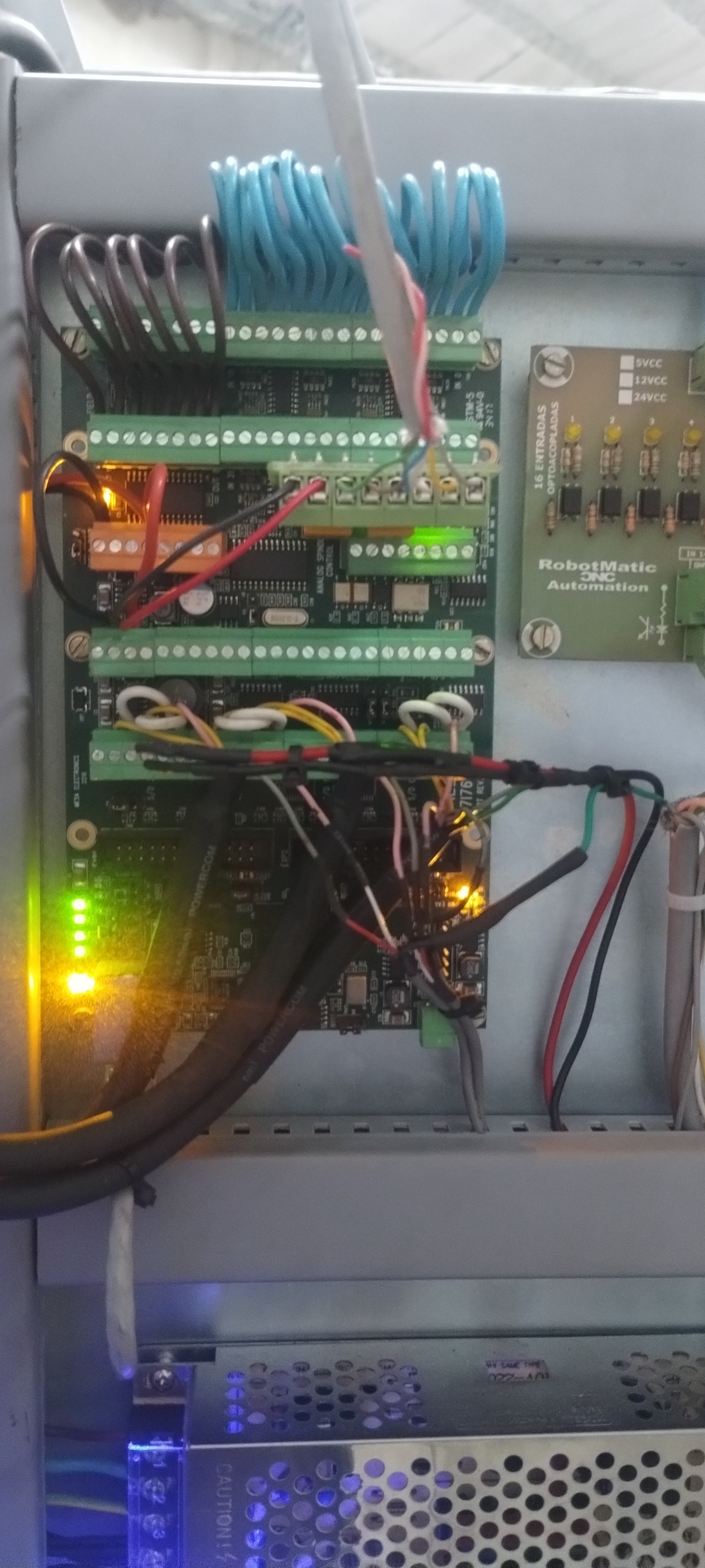

I'm a bit concerned about the STEP/DIR wiring.
It appears that the thick white wires are grounding the STEP- and DIR- pins
This should never be done as it shorts out the STEP- and DIR- pins
possible damaging the driver chip.
If STEP- / DIR- are unused, they should be left unconnected.

I am going to check the connection, I should have connected TB2 pin 2-4 with the white wires [ Pulse - ] [ Dir - ] from the Driver.
the pink cable from the X connector seems to enter pin 2, I need to check!!
thank you very much for the observation !!!!!!!!!!
