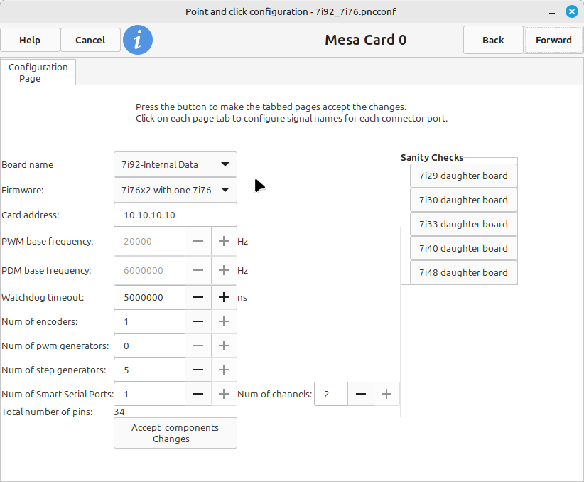

So I find out 3 different Linuxcnc o.s later that I should just settle with 2.9.4 because the cards were new versions “2025” mesa boards…. 2weeks of wrestling with a combination of ip address, firmware,software, etc I’m at a complete stalemate. Really wish I would have just went the g540 route, I was able to flash the firmware. Same firmware I downloaded off of mesas site 7i92tm software. Onto a usb drive loaded onto desktop move the file over to desktop it’s already unzipped so I go in and tell the terminal which combo I have “ 7i92tm_7i76u. I believe the file ends with x1pd.bin? If I’m not mistaken. Anyways, Wrestled with the flash “spelling “ supposedly for about 3 days. Finally got it flashed. Now when I go in pncconf in the pin config setup/card discovery picks up a combo of “7i92 internal data”no tm” next box down shows the combo 7i92 with 7i76. Kool! But in the pinout only the tb4 tb5 tb6 terminals show. 7i76u “2025” step dir goes on tb2 and tb3, only it’s like they don’t exist and now im thinking about just being a chef

The 7I76u uses normal 7i92t_7i76 firmware so 7i92t_7i76x1pd.bin
Then select  7i92-internal Data and 7i76x2 with one 7i76:

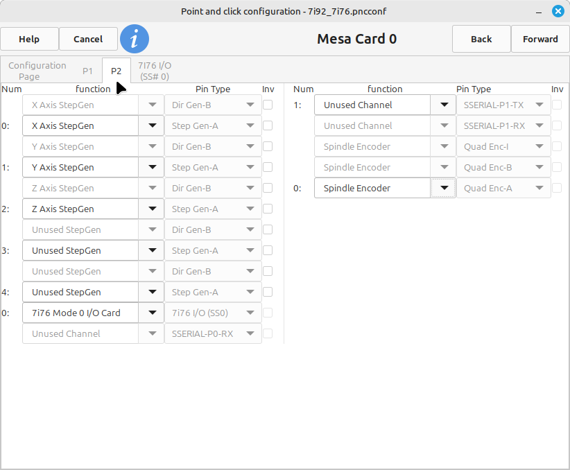

The stepgens are selected from the P2 tab:
