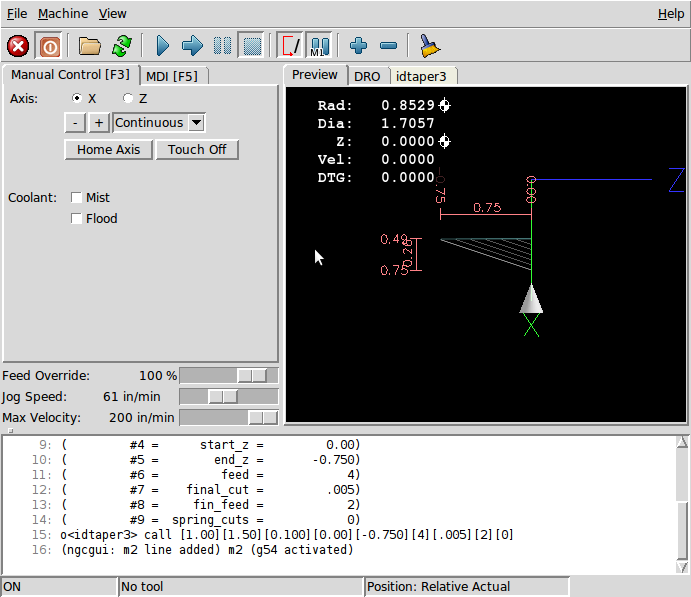

Here is an updated id taper sub for the lathe.
It works when you have an existing hole and you want to taper to a larger diameter and know the final diameter and the depth.
It uses a different method to calculate each pass to avoid excess Z air cutting movements.
Again not tested yet, only on a sim.

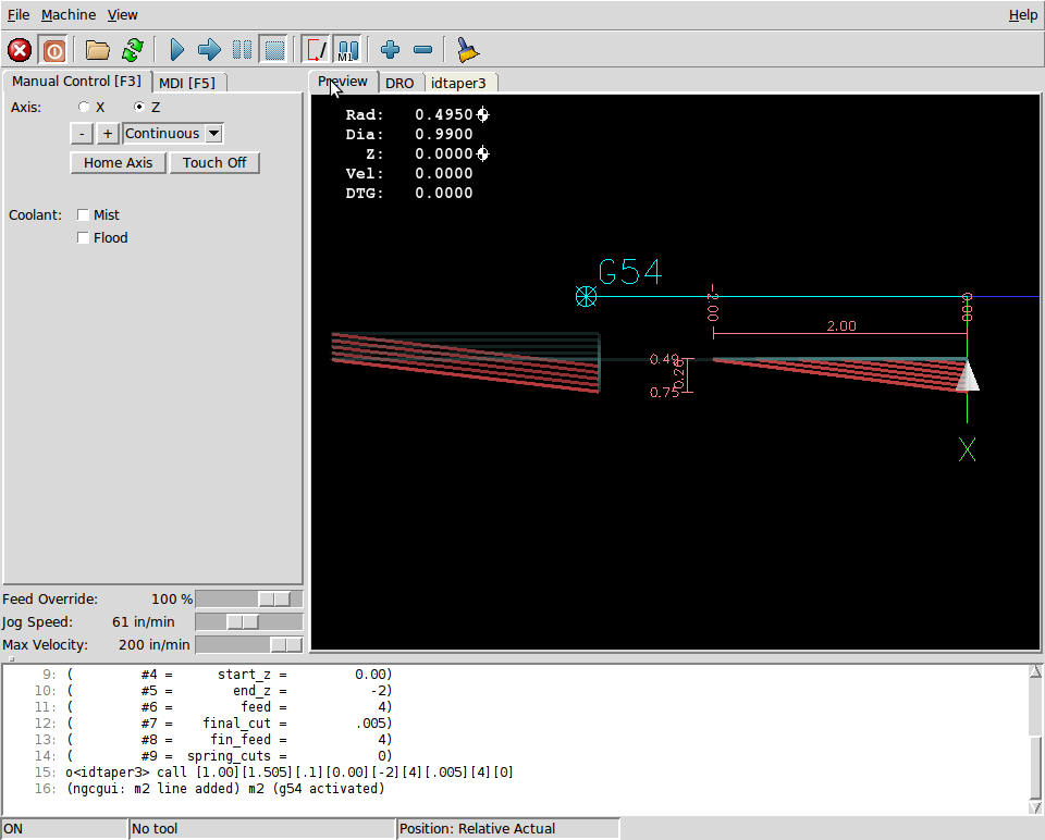

In this case I was working on a custom throttle body bore that needed a taper, I had the small diameter, the length and the large diameter.
What I wanted to avoid was excess Z moves cutting air part of the moves.
Below is a screen shot of two examples, on the left is the way I was cutting with full Z moves, on the right the newer sub.
The left took about 3 1/4 minutes the right 2 1/4 minutes at the same F4 cutting speed.
I can see the benefit and advantage of having different subs for tapers, ones that accept dimensions and ones that accept angles.
