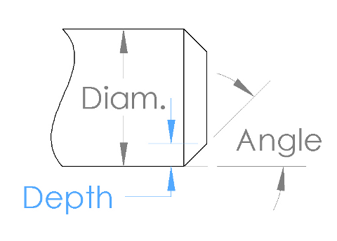

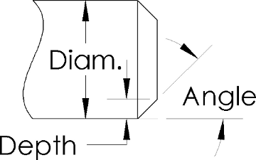

I finally got around to fixing my lathe taper OD so it would have proper angle and depth of cut. Make sure you name the file taper-od.ngc. If you copy the image to the same directory as the subroutine the image will show up in your tab.

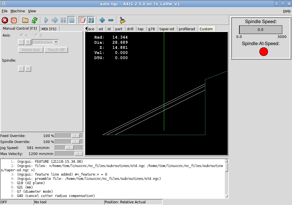

I've recently got NGCGUI going on my lathe, using John's subs as a starting point (thanks John).
The behaviour of the original taper OD sub was not what I wanted for 2 reasons:
1) Cutter rad comp is a step beyond me at the moment
2) My machine has backlash, so needs some run in and out of the taper cut
I set something up to behave as I wanted (see attached screenshot). You specify a "run-in/out" value to start the cut beyond the end of the workpiece (Z), and the cut continues until clearing the diameter by the same run in/out value.
The problem I have is the angle. This screenshot was programmed as a 45 degree chamfer, and you can see that's not what is output (closer to 35 degrees). The rest of the program behaves as expected. I suspect the problem is something to do with the TAN function (and my maths). Before I post up the code (my first foray into subroutine programming), is there anything special I should know about the trig functions in LinuxCNC that could give this type of error? Degrees/Radians, etc?

If you don't use cutter compensation on any move that is not parallel to an axis you won't get the part as it is programmed.
linuxcnc.org/docs/html/lathe/lathe-user.html#_tool_path
All the trig functions are here and nothing special about them.
linuxcnc.org/docs/html/gcode/overview.ht...nary-Operation-Value

I'm planning to add cutter comp back in when I understand what is happening. The angle shouldn't change.
I've attached the GCode, with all my maths. The basic concept is:
Start of cut: Z is always <face-z> + <runinout>
End of cut: X is always <diameter> + <runinout>
The tricky part (for me at least - I've spent hours debugging this) is calculating X for the start of the cut, and Z for the end of the cut.
I'll upload a sketch in a minute to show how I arrived at the trig...

The angle will as programmed but the location will be off by the distance from the cutter edge to a point defined by perpendicular lines tangent to the X and Z edge of the cutter. Wow what a mouthful, now I sound like a programmer...

G1 X#<diameter> Z[#<z-start> - [#<current-depth> * TAN[90 - #<angle>]]]John
