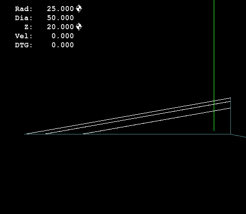

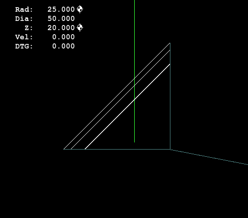

You won't get the angle exactly _where_ you wanted it, but the actual angle should be correct.
Forgetting about diameter mode will give you a 26.6 degree angle.
Replied by andypugh on topic Lathe Taper OD
If you don't use cutter compensation on any move that is not parallel to an axis you won't get the part as it is programmed.

Andy, I think you may have hit the nail on the head! Measuring it on my screen makes it look very close to 27 degrees.
That's cheered me up, now I just need to get home and dot some *2s around...
You wouldn't believe how much time I wasted this weekend trying to troubleshoot that!
Thanks again, I'll post the finished sub when it's corrected and working...

Andy, you were exactly right. I added *2 to 3 locations and that has solved the problem.
I'm posting my subroutine just in case anyone wants to use it. Many thanks for the help!
