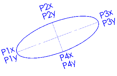

Several times I read of people asking for a true ellipse.
This routine does that with endmill compensation. A positive endmill size will contour the outside and a negative will contour the inside.
I only spent about two hours writing this code, so please test and use at your own risk.
