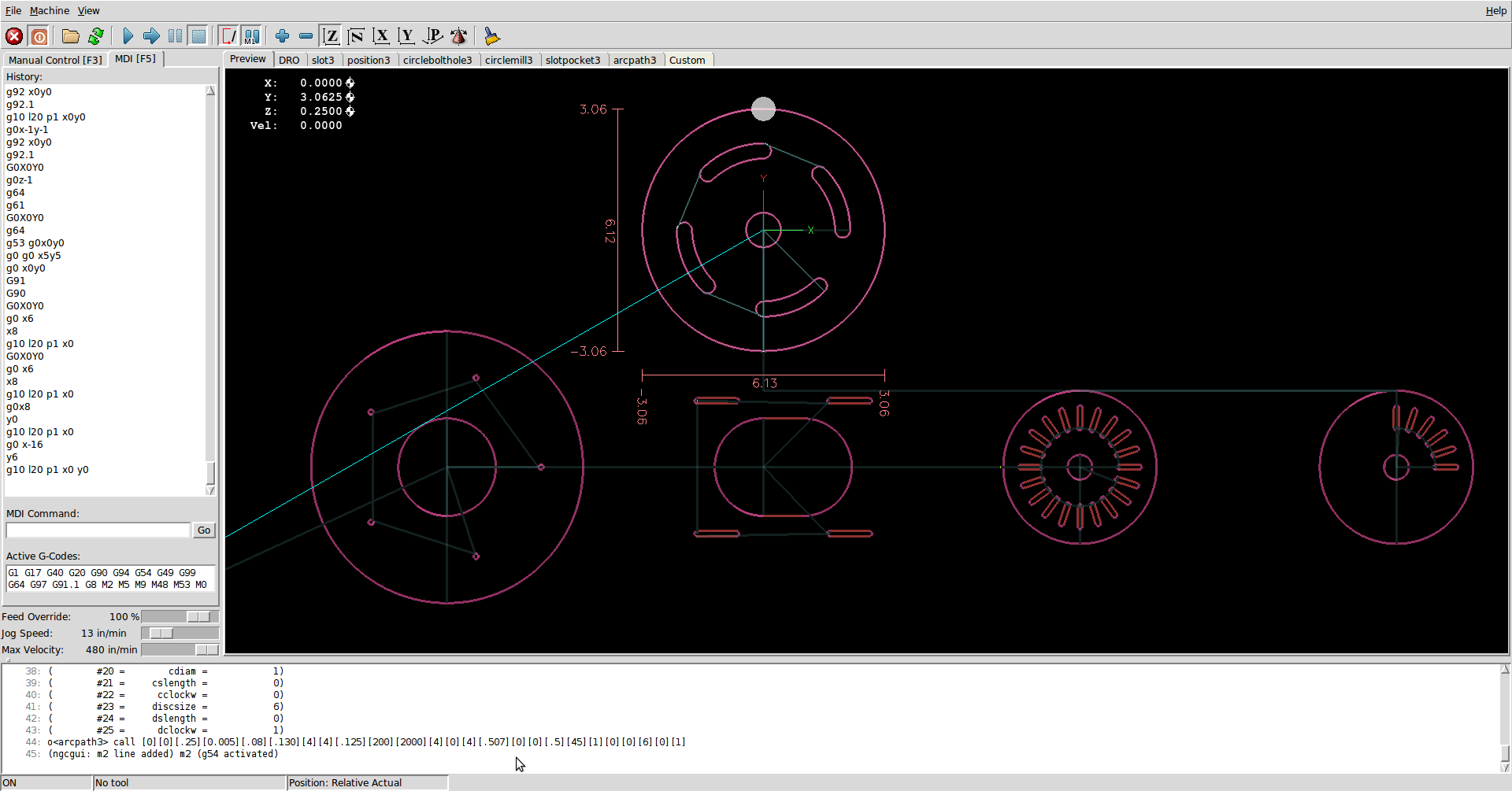

On the lathe almost everything we do now. ID, OD, ID taper, OD taper, facing and profile cutting.
On the mill, facing, slots, grooves, circles, pockets, duplicating a part several times on one piece of stock, finding the center or edge of a part, finding and duplicating a drill pattern.
We use a somewhat complicated combination of subs to produce wheel spacers, adjustable nema motor mounts etc. With an inside hole, a drill or hole circular pattern and an outside pattern as attached below.

I got a kick out of writing these subroutines.
The radial slot is one I haven't thought of, yet I see it quite useful.
If I get the inspiration (i.e. I get really really bored), I might give writing that one a try.
