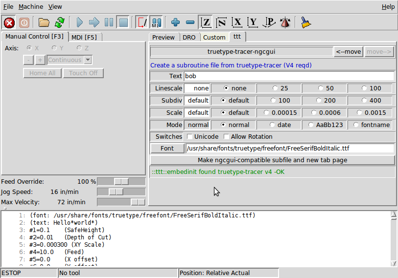

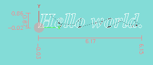

I have ttt tab in my ngcgui-1 as shown in the attached figure. It says to make a ttt sub. In a terminal I typed truetype_tracer and a gcode file was listed to machine a "Hello Wold" sign using open type and I saved it as I g code file. Sign is shown in attachment 2.
I searched the DB but could not find a ttt sub. So how do I make a ttt sub?
I want to use the ttt sub to generate g code to make signs and engravings.

On your first attachment on the text line you have "bob" That is where you can add the text.
Then look further down under font you will see a long button marked...
Make ngcgui - compatible sub file and new tab
Click on it.

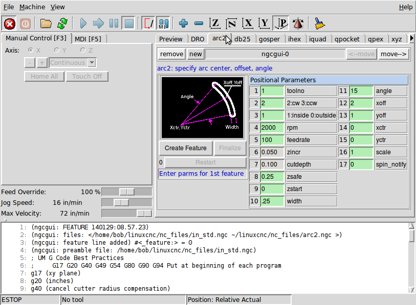

After hitting the long button a new tab will appear, similar to other tabs, look for the autosend and deselect it, you will then be prompted for a file name.
This allows you to save a file rather than send it directly to linuxcnc
Look at the...
noauto - no auto send (makeFile, then manually send)
Option in ngcgui

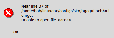

After saving a single arc2 I then tried to open the file in preview. It give me an error which I attached. I also attached the arc-t3.ngc g code file and my ini. Do you see how to solve this error?

You might have saved the file in a directory that is not in the ngcgui search path.
Take a look at...
Section 3. Libraries
In the link above. And try saving your file in one of the directories or add the directory that you want to use to the path.
Pay attention to
LinuxCNC and ngcgui use the first file found when searching directories in a search path. With this behavior, you can supersede an ngcgui_lib subfile by placing a subfile with an identical name in a directory that is found earlier in the path search. More information can be found in the INI chapter of the Integrators Manual.

"Near line 37of
/home/bob/linuxcnc/configs/sim/ngcgui-bob/auto.ngc:
Unable to open file <arc2>"
The ini file contains:
[RS274NGC]
PARAMETER_FILE = sim.var
SUBROUTINE_PATH = ~/linuxcnc/nc_files:~/linuxcnc/nc_files/ngcgui_lib:~/linuxcnc/nc_files/ngcgui_lib/utilitysubs
USER_M_PATH = ~/linuxcnc/nc_files/ngcgui_lib/mfiles
so it looks like it should work except tilde (~) expansion in ini files
is not available in linuxcnc 2.5.x.
If you are using linuxcnc2.5.x, try using:
SUBROUTINE_PATH = /home/your_user_name/linuxcnc/nc_files:/home/your_user_name/linuxcnc/nc_files/ngcgui_lib:/home/your_user_name/linuxcnc/nc_files/ngcgui_lib/utilitysubs
USER_M_PATH = /home/your_user_name/linuxcnc/nc_files/ngcgui_lib/mfiles
Tilde expansion in ini files was added to git master by commits like:
git.linuxcnc.org/gitweb?p=linuxcnc.git;a...839c0f5ec575ef1064bc
