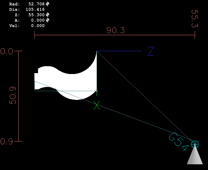

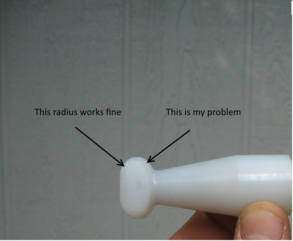

I'm using the radius sub from the library that John put in there but I need a cw radius for a bobbin type end. I've included a picture to avoid confusion. I've looked at the code and so far have not been able to figure out what to change to get this to work. Does anyone have a canned file that they are already using to do this? I've tried changing G2 to G3 is the sub, it cuts good but then when it returns for the next pass the tool goes inside the instead the piece instead of outside. I'm sure it's something simple I'm missing due to lack of experience coding. The end where my finger is, is the end chucked in the lathe.

Looking at JTs sub, it is really for radiusing the end of a bar, not what you are trying
My metric lathe sub routines have an example file for a finial I made several of which is similar
www.linuxcnc.org/index.php/english/forum...71-g72-etc-etc#34327
You will not be able to use it directly I suspect, but it will show you the sequence of G2 and G3 cuts which result in that shape, so may assist

I ended up downloading a free version of DraftSight to draw the part and then purchased a copy of cad2gcode.com/. His videos describe the process drawing and converting polylines and converting them to cutting paths, I got what I needed and learned a thing or two.
