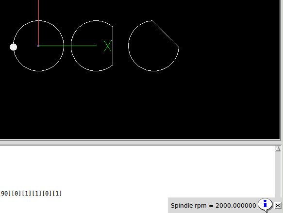

Greetings,
I was experimenting with the helix.ngc program and would like to know what the following fields are asking for.
#<faceangle> = #12 (=0 face angle)
#<d_angle> = #13 (=0 d angle)
#<spin_notify>= #15 (=0)
Is there a How-To for each of the NGCGUI programs that are packaged with LinuxCNC?
With kind regards,
Dave

The ngcgui_lib/ files are provided for teaching by example.
You may have to look at the code or experiment.
For example, the screenshot below shows three helix.ngc invocations
using:
left: x center= 0, d_angle = 0, face angle = 0
middle: x center= 1, d_angle = 90, face angle = 0
right: x center= 2, d_angle = 90, face angle = 45
So the d_angle is the angle of the chord and the face angle
is the rotation angle for the chord.
The spin_notify boolean optionally invokes another subroutine
(utilitysubs/spin.ngc) which by default displays the spindle rpm as a
(debug,) message (lower right). The spin.ngc routine could be
overridden by a like-named routine in [RS274NGC]SUBROUTINE_PATH for other
purposes.
