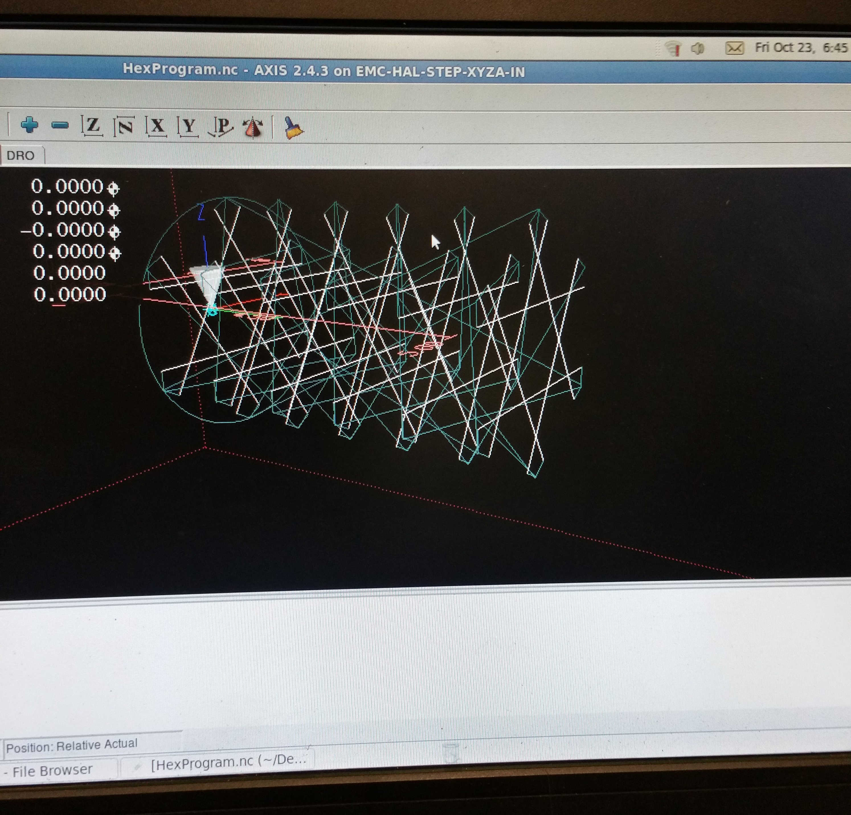

I have been trying to make a program where the operator only needs to change the Hex Length and Distance across the flats to machine a hex edm electrode.
The program graphs ok, but will not run.
I'm sure it's something simple. If anyone could help me out it would be greatly appreciated.

How does it manifest its not-running nature?

The tool does not move on screen, nor do you see the axis locations move.
It just sits there like you see in the photo.
After trying to run the hex program all other programs have the same problem.

Well although it looks different it seems to run on the sim 9 axis.
How do you have the axis configured?
Is your tool table set up properly?

how are you machining this ? on a Lathe or mill with 4th axis
i would have expected a axis
what os are you using ? i notice your using an older 2.4.3 version , you may find this easier with the latest version
you don't have a spindle speed or m3 m5 ( start stop)

Is the feed-override at zero?
What is the value of motion.adaptive-feed, motion.feed-hold and motion.feed-inhibit ? (details of the pins: www.linuxcnc.org/docs/html/man/man9/motion.9.html )

Mill with 4 Axis
Feed-override not at zero
The spindle on/off is a manual operation M3 & M5 not needed.
Tool Table is fine
I'll check " motion.adaptive-feed, motion.feed-hold and motion.feed-inhibit "
I can run the snowflake example before I run the HexProgram, but after I've tried the HexProgram the snowflake example will not run. It just sits the same as the HexProgram.

I wonder if it is waiting for a toolchange?
If you run the snowflake, then issue a tool-change command in MDI then try again what happens?

Ran snowflake no problems
Called T1M6 from MDI then ran snoflake no problems
Ran HexProgram same problems - Graphs ok, but won't run, computer slow to respond after
Ran snowflake again after hexprogram - Graphs ok, but won't run, computer slow to respond after
Looks like it's something in my math or variable names
The attached simpler version does the same thing Graphs ok, but won't run, computer slow to respond after

G91 A60 is a 6 minute move at F10. Is it that?
